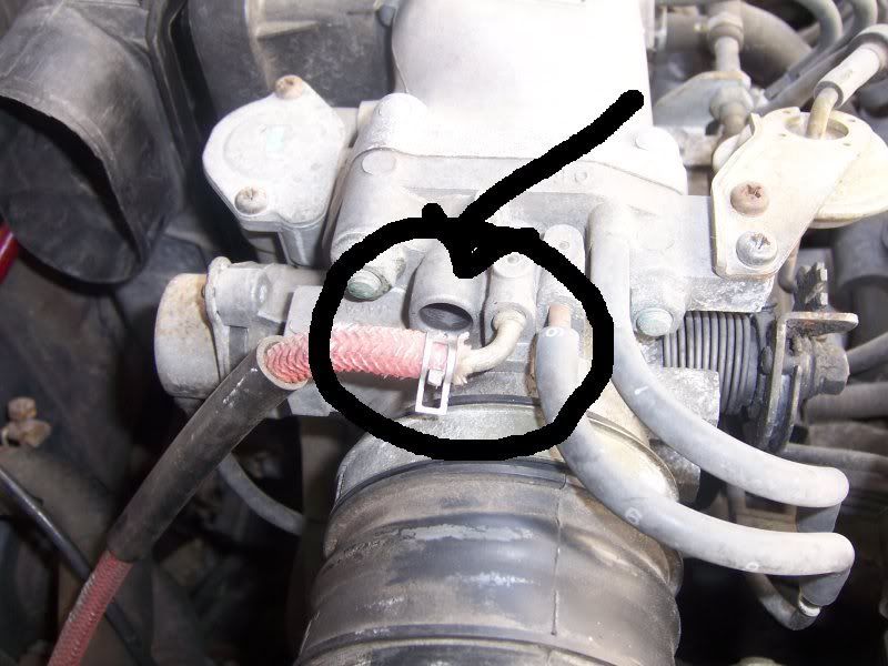

    car's idle is looopy and makes a very weird hissing sound at idle
    it will also make the hissing sound at various throttle posotions
    i have figured out where the hissing is coming from, could this also be the source of my idle woes?
    the sound is coming from that opening on the TB..when i put my thumb over it and cover it there is a bit of suction on my finger and the hissing goes away
    i started the car up from being cold (hadn't been run since i got home from work at 5am) and put my finger over it and the idle stabilized a few times then went back to being loopy
    also im low on coolant...i bought some and when the car cools down a bit im gonna put that in
    soo wtf is that hole for in the TB? is that causing my problem?
    Re: lopey idle and weird hissing sound
    your idle adjustment screw goes there
    SEi User ZackieDarko's Avatar
    1,910
    lol wtf
    i wonder where it went
    hahahahaha that must be my problem then huh?
    Quote Originally Posted by ZackieDarko
    lol wtf
    Yeah that would be it....lol
    AAAAAANY body got one of these screws laying around?
    juuuuunkyard! cost = free...
    lol thats awesome though... some people like to put stuff on the threads to keep them from backing out. for future reference
    i wonder how it got out of there...that is strange
    i'll hit some yards up this weekend....put that tax return to good use :-p
