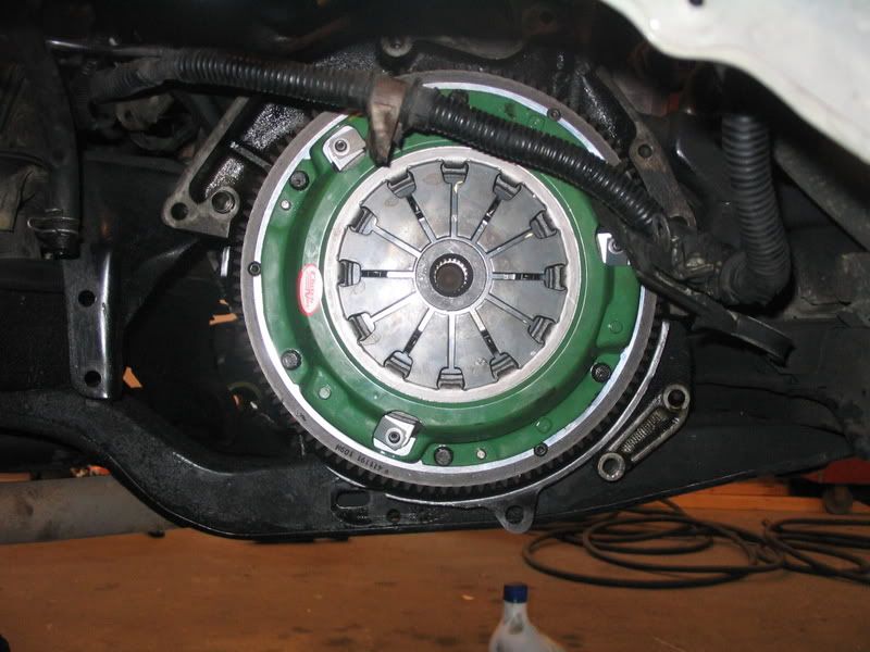

    Yeah! So I finally got the Prelude tranny installed! Never realized just how worn out and noisy my old transmission was. The car is incredibly quiet now. The new gear ratios are great! Makes the car pull much better, and keeps power on-tap when you want it. This is probably the best mod I have ever done!

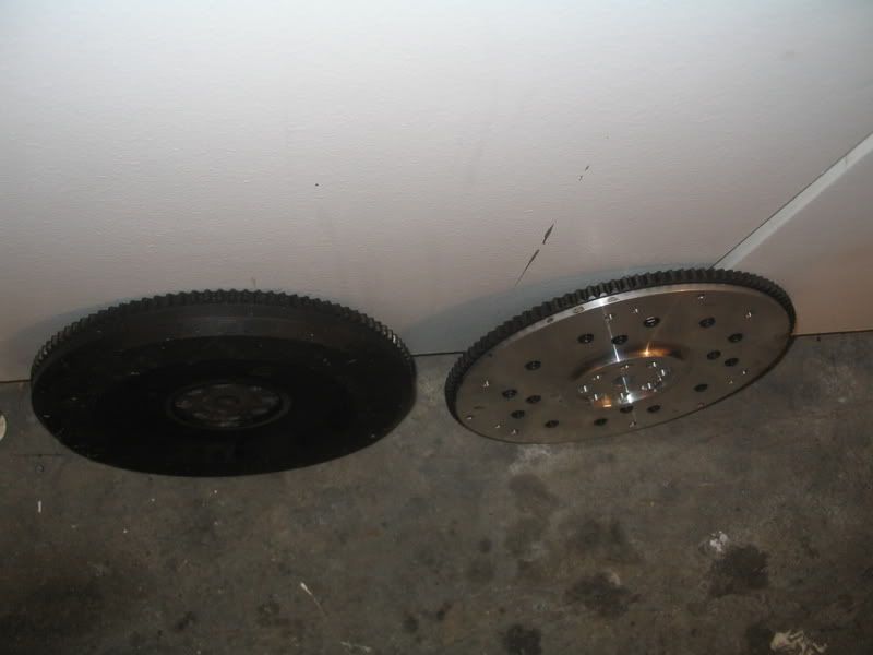

    Along with the tranny swap, I bolted in my new 9lb flywheel and ClutchNet clutch and pressure plate. Amazing stuff! I don't see why you would not want a flywheel like this in your car. As far as I can tell, the driveability is exactly the same, if not improved. I haven't had any trouble with stalling or anything like that... Shifting is sooo smooth and precise, but that could also be due to the good transmission. Also, the car revs much quicker, great for downshifting.

    And here's a few pics for fun:

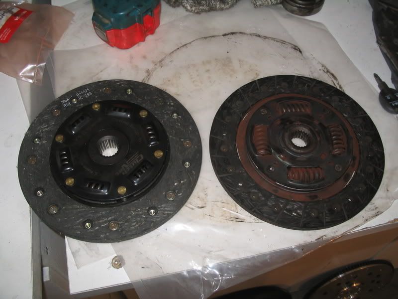

    It looks like the new clutch disk has more surface area than the original. You went with all green parts right? Hows the pedal feel and engagement? Lower gears help you cook the tires? Better shifting? You need the 2 liter!!

    i thought the flywheel is 12lbs.

    Yeah, all green parts. I figure when I get the A20 in, it will be pissed enough that I'll do some yellow, maybe red parts then. Pedal feel with this clutch setup is really smooth. I mean like butter. My old clutch had some nasty shudder.

    About the weight of the flywheel... Someone noted in another thread that they had called ClutchNet, and they told him that the website was wrong. They said the flywheel was actually 9lbs and not 12. Well, I put my flywheel on a scale, and found it to be true. It really does only weigh 9lbs. But I can't see ANY downside to it! It's awesome!

    sweet i might get that same flywheel clutch combo....and good deal on the 9 lbs fly.....the stock one is like 23 pounds thats not bad at all.

    Oh yeah. I replaced that leaky-ass mofo. I couldn't time the ignition because the old flywheel was caked in oil and grease. The timing marks were completely invisible until I pulled out the old flywheel and scrubbed it off. I transferred the timing marks to the new flywheel, ordered the rubber cap for the timing window to keep anything else out, and put a new o-ring in the dizzy (the o-ring was missing completely!). Should be a nice to get rid of all that leaky mess.

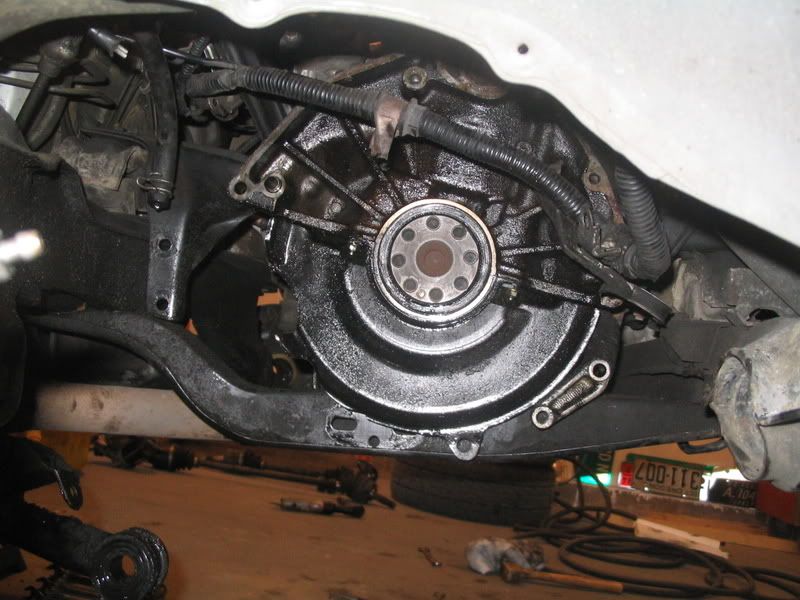

    Re: Prelude Tranny Swap Complete!
    Glad you replaced it! I could see it leaking in the picture and I just hoped you replaced that thing while everything was apart. It's a bitch to replace when everything is reassembled.

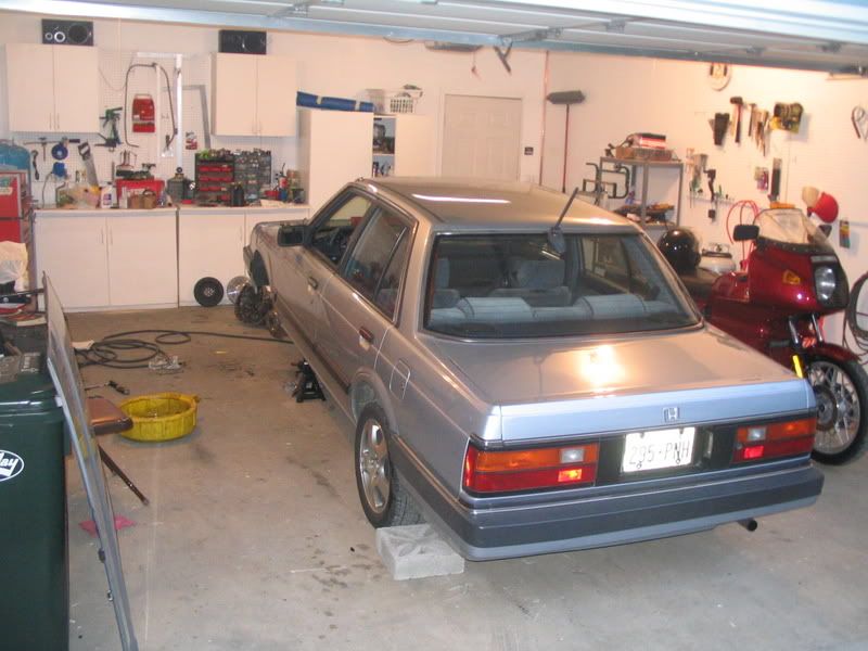

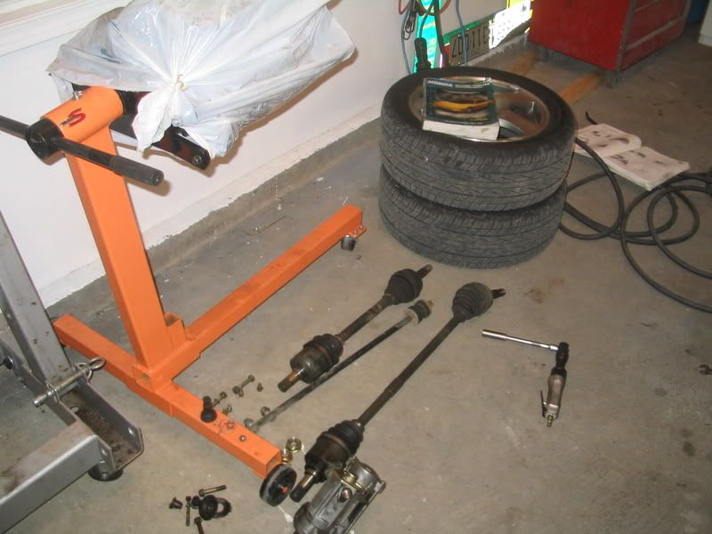

    It was done all in a weekend. Didn't work on it Friday, just Saturday morning about 10:00am til about 8:00pm at night, then Sunday for about 3 more hours. The most challenging part is finding all the bolts. They're tucked away and hidden really well.
    I tried to order the Honda-specific tool that was listed for the job; the flywheel ring gear holder. It's that guy that bolts onto the block and keeps the flywheel from spinning while you're unbolting the pressure plate and flywheel bolts. They, of course, discontinued that and don't have it anymore.
    Since the crank pulley on the other side of the engine has no holes in it to put a screwdriver through, I had to find a way to hold the motor. I actually wound up putting a screwdriver through the water pump pulley when I was unbolting and bolting on the pressure plate to hold everything.

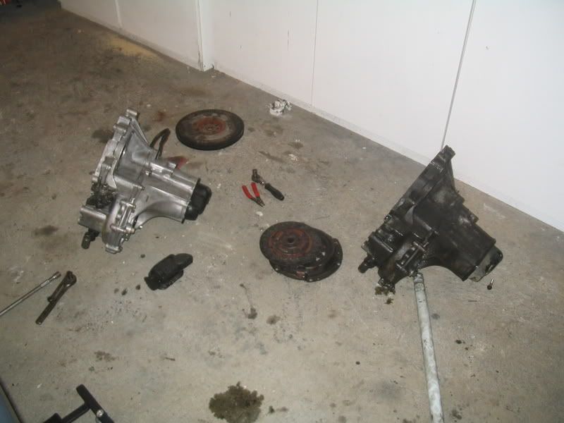

    I didn't mention where I got the tranny. I actually picked it up salvage from Craigslist. I met some kids dad at his night-shift job at like 11:00 at night. Got it for $100 with the handshake guarantee that it was in good working order. Of course, I still took it to a shop to have it looked over. They disassembeled it and gave it the okay. Completely resealed it (with RTV though and not gaskets to my dismay) installed all new seals gave it back with a good bill of health. It was expensive as hell just to have it looked at, but was good peace of mind that it wasn't going to throw a shaft or be noisy like the old tranny was. I think it's in better condition than the Accord tranny was when I bought it 6 or 7 years ago.
