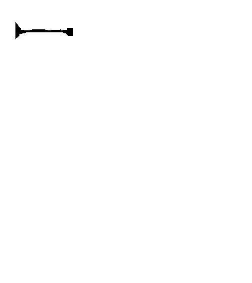

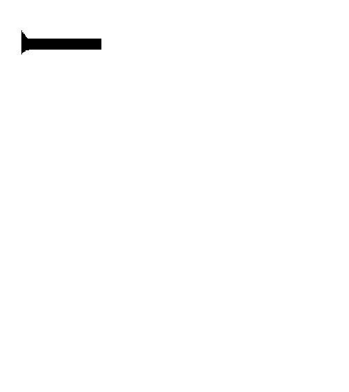

    i searched lightly and i don't know if anyone has posted this before, when it comes to aftermarket valves. What shape are they cause i want to ask if a valve could be milled down in the center of the shaft and then the metal can be return at the ends allowing more flow around the valve stem itself.
    I got this from playing paintball since 2002.
    here so VERY BAD paint pictures i just drew up of my idea.

    its do able but what kinda strength are u gona be left with

    That's what is called valve "waisting". Meaning the valves have a waist put on them. See this picture:
    http://www.v8tuner.co.uk/products/large/pic547.jpg
    A decent machine shop should be able to do it but for an A20 engine this would be probably one of the last few mods to squeek out that extra bit of HP. To make this even worthwhile you would already have to have done most of the other typical headwork kinds of things, including conversion to bigger valves. And it would only matter on a NA engine.

    matter on a NA engine exactly what i want, but how durable would these be???

    yeah they would have to be balanced since you dont want to find a valve in your piston after you rev it to 7k

    You have a problem doing this because you loose the support of the valve guide and possibly the valve seal. You would need to look at the geometry of the valve and guide / seal design before attempting this

    You would only turn down the part outside the valve guide. And I'm not sure if stock valves are strong enough for this or not. This is a question for Rich or a reputable machine shop that does this kind of work.
