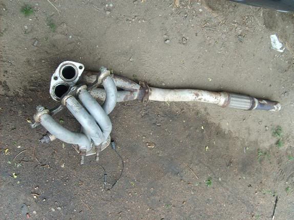

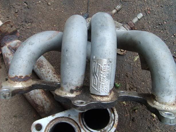

    k i came across a DC header. im trying to talk to this guy for 80 shipped. need a second opinion on the condition of the header and if its authentic thanks a bunch
    if the only thing this thing needs is a good scrub im buying

    it dosnt look that bad for 80 bucks get it before some one else dose

    That looks right, though there will be no air suction fitting for you.

    Yeah you get to remove the air suction system for sure, and don't your carb'd cars only have 1 O2 sensor? You'll either have to remove them both completely completely, or maybe just deal with whatever weirdness of the O2 sensor only reading 2 cylinders might bring. Or have it welded in further back.
    Also, good luck finding those gaskets. No parts stores in town where I live carry them, and I ordered OEM downpipe gaskets, and they still wouldn't fit for me. I dunno if I ordered the right ones or not, but I picked up some Toyota gaskets and modified them to fit.
    Oh yeah, and that's going to take more than scrubbing. Try mediablasting and recoating. If you just scrub it off, it will look the same in a few weeks. Even if you paint it, the paint will burn off. Especially on the rusty areas...
    But for $80, some work, and recoating, it won't be all that bad. It will be nice to have the header.

    Oh yeah, looks like you'll need to have the flange for the cat welded back on too. Any exhaust shop should be able to do it. They can cut the one off of the stock downpipe and use it.

    It's authintic but it's missing a flange to bolt to the cat.
    I dunno how long that header is going to last if you don't clean it good and recoat, but nice find. $80 is a bit much with all that rust and a missing flange, I would have got it for $50 tops but that depends how much shipping is too.
