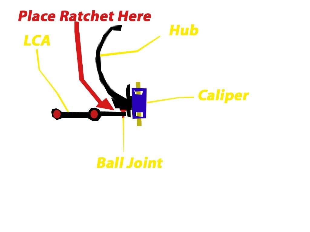

    I always place the handle of my ratchet between the lower control arm and the hub, then I stick a hand jack on the bottom of the ball joint/lower control arm. I raise the jack until the ratchet is stuck in place. Sometimes they separate at this point without having to do anything else. If they don't, I take a hammer and slam the end of the ratchet down. Its hard to explain without seeing it, but I will post up some pics when I get off work.

    Alright this is the best I can do.
    Jack the car up.
    Take the wheel off.
    Place the end of the ratchet (or something that is similar in size) in between the LCA and the HUB.
    Place a hand-jack under the ball joint and begin to jack up the hand-jack.
    If the ball joint doesnt separate at this point then you can try hammering down(towards the ground) on the ratchet.
    Jack the car up.
    Take the wheel off.
    [IG]http://img.photobucket.com/albums/v667/Legend_Master/cb9d8ef8.jpg[/IMG]

    stuck the edge of the pickle fork right in there, without grabbing the LCA bushing inside of the fork, and slammed down with a hammer. popped like a schoolgirl cherry. thanks legend master! good stuff.
