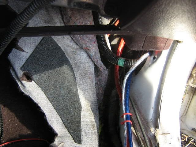

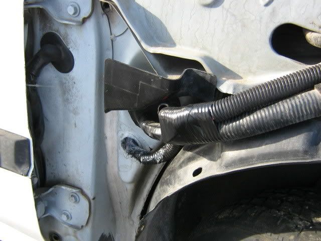

    thats were i ran mine in the sedan. the coupe i had the fender off anyway so i ran my 10 for my stereo and 8ga for my speaker amp through the factory harness and my 4ga for my sub amp through another hole below it.
    this where it comes out inside the car
