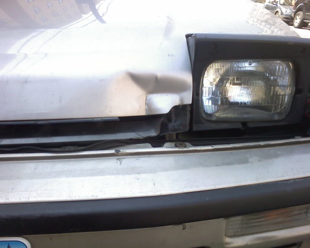

    got into a minor fender bender streets were wet, brakes are'nt up to par due to my lack of a job, and was distracted for a split second slammed into the back of Trailblazer in the trailer hitch and it pushed in the hood pretty bad right next to the left headlight only later to find out that the radiator has a small crack and it was smoking bad and almost overheated so I'll probaley part it out over this weekend anything you want is available up to and including a cylinder head.

    do you have picks of the wreckage? same exact thing happened to my CRX, and after removing the hood, bumper, and fenders i discovered the only 'real' damage was to the radiator support housing. totally fixable with enought time, money, and patience.

    not right now but it the right edge of the rad was wet and there was a visible leak, and on top of that my oil light was blinking which i have never seen.

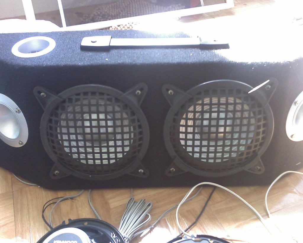

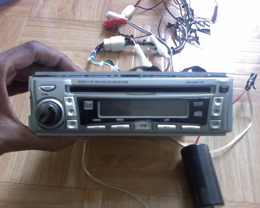

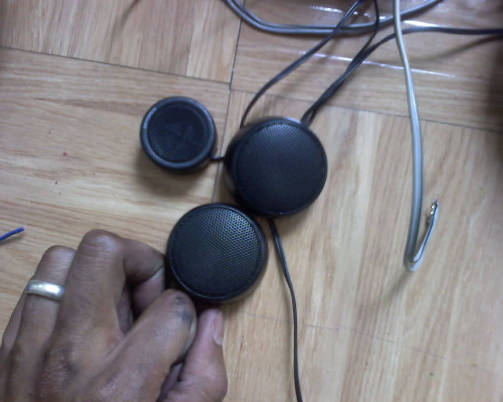

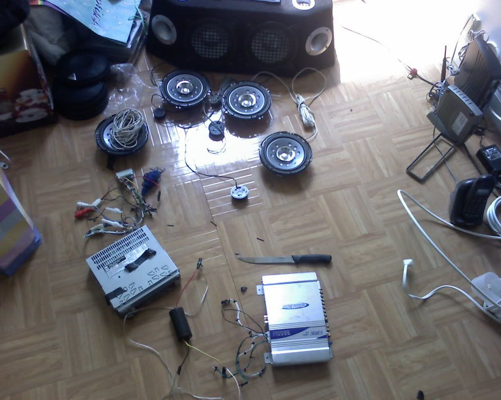

    Radio Pics For sale.
    <br>
    By the way that's
    4 Kenwood Speakers rated 160w max
    3 Old radio optimus tweeters one got crushed
    1 240w 4 channel amp
    1 Dual XD5110 am/fm 1 cd player non digi tuning
    1 300w 5.25 dual woofer box (not subs)
    1 20 Amp noise filter, I was never able to get rid of the buzz on it, but with the car off it sounds great. lol
    1 Wiring harness
    All the wires needed + extras.
    I don't know I hope to sell it as a whole but good part offers will be taken fyi i'm looking hopefully for 150 for the whole thing. I do have all the wires and the harness too.
    THanks

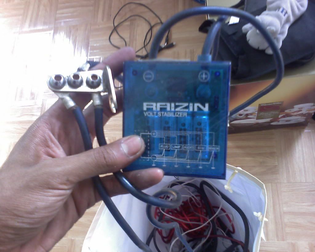

    Ebay Voltage stablizer ( it was my first mod )
    $$$30shipped make offer???

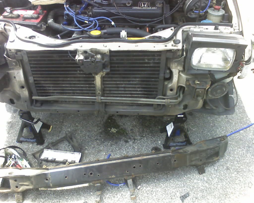

    hey question the rad is mostly full with liquid. I tried to drive around a bit engine is ok tranny still great. I can't really get an idea of where the leak is because it seems to come from everywhere, and the a/c and p/s hoses are in my way but i have 2 bottles of the readiator stop leak stuff and i'm gonna try to see what it does but it seems i should flush it out first but if i do that i will never reach the leak cause it's at the top of the radiator.
    So i guess i 'm seeking a little advice.
    thanks

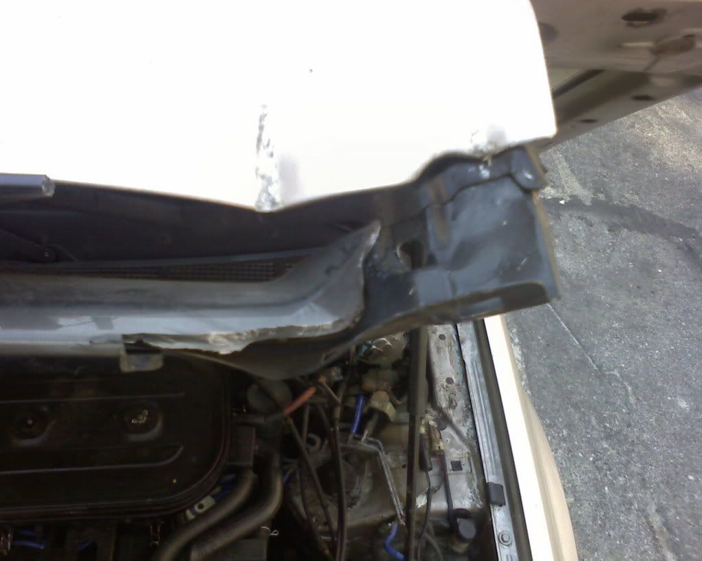

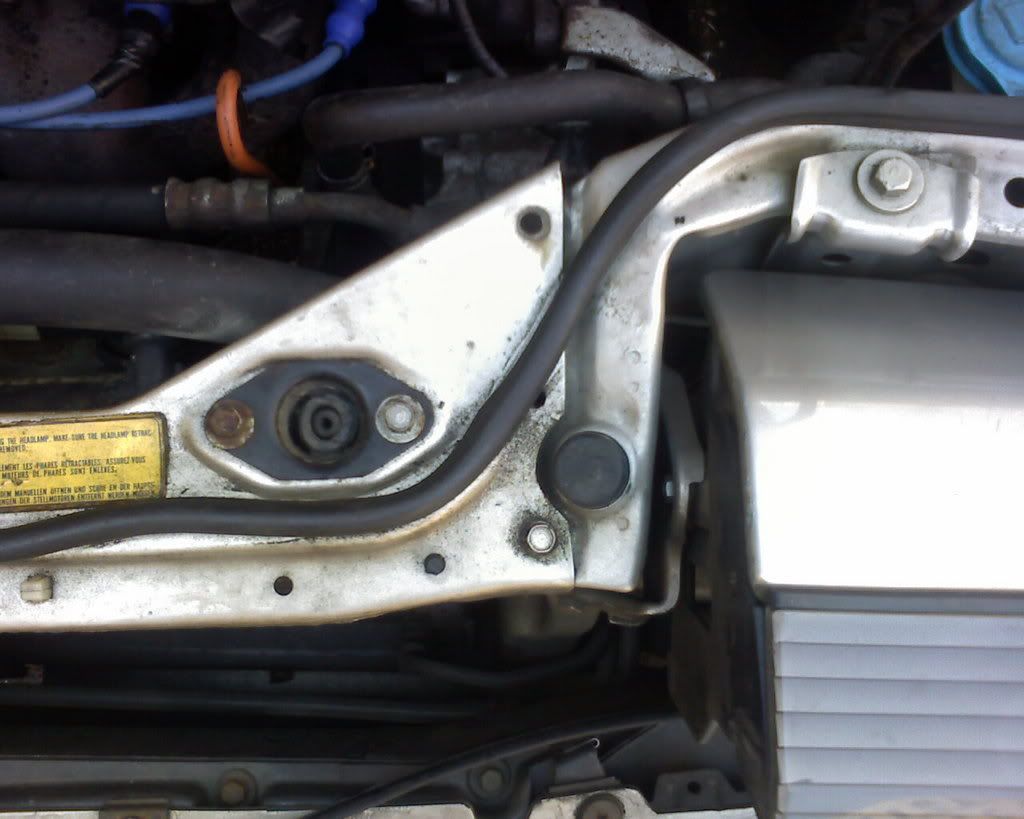

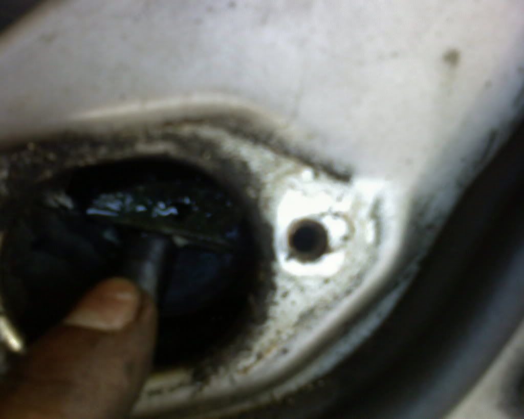

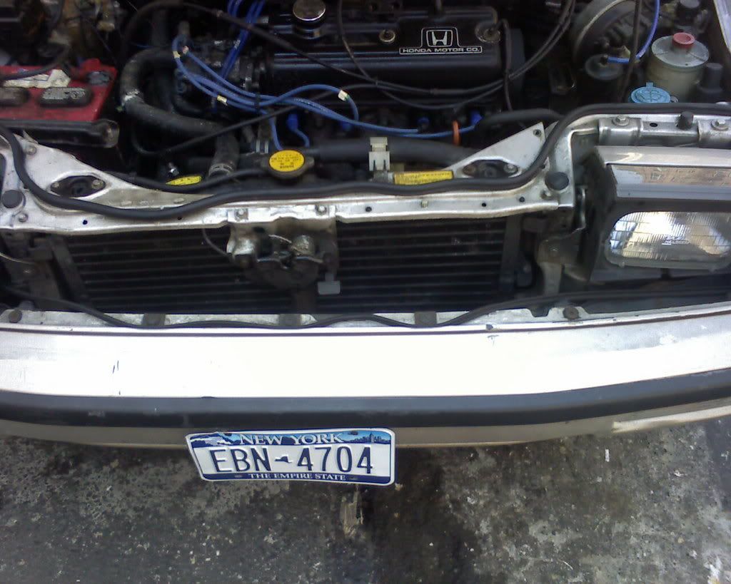

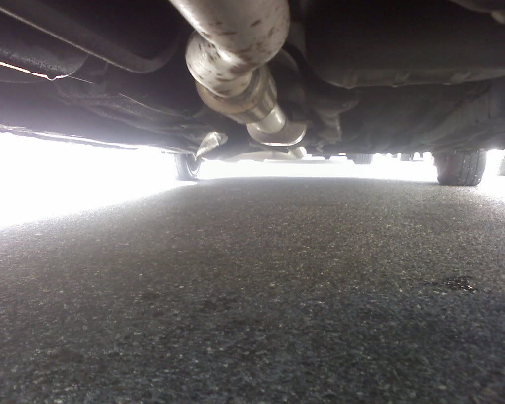

    Damage Pics
    Random Exhaust taken from under the car.
    <br>
    <br>
    The Culprit - I have put on some JB waterweld but yet it still over heats.
    and the carb is acting dumb it's hesitating/sputtering when first putting on the gas dammit

    Radiator stop leak is bad it goes all over and clogs things you don't want it to.
    JB weld the outside can work, I used what I think was a fiberglass repair kit once on my radiator and it worked for a few months. Just have to rough up the area real good with sandpaper and make sure its real dry.
    Flush and refill the system, then bleed the system to get rid of air bubbles.
    - llia
