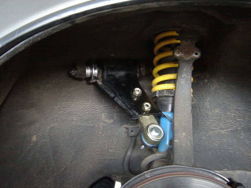

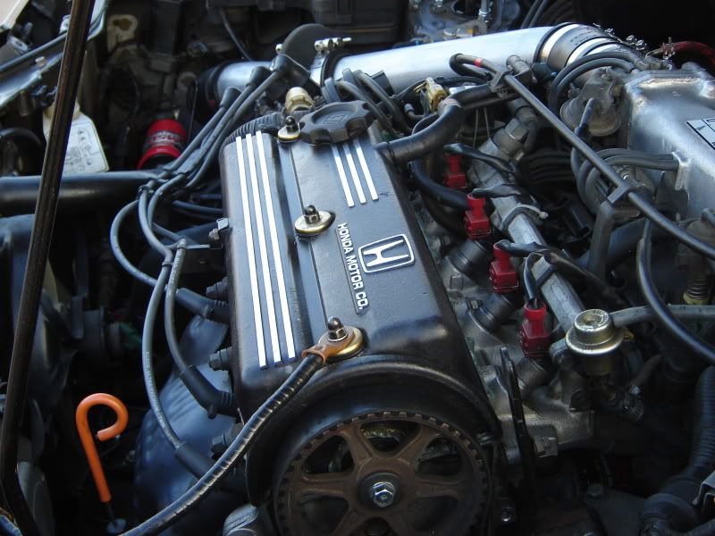

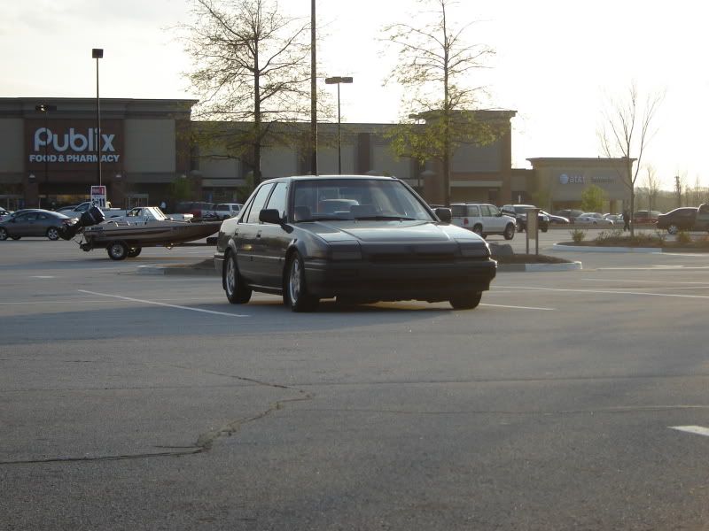

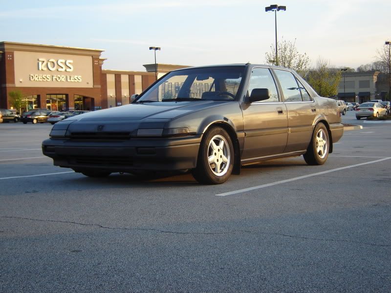

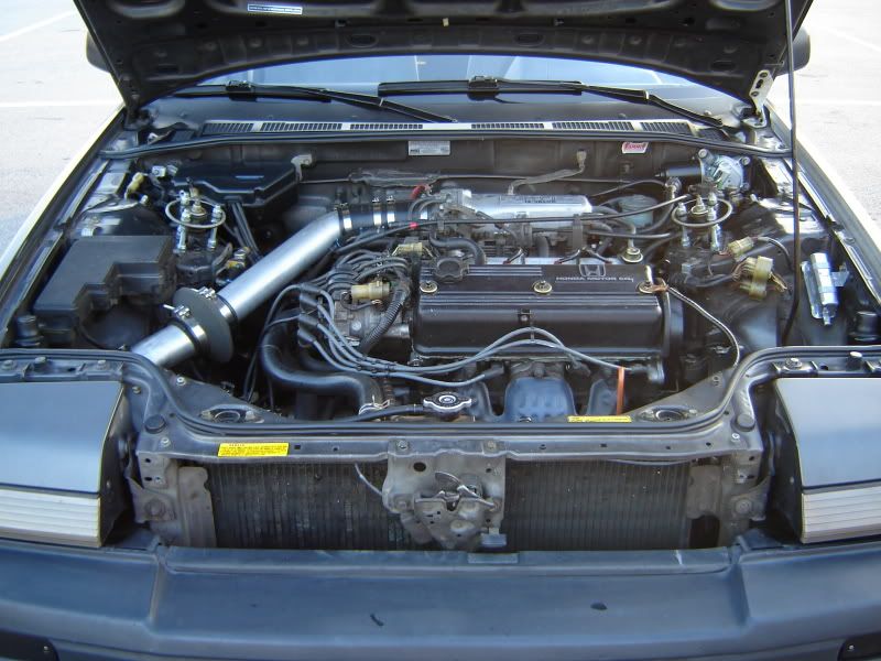

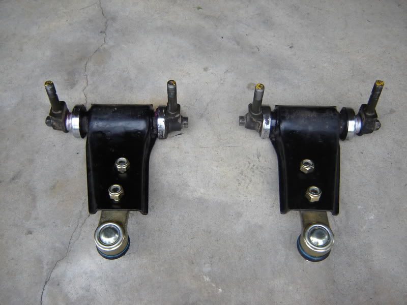

Well bitches, to commemorate my Aom im making a video soon hopefully if i can ever get a 1394 cable. In the meantime here are some pics to tide you over, also pics of my new prelude upper control arms, abnd new balljoints. New tire pics wil be up tomorrow probably.

Just to add something with the upper arms. You might want to have less washers to the back end of the car and more to the front if it is steering not to hot. I am kinda wondering where your caster is ending up.
wp
EDIT: and just to add you do have a ton of negative camber in the front. I would bet close to 10 degress negative.
Caster is in stock position like that. Reason I did it that way, was guaynabo brought up something in a thread I was reading and it said to add them to the back so that the xcaster would stay in a stock position, after I did that and checked it was perfect, and the arms are able to travel up into the control arm tunnel. If I would have had the washers even it wouldnt have been able to do so. I got a 4 wheel alignment anyway so all is good. I still have -1.5 caster on each front but thats no biggie at all, considering i had like -4 or more.

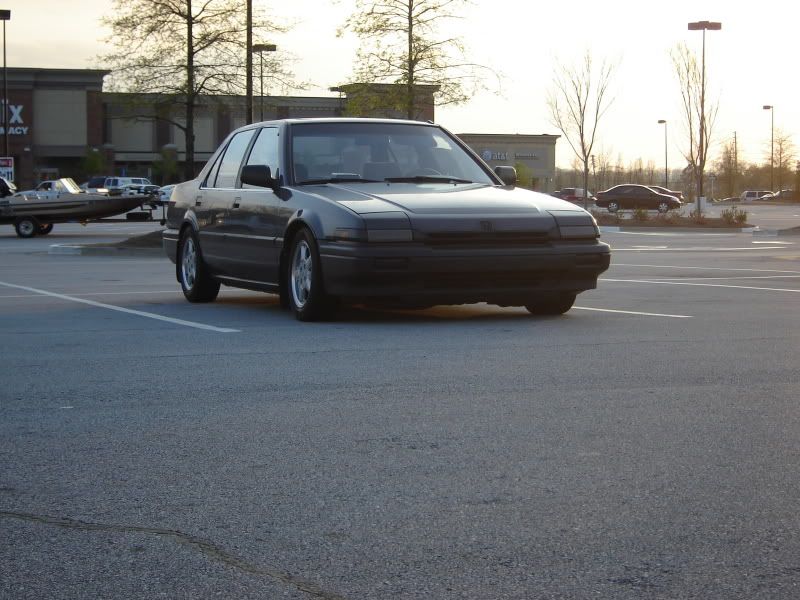

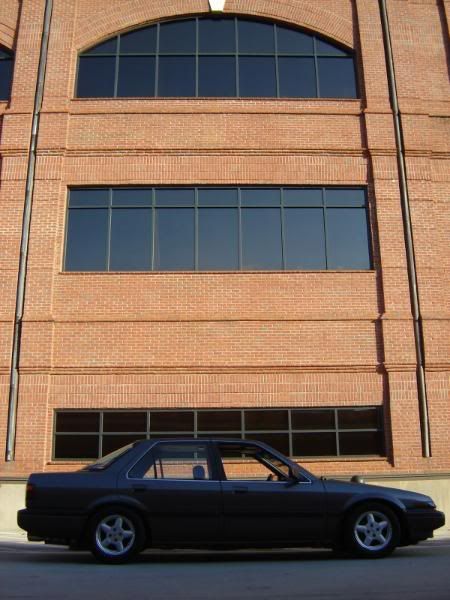

Got the new tires and a 4 wheels alignment, and I love em, theyre sexy!.
These pics arent so great but oh well.
