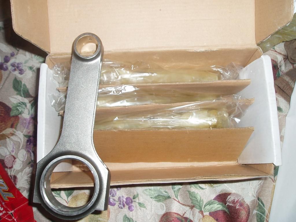

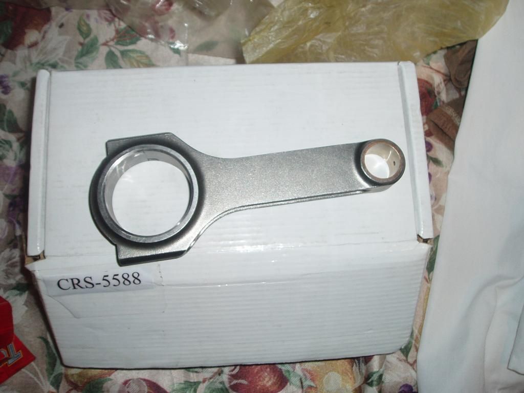

    on a good note, some h beam goodness arrived today
