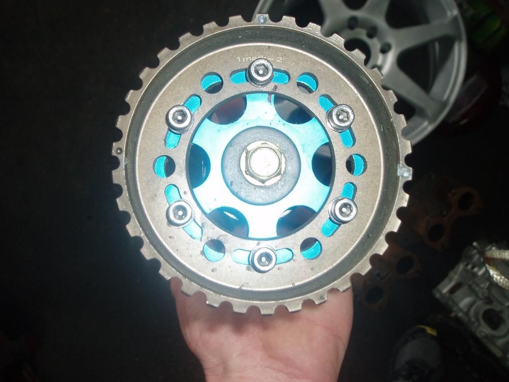

    def has skunk cam gears, kelfords have added heaps to the lobes to get the profile.

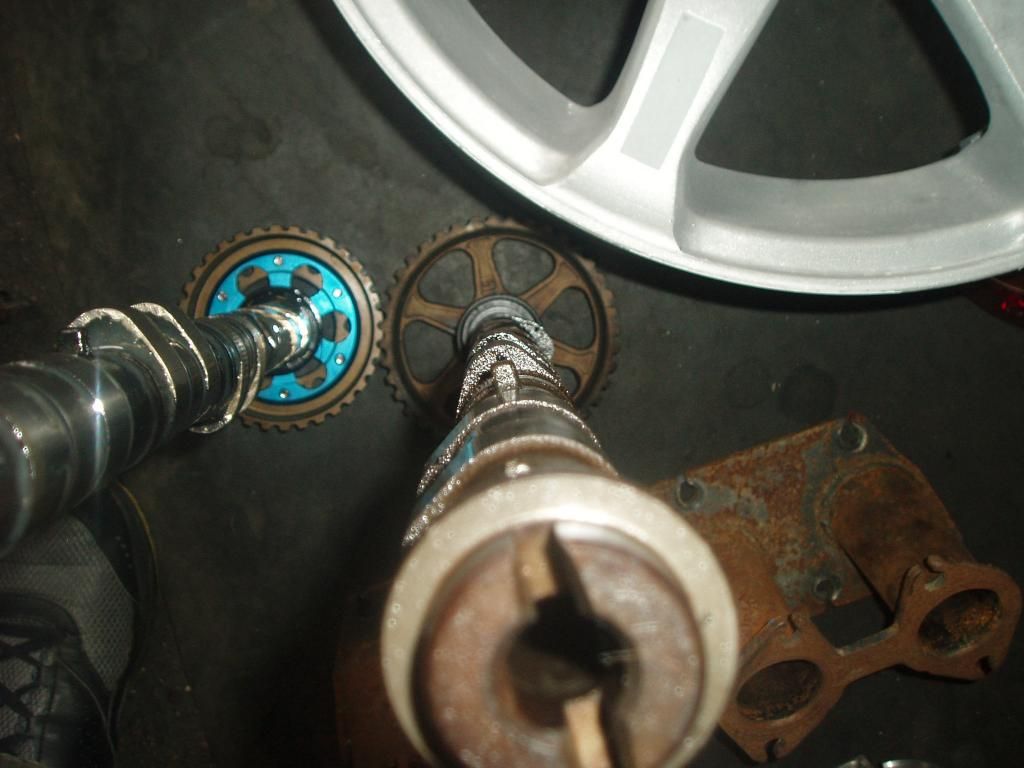

    here are my new cam specs
    cam lift in and ex .272
    rocker ratio 1.55
    valve lift 416 in 414 ex
    duration at .050 lift 244 in and ex
    lobe centerline 105 atdc in 105 btdc ex
    timing @.050 lift in open 17btdc closes 47 abdc
    ex opens 47bbdc closes 17 atdc
    lobe seperation 105
    overlap will be somewhere round 34 degrees if my math is right
    should be interesting to drive when tuned
    engine builder cam duration map at .006in .008 exhaust 290 degrees inlet and exhaust

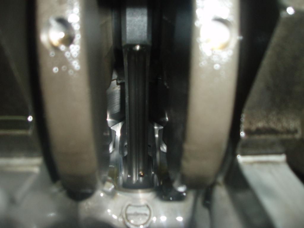

    couple of pics

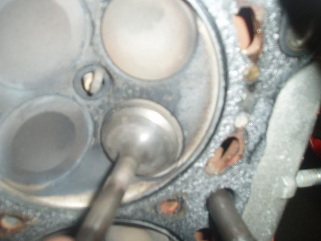

    you may be able to see that the valve in the a5 head are a bit bigger than whats in mine.
    Going to have to have the seats in my head recut to suit the evo valves..

    pulled a couple valves out
    Ferrea 25 degree super flow mitsi 6g72t 1mm os inlet and exhaust are what the part numbers come up as.
    has a talk to the guy that built the a5 today.
    he's going to come and have a look at the bearings and pistons.
    mainly to make sure the crank and pistons are reusable.
    but to see how much is involved in recutting the valve seats to suit the os valves.
    the bearings are a bit shiney , and a few are showing signs of flaking ,so i 'd say its been revved hard, prob on the dyno ,he thinks when it was tuned.
    owner apparently wanted to see what it would make, near enough to 280 on 45 dhla dellortoes fwhp @8500rpm.

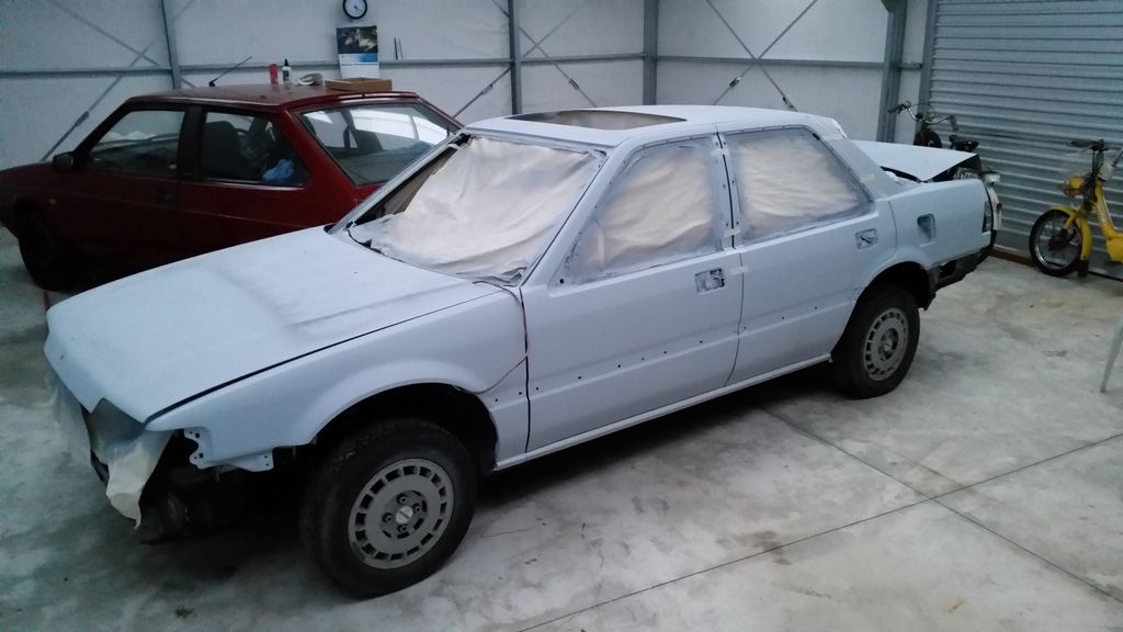

    Finally got a pic of the old girl.
    A guide coat , another coat of primer and she's up for colour
