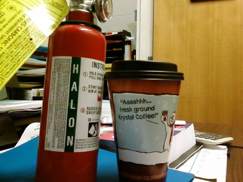

    Power steering fluid or Dexron has a low flashpoint the warmer it gets. I found that out the hard way once when I was working on a customers 68 mustang , the power steering is a ram servo on the drag link, right by the exhaust.
    [IMG][/IMG]

    How about let's say "fully involved" lol.. sorry to hear about the Buick. No telling how that happened, the ice is conductive so it could have got on the batt wire around the starter and shorted. Some of those Buicks have the battery and main circut protection under the back seat too, wierd but I like those .
    and race12001, I never use halon, that is an extinguisher I keep on my desk in case one of guys in the shop set themselves on fire takng a gas tank out. (first responder ) Yes ABC are much safer, I have those all around ....not quite as handy sometimes though. thanks for empathizing the danger of halon that I may have recommended inadvertently without warnings.
    How would an ABC extinguisher freeze though, that is wild.
