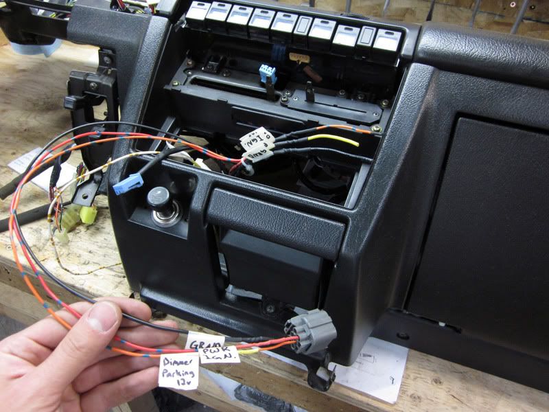

    It was a good weekend, and went by very quickly.

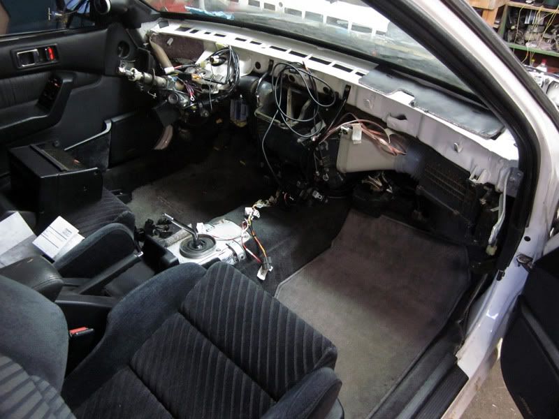

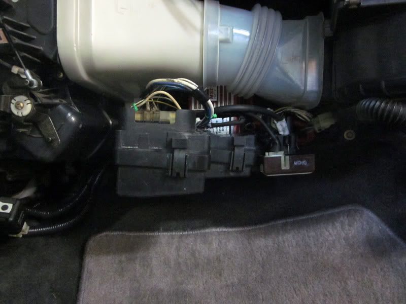

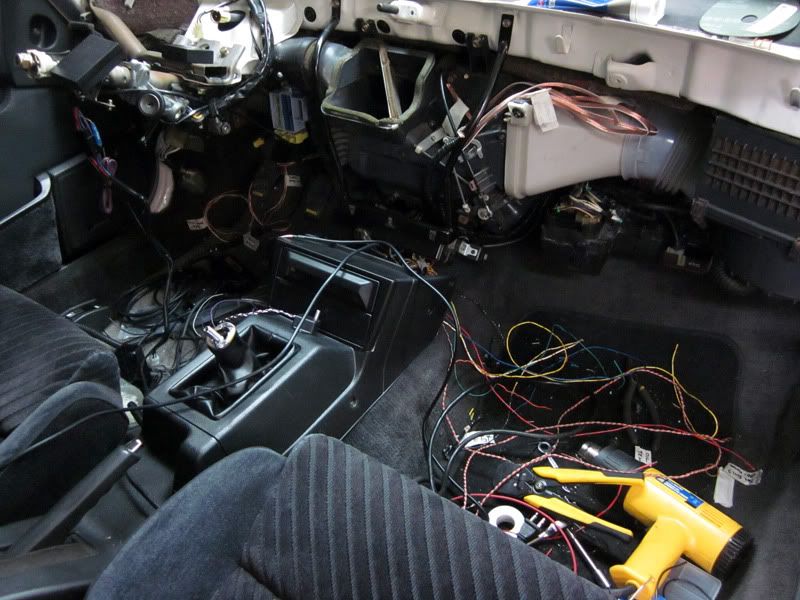

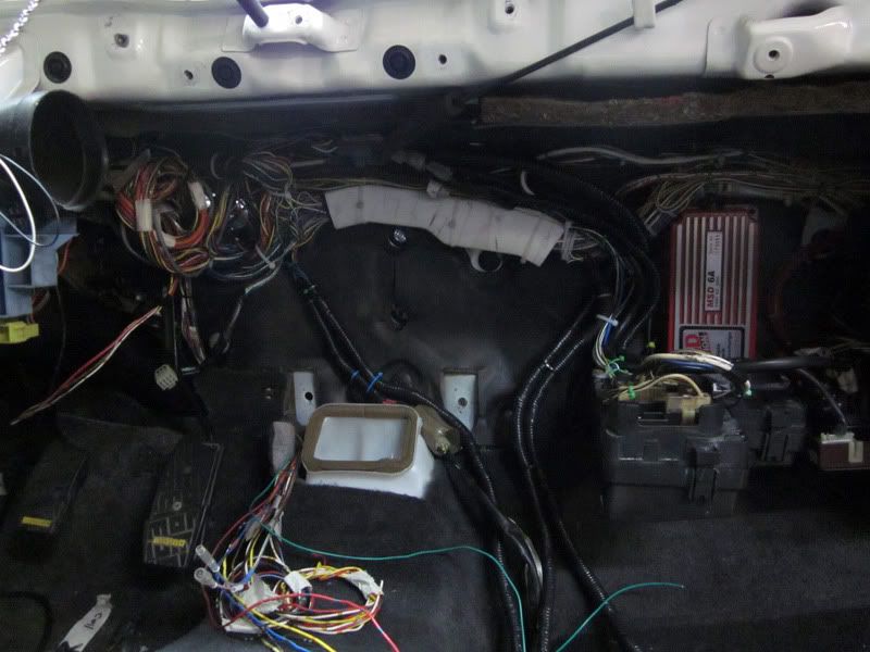

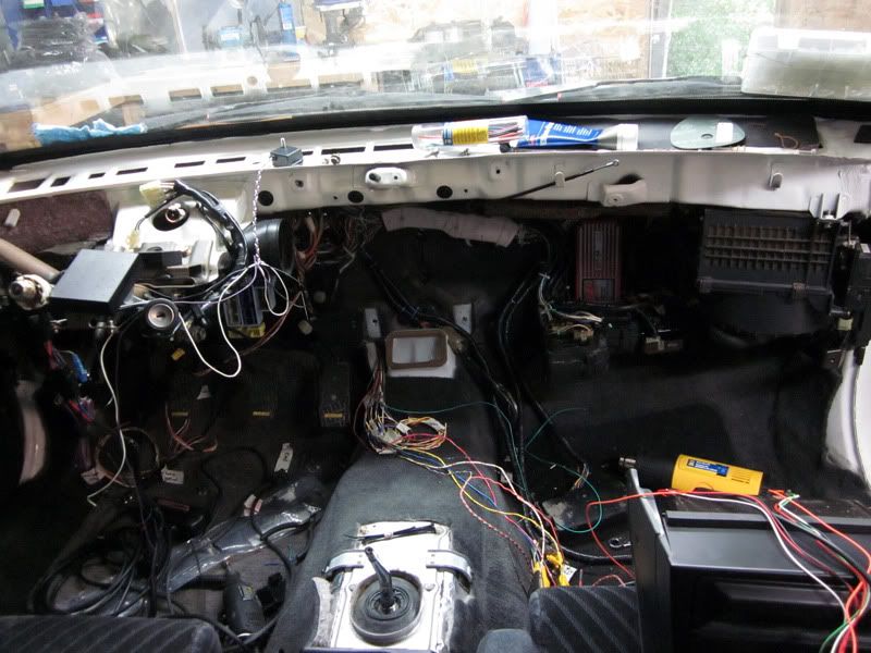

    First I wrapped up the engine bay and then I moved on to the interior(shudder).

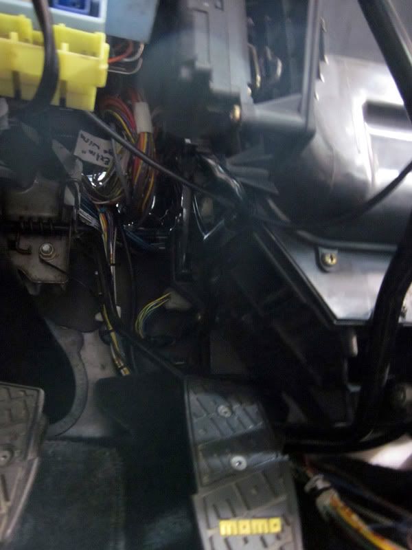

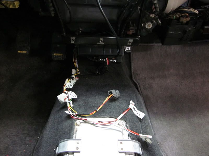

    Cut, strip, solder, heat shrink, repeat, and repeat.
    I wanted to make it possible to remove the dash if necessary so I put a plug in.
    I labeled everything for troubleshooting if needed, there is no way in hell I would ever remember haha.
    The dimmer I bought didn't end up working for whatever reason(tried it when I bought it and it worked) so I never used it. I had to put the wideband box somewhere and under that other box worked out perfect. I'm happy with the way it turned out and everything fits.
    Andrew.

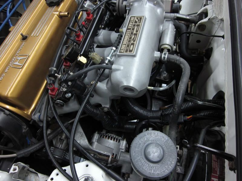

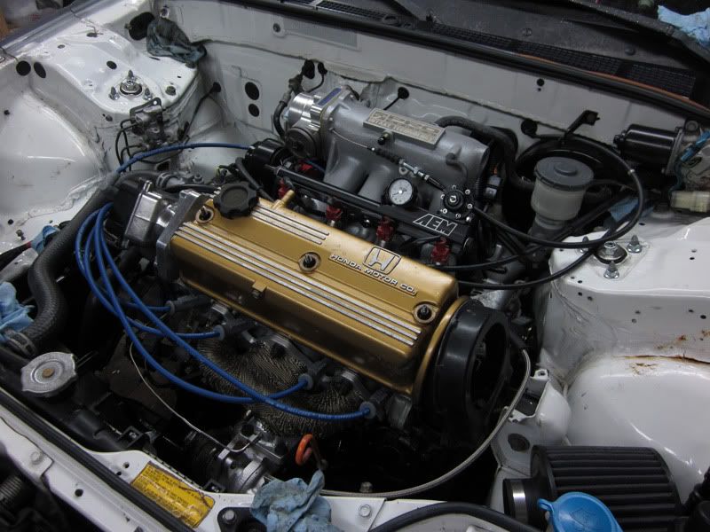

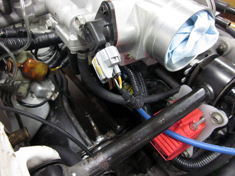

    The coil mount is a plastic template until I can source some aluminum.
    Saved a bunch of space and it turned out well, I can reach just about everything without having to remove half the engine. I don't like the blue wires but oh well..
    Some major progress is finally done.. only took months and months but I can move on. I think I'll mount up the intercooler and start the piping.

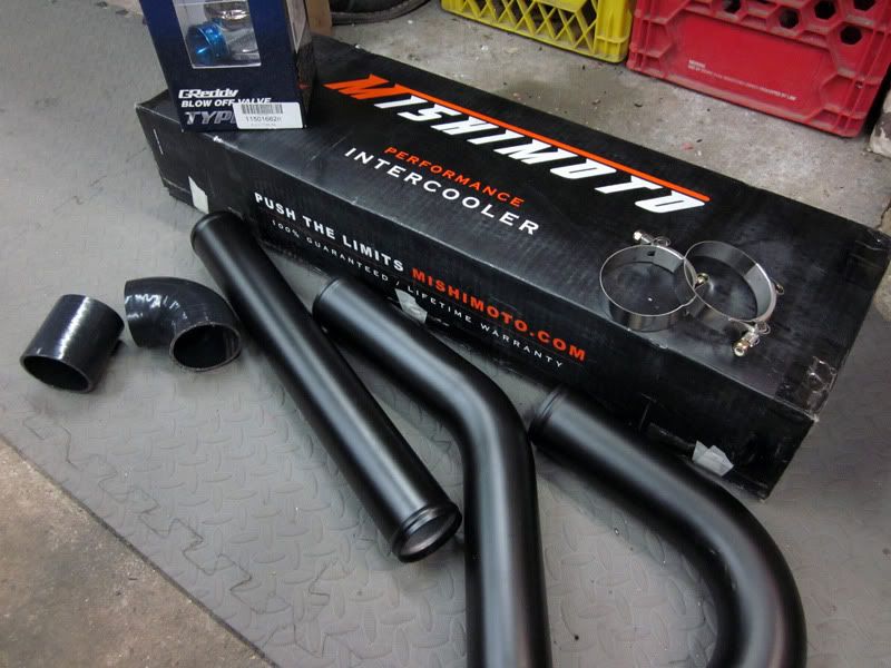

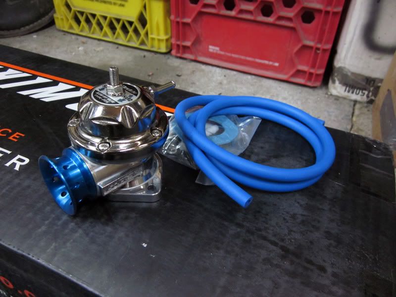

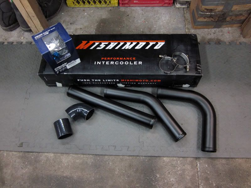

    Some more goodies..
    Mishimoto black intercooler, black piping kit(2.5"), greddy rs bov
    No flange for this so I'll have to make one
    Loving the black, it's going to be awesome when it's done! It'll also have that sleeper quality I want, plus it looks just damn sweet.

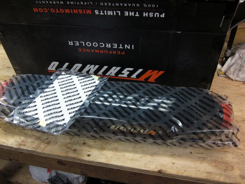

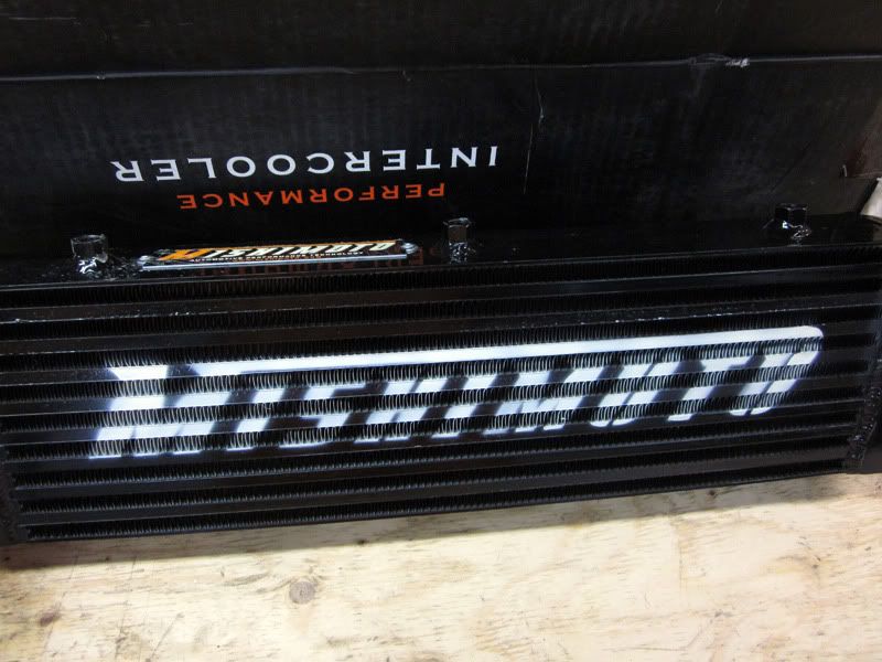

    Size on intercooler???
    -Gio
    My E85 Turbo Build
    5280FEST
  20. #595
    87roach's Avatar
    87 Hatch
    Summerland, B.C.
    1,629
    Re: 87roach's 1987 S Hatch Build
    Overall size is, 28" x 6.25" x 2.5", with a 2.5" inlet/outlet.
