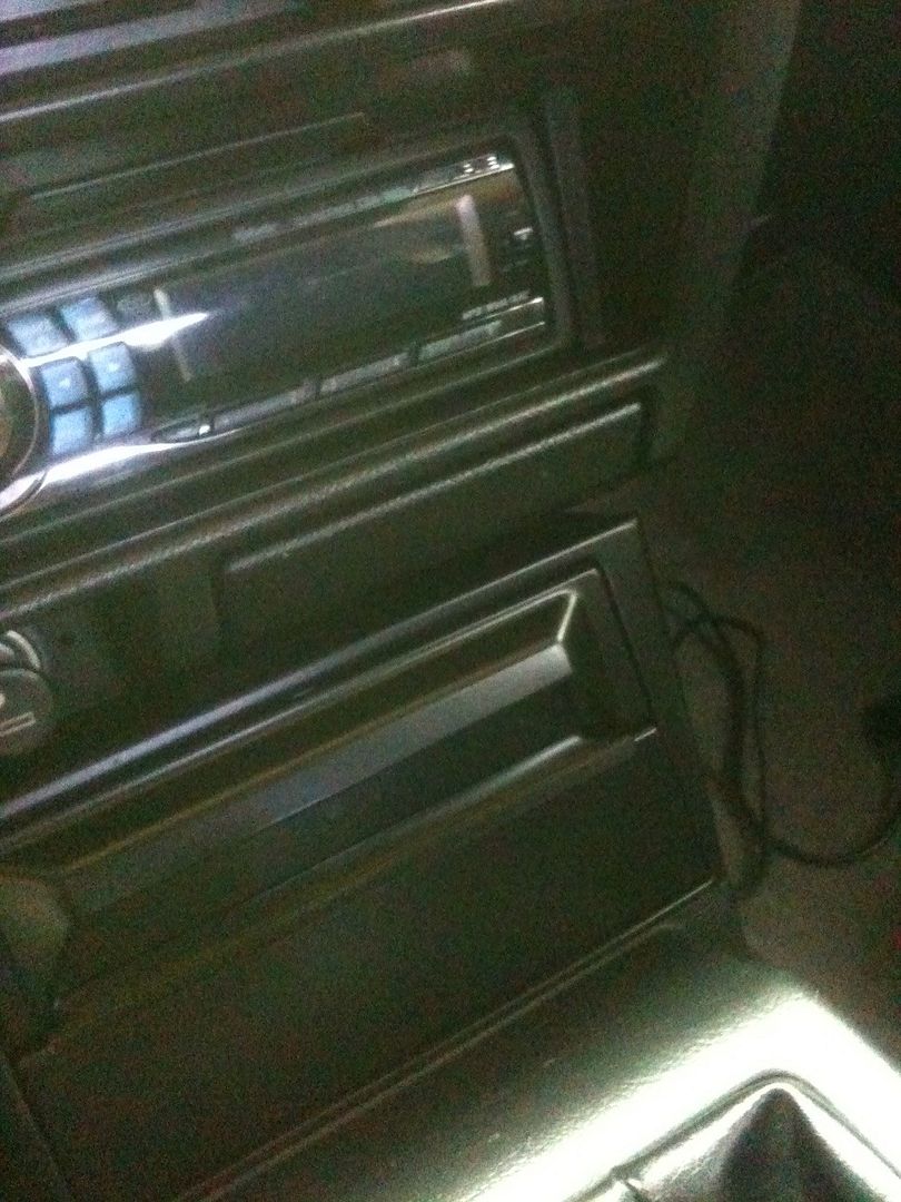

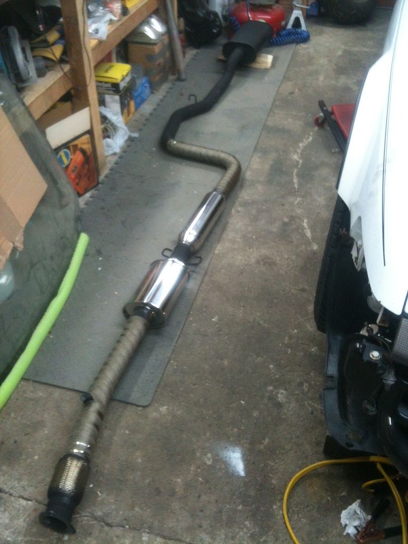

    The exhaust before install:

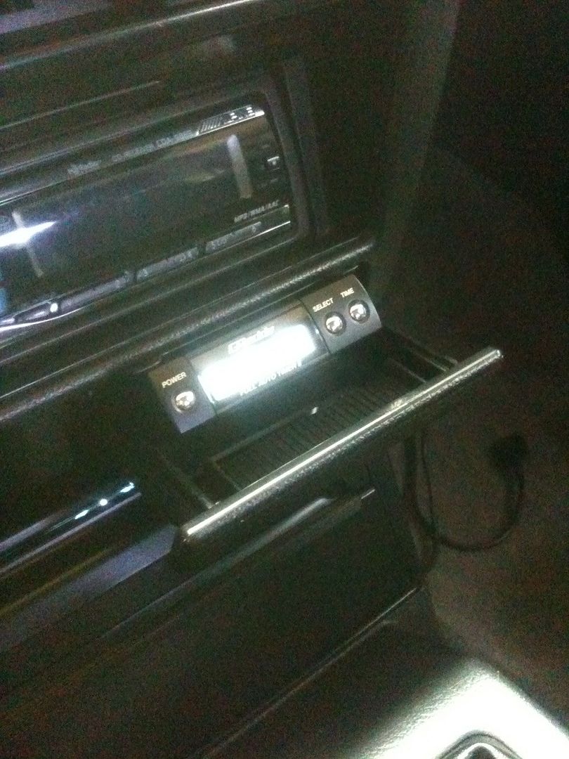

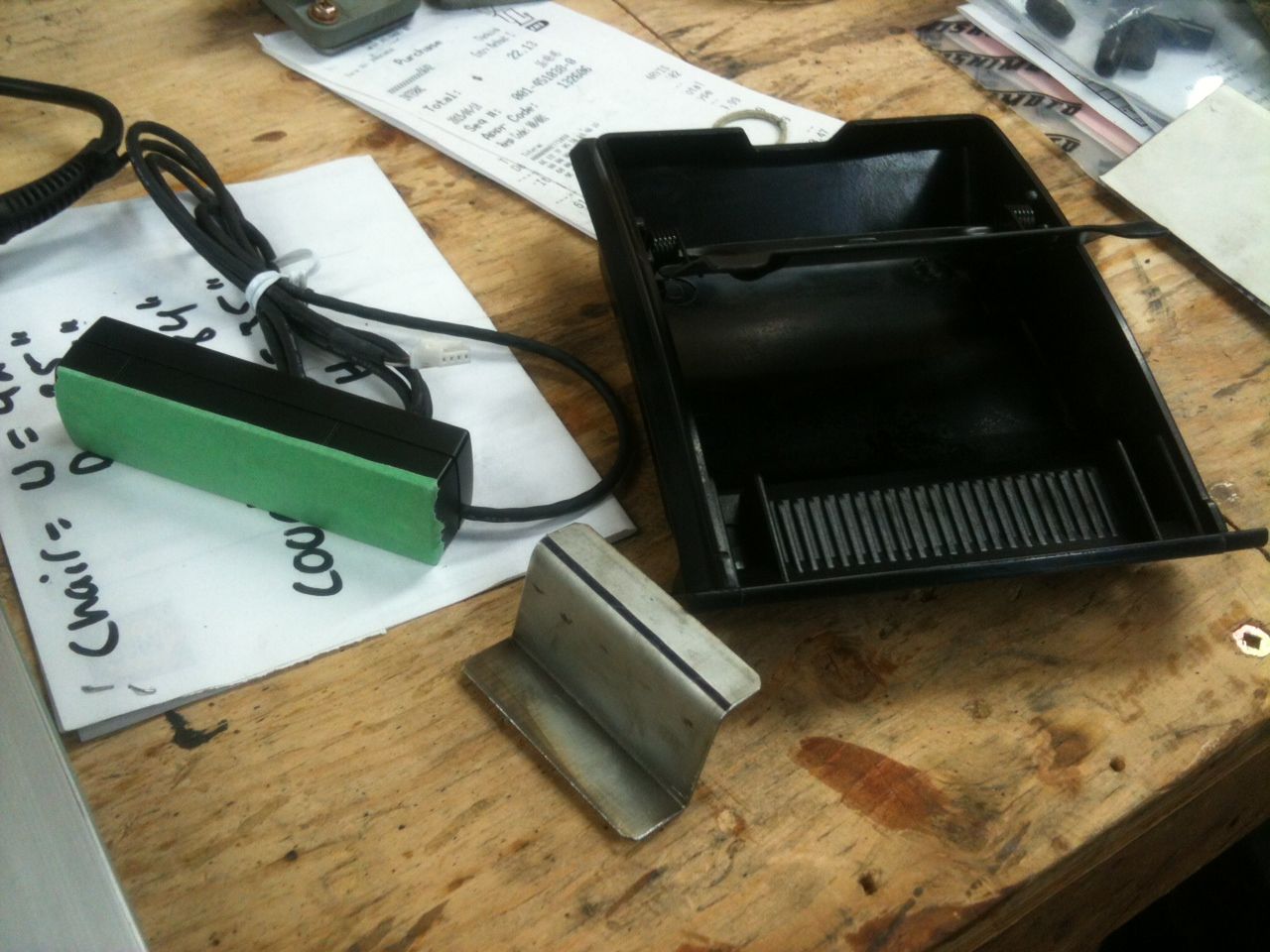

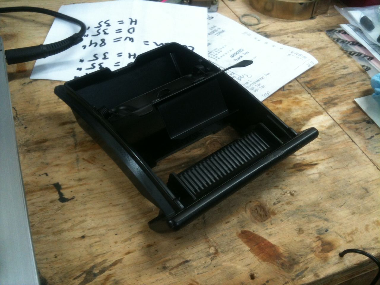

    The turbo timer face, ashtray, and bracket:
    I basically put the bracket in while holding the timer in place and then cut away whatever material was in the way so that it would go all the way down.
    The finished tray:
    You don't even know it's there is what I like:

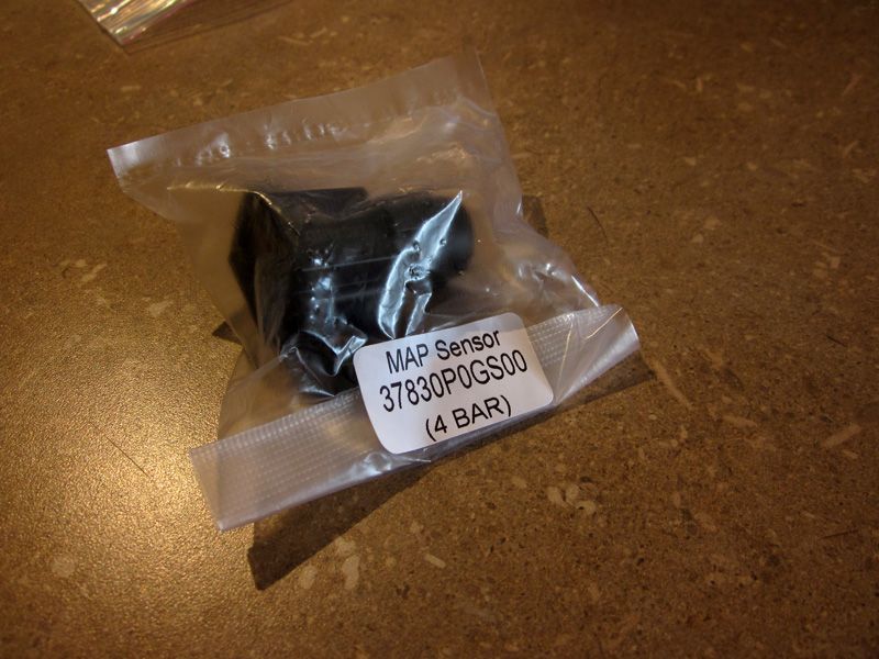

    Today I found my new 4 bar map sensor in the mail box, woo.
    The new battery should be here this week and then the Demon is also on its way but is probably at least a few weeks out still. I am definitely looking forward to getting that installed!

    DTC Auto 4 bar map:
    DTC Auto NEW 4 BAR MAP Sensor FOR Turbo Honda D15 D16 B16 B18 F20 H22 H23 Series | eBay
    This costed enough, I can't afford $100++ on a fancy one. I am sure this one will do the job though.
    Andrew.
