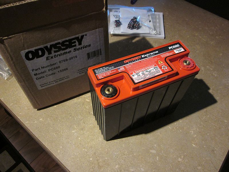

    The battery is an Odyssey PC680.

    I ran that battery and hated it. It dies fast. Be sure to get a battert tender for it to keep it at 110% when you not use the car. These are deep cycle batterys and need to be "over charged" to full charge the battery. I did upgrade to bigger one

    Care to elaborate? Why would your battery die fast? Power problems? Poor alternator?

    ^I had a power draw somewhere also. The battery it's self has little to no auxiliary power so when playing music no sub with the car off it will only last 5 minutes or just sitting when tunning the battery would die. The best thing to do it just get a battery tender and hook it up when you not using the car. Just like you would for a atv or dirt bike.

    had this argument in one of lostforawhile's threads. The Pc680 only has a 170 CCa rating (540 hot) with a 24 min reserve, so any drains as you guys have encountered would kill this battery in no time as you guys found out. its nice it still is a Pb type battery and the discharge curve wouldn't have the cliff that lithium types have.
    all depends on the usage, for a DD i'd suggest a normal battery. For my "toy" car i use the optima batteries being i can get them for less than $150 new

    optima batteries are just as bad ask Messy Honda. He just had a similar situation with his yellow top. A battery tender will fix this either way

    Good points fellas, I would have to agree that it isn't the ideal daily battery but I don't have a sub or crazy stereo and I will be also keeping an eye out for any power draws just in case.. I don't want to waste the bills I spent. I do agree with the battery tender but unfortunately in my current situation there is no external power anywhere on my apartment build so it's not even an option. The only thing I can do is to bring the battery into my place and keep it on the trickle, I think this would only be worthwhile doing on extended trips out of town. I will have to see what happens over the next few months though as I will hopefully be driving quite a bit and messing around in the car! Actually when I was looking at the old PC680 and the new one I just got I noticed that the new one was quite a bit of a step down from the previous, the new one with 170CCA and the old one with 220CCA for instance, also the voltages were different when running the car too, I believe the old one was around 14.6v(give or take) and now the new one is 14.0v'ish, the car still started fine on the new one but I wanted to note the differences(I'd have to look again for every difference though).

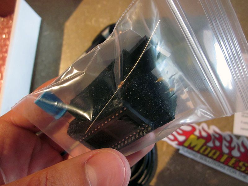

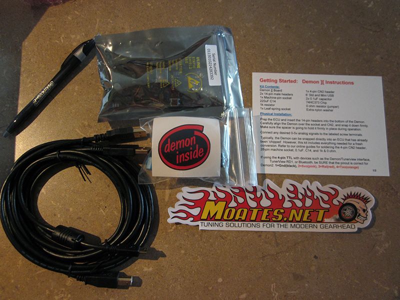

    This is the Demon 2!!
    So I was able to return my Honda Tuning Kit(that I purchased probably 3 years ago) to Moates and use the credit towards the Demon/Neptune RTP Combo, it was well worth it and simplified everything. I just have to install it now which I will be trying to tackle this evening! I'll take some pictures as I go along too, I'm stoked!
    Andrew.

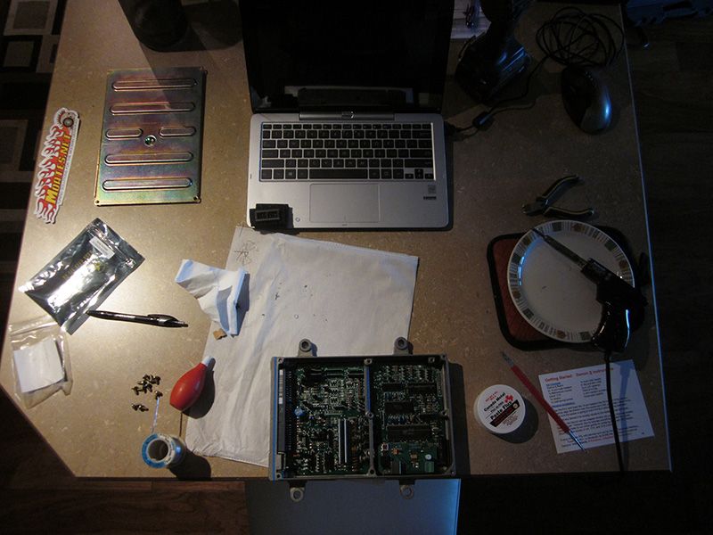

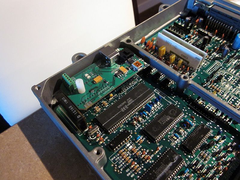

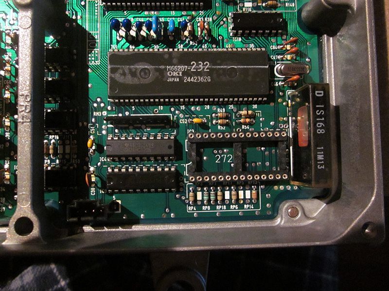

    The ECU of course:
    All the resistors and hardware components installed(sorry no before picture):
    The kitchen workstation!
    The Demon snapped into place!
    I have to cut two holes into the case so I can access the USB easy, and also so I can connect my wideband(to the green). I don't have those tools right now so it will have to wait till the weekend. The install went well, I followed the directions and I didn't actually have any de-soldering braid or the pro sucker device but I did have the bulb and it worked very well when I heated the front of the board and used the sucker from the back. After a bunch of that and soldering the rest into place it was just a matter of plugging in the demon to the board and that's it.
    Well I think I'm ready to go.. I bought a netbook so I could have something portable for tuning, plus the map sensor, plus the battery, plus the demon.. needless to say I am a bit in the red. However, it's going to be worth it as I will finally be able to drive the 3geez again! I'll have to get some pics and videos going on soon, I still have to get those engine bay ones.
    Any tips on tuning are welcome, of course. I have a lot to learn so any help is welcomed.
