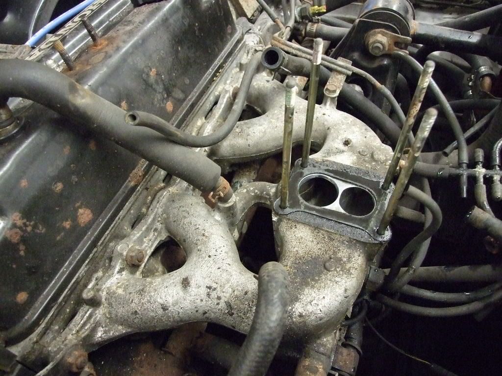

    The kit from the 76-83 probably will not work. Have you taken the carb off of your intake manifold to see what the mounting base looks like? If so, you might be able to compare it to another kit online. I haven't ever seen anything for the EZ motor online, and it might not be common enough for any companies to have made it. The kit from the 3g Accord might work... Worst case, I bet there is an intake manifold from another car that will bolt onto your head, then you can get the adapter kit for that intake manifold.
    You should get some pics of your carb and your intake manifold and get post em up. Someone might see something that might work, or at least something close that you could adapt.
    Here's the stock intake manifold for my car. If the ports on your head are the same, you could probably put an intake manifold off of my car onto your head, plug the CVCC hole with some Quicksteel or other steel putty and bolt on the Weber. The sad thing is that the US intake manifold is nowhere near as pretty as the one on your car...

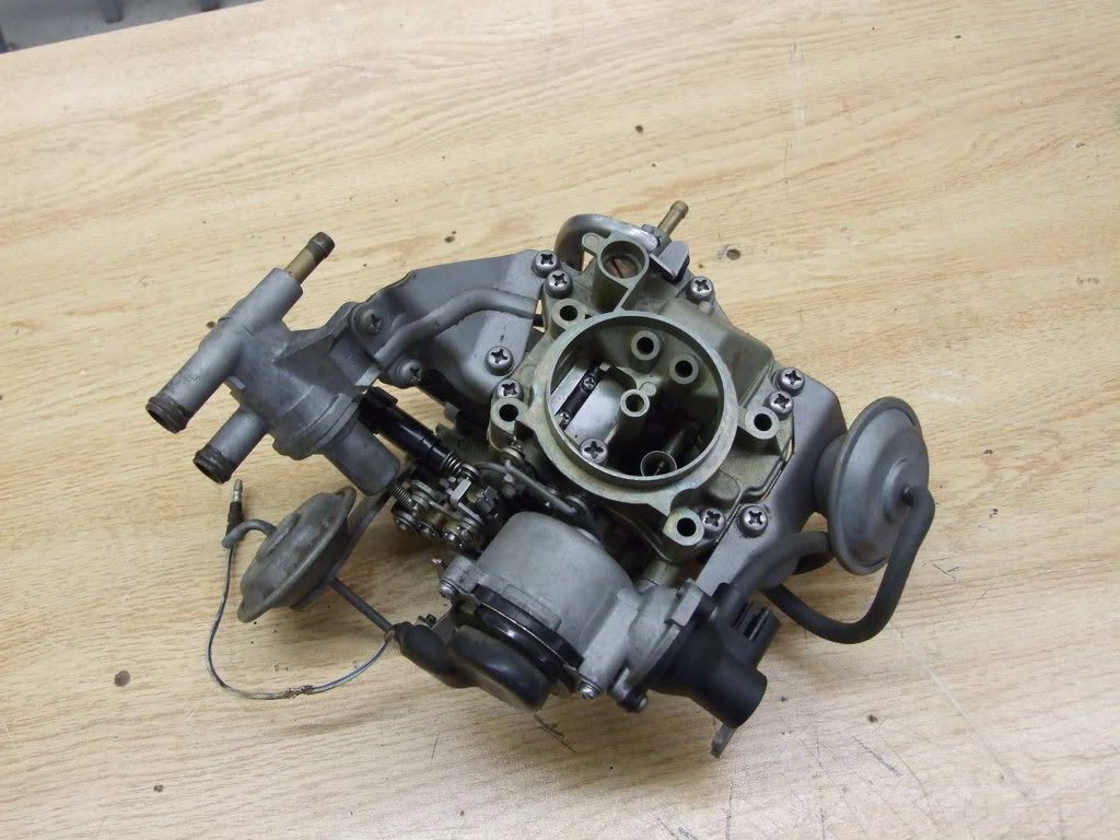

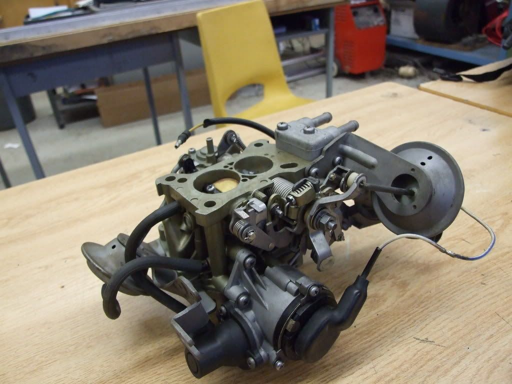

    alright i took off my carb, the first time ive ever touched it really :p
    here is the rebuilt carb i have
