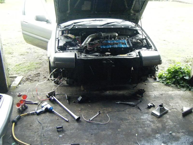

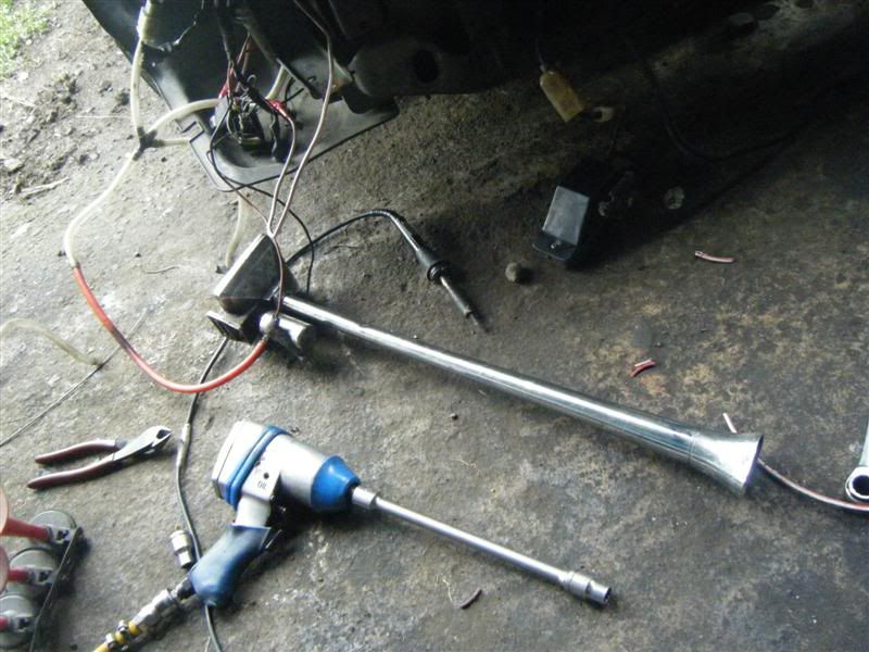

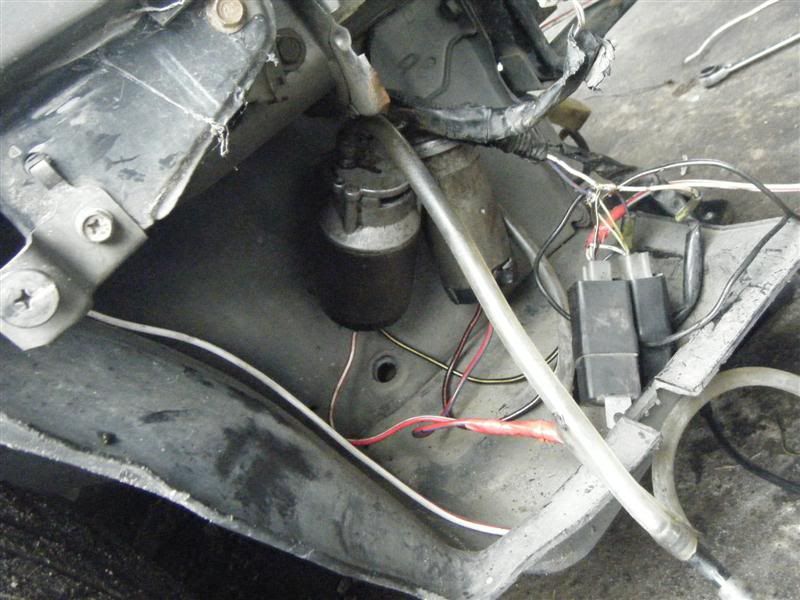

    did you read, of course its waranted. ill reg rego on monday maybe. this is what i did this afternoon, truck horn, 2 X air horn eletric pumps and fited it with siome relays into the accord. it aint that loud but it works
    heres a video
    http://www.youtube.com/watch?v=yPmz_w82T3s

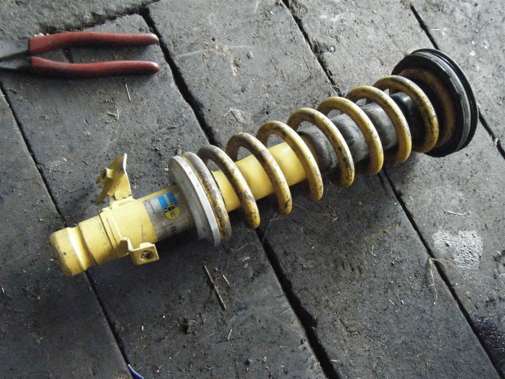

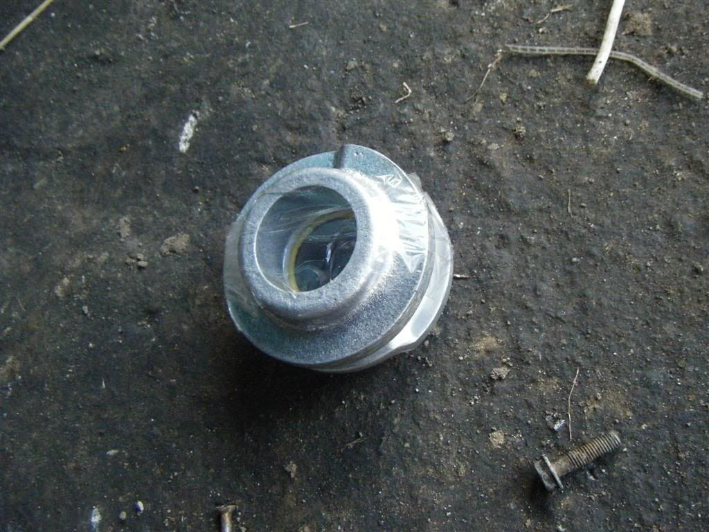

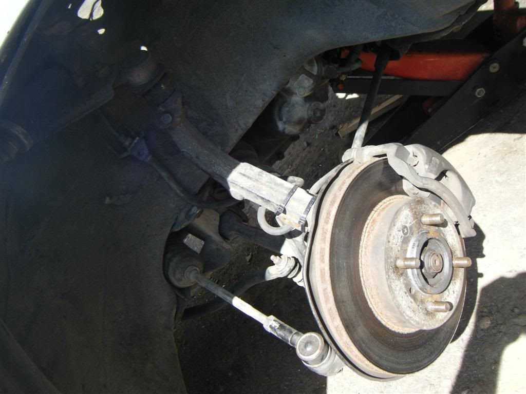

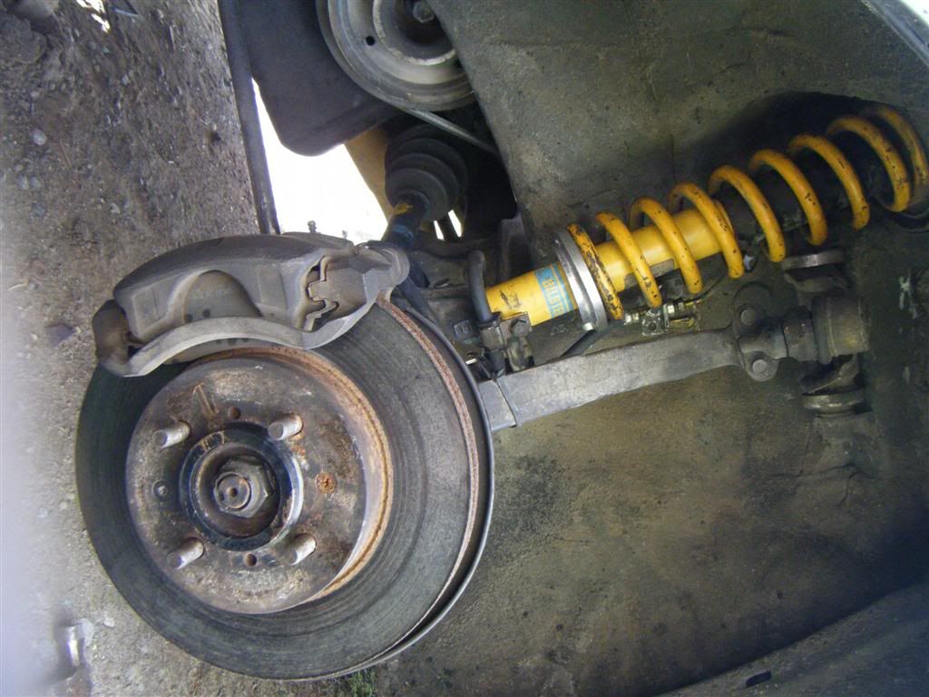

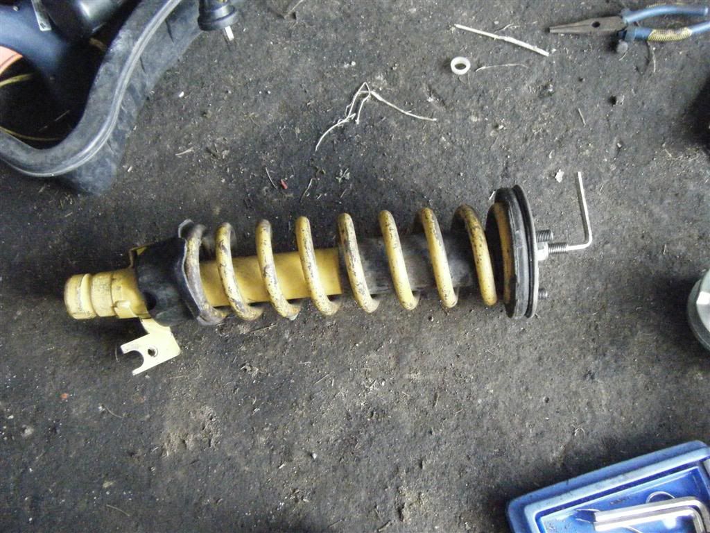

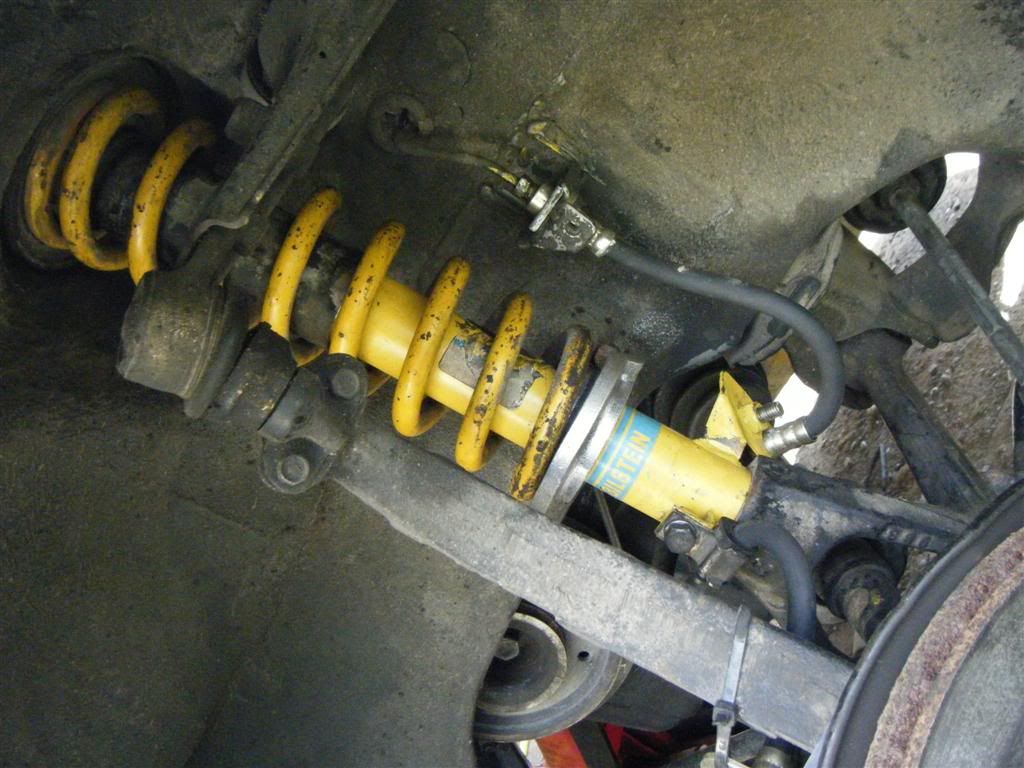

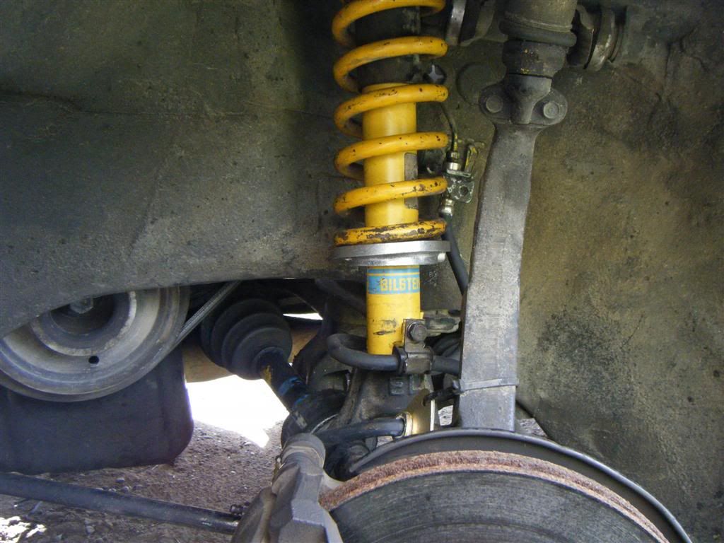

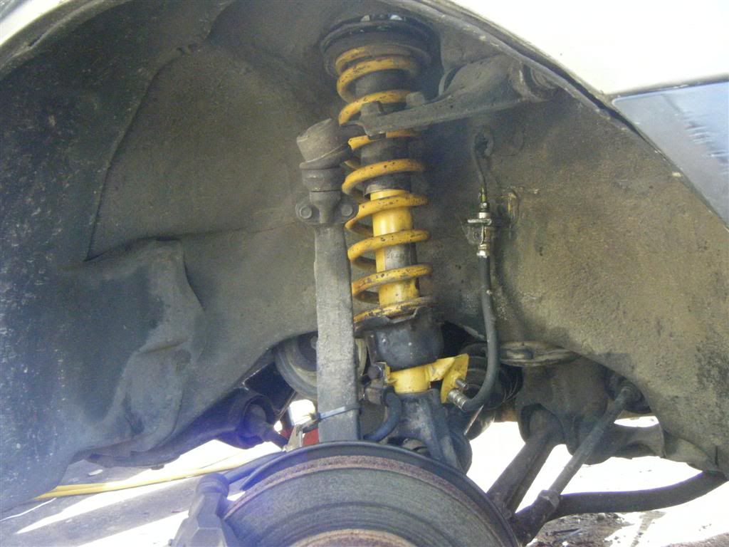

    right i finally got these in the mail for my bilsteins!
    so today i installed them, the bilsteins have been in the car but i had some rear civic spring seats siting on the brake line brackets because the person i got the shocks from did not send me the seats.
    heres some pics of the install.
    only problem is the car is a bit higher now.
    sometime in the next few weeks ill pull them out again and take them into the shop and get some circlip grooves machined lower on the shocks. i think ill be able to go another 2 inches lower!

    The height is not to bad. Shocks look a lot cleaner and safer this way.

    Re: AccordB20A's 2.0Si F1 Edition Build
    So much more legit then that last perch haha.
    Good job.
    Andrew.
  11. #761
    yeah the car handles better too with the proper spring seats there. after its been lowered to where i want it ill get a wheel alignment done and maybe some new tyres. i want to go from 205-40-17's to 215-45-17s as the 205's are a bit hard and the car feels all twitchy, also the bigger 215's will probably correct my speedo as i have to do like 107km/h to actually hit 100k

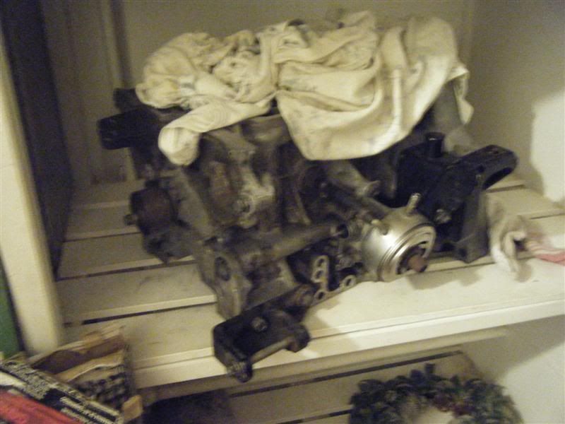

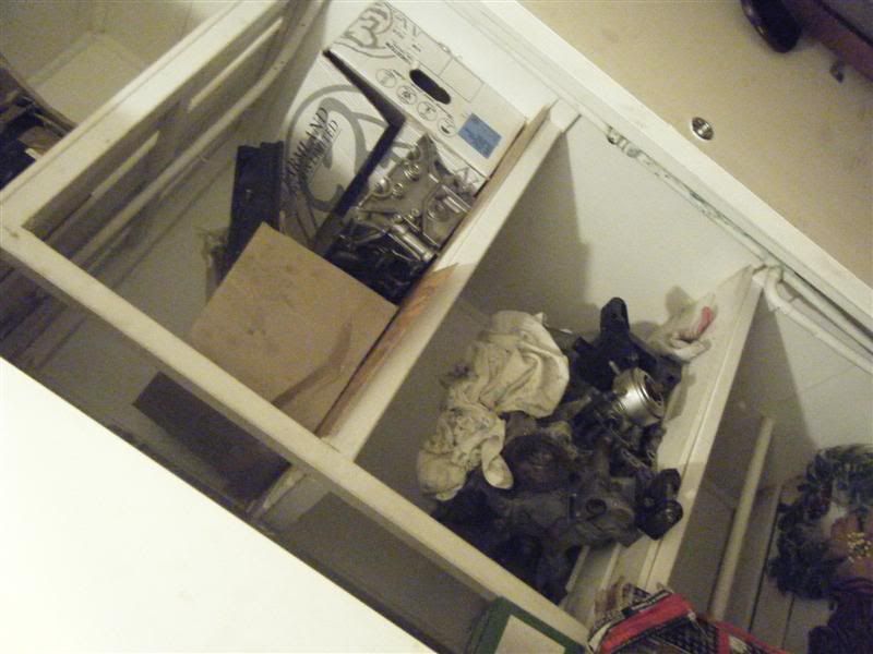

    right chaps, engine rebuild is going to happen AND im going to do it myself. YAY
    but im going to cheap out on a few things:
    Im only going to plain the head and replace the stem seals and do a valve grind, not rebuilt the whole head like i was going to. the motor i got the head from was mint as so new stem seals should do it.
    im not going to do the arp rod and head studs this time, stock rod bolts and New OEM head studs will be used.
    Whats in your hot water cylinder cupboard?!?!?!

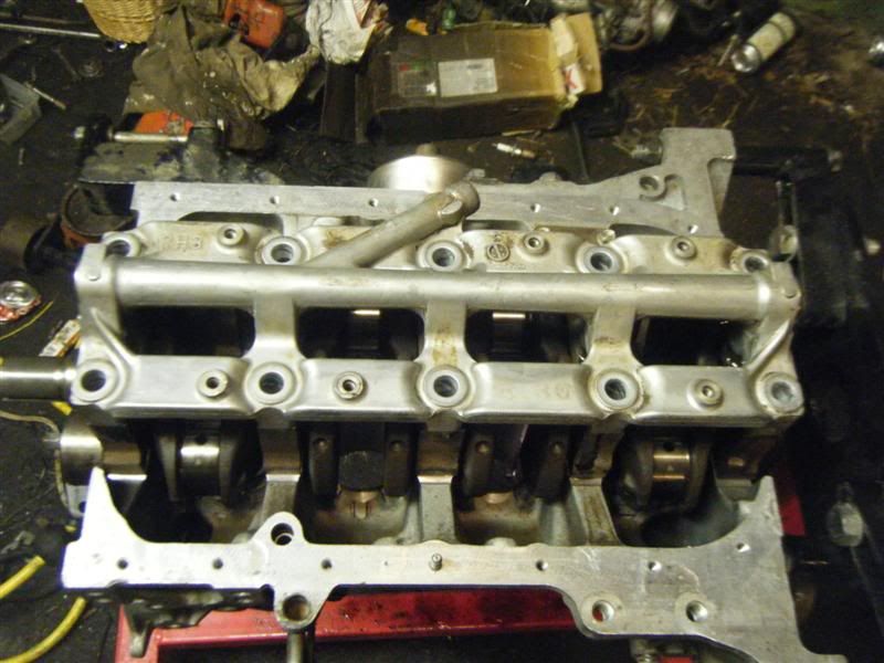

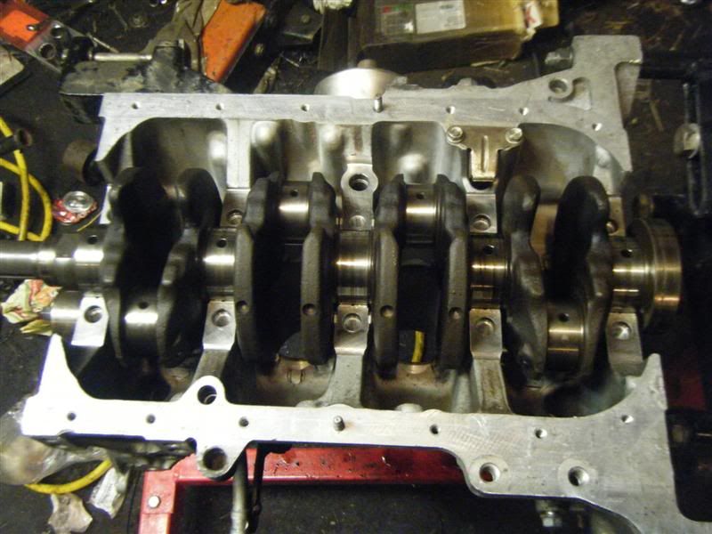

    i have all my b20a parts back, this weekend im putting it together (Y)
  23. #773

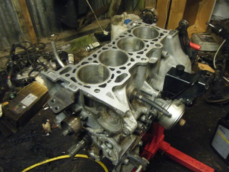

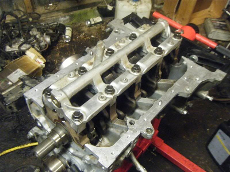

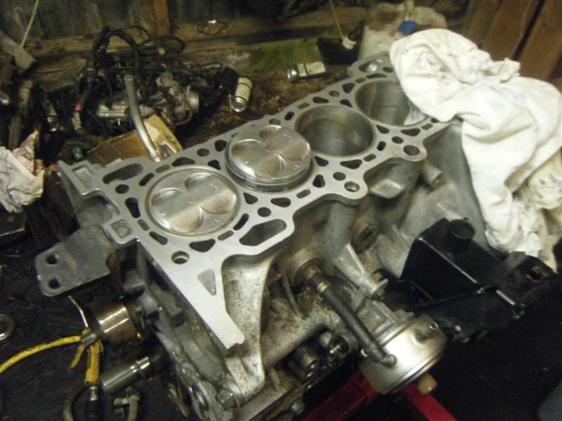

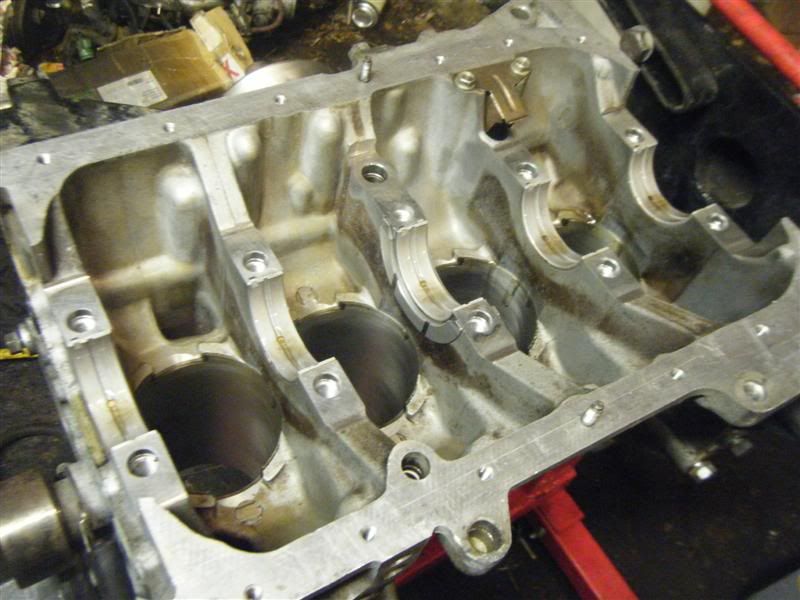

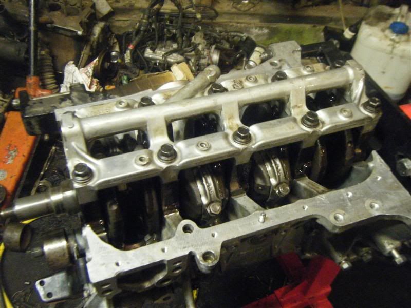

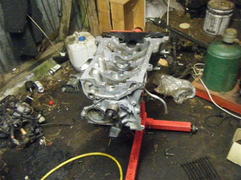

    well lookey what we have here
    take one cleaned B20A block
    Add bearings
    add crank
    add main bearing caps
    add bearing cap bridge thing
    and some bolts and torque them
    Cool.......

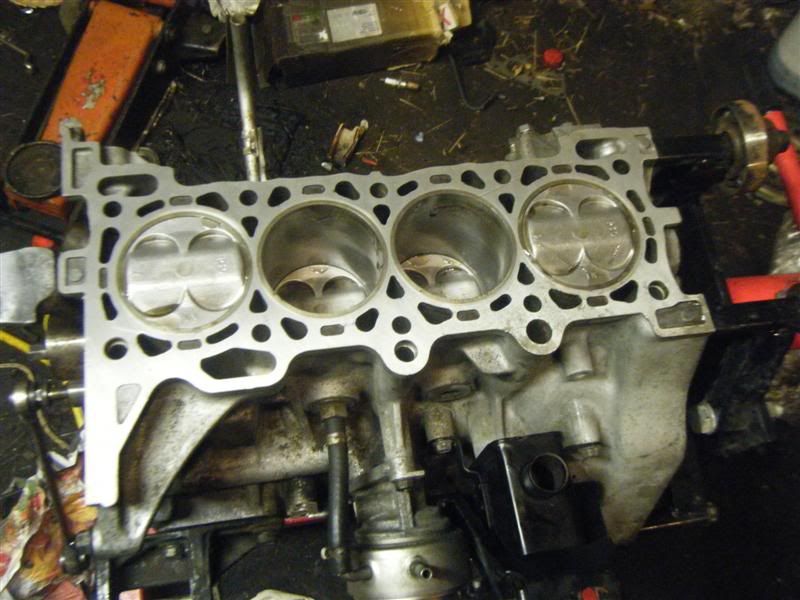

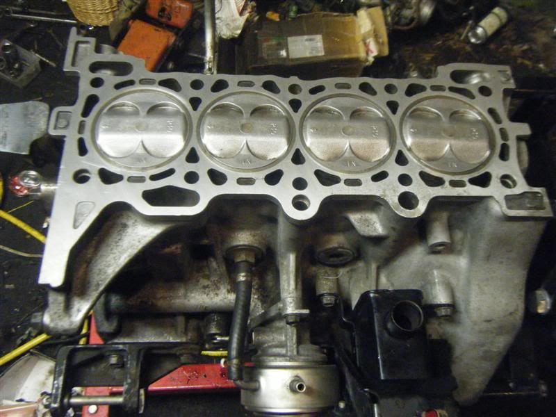

  24. #774
    now we flip the block up the right way
    and slowly add pistons
    and connect them up with the right bearings / check clearances etc
    done

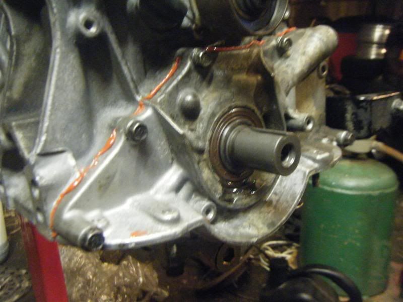

    then add oil pump and a new front crank seal
    thats all folks
  25. #775
