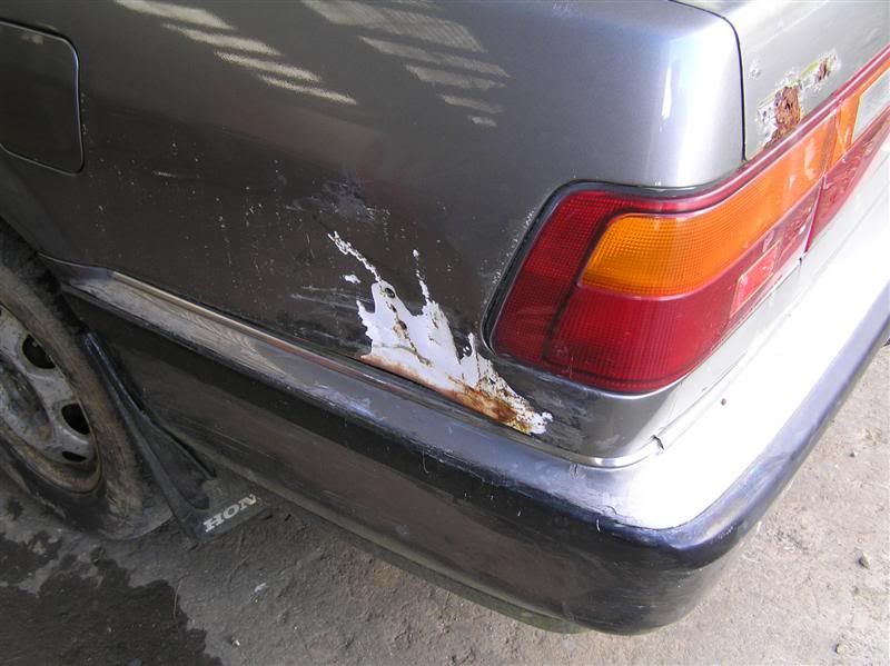

    right i have failed my wof safety check. it failed on both rear upper arms, split pins in lower ball joints, rear brake pads, rust around boot catch and exhaust leak.
    Ive put new brake pads on and new upper rear arms and fixed the exhaust. but the problem i have is the whole area around the boot catch is rusted out and needs replacing.

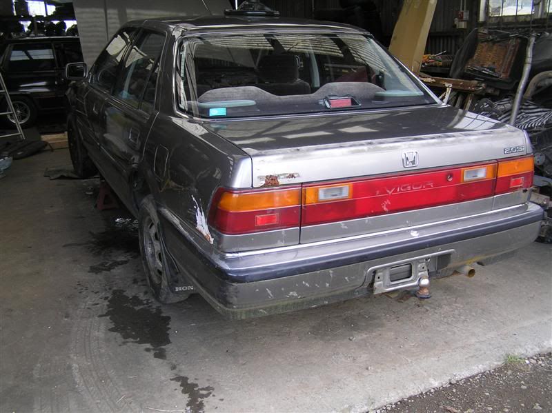

    So i bought a parts car. 1988 honda accord vigor. grey, b20a, auto tidy apart from a bit of rust n the bootlid above the lights
    No pics yet but ill take pics as i repair my car

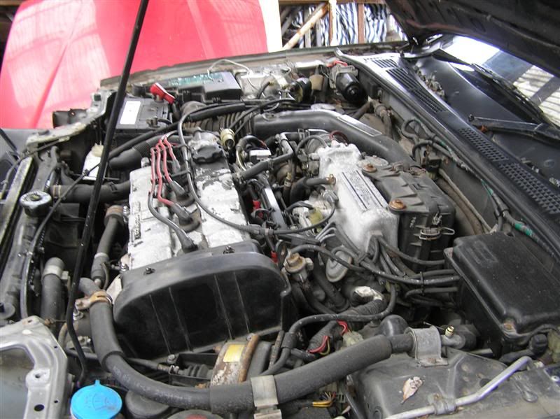

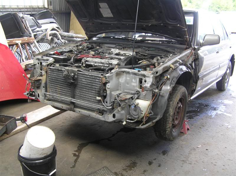

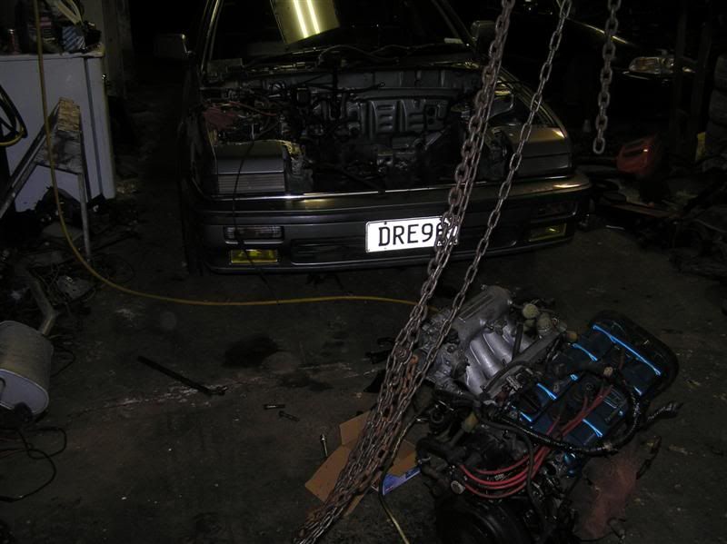

    right parts car (whats left of it)
    This weekend we removed the engine and box front suspension etc etc and i took it home in the back of the CRX, Today i stripped out the climate control/power steering/air conditioner/cruise control and its all sitting in my shed.
    the plan is to reconstruct my accord back to how it was factory. Now i have a cute little baby girl i want something comfy we can all ride in and this cars gunna be it. in 6 months time when the road safety check runs out ill be taking the car off the road for another rebuild.
    Ill be reinstalling the power steering, Cruise Control and air conditioner for summer.
    Heres some pics of the car being wrecked:

    Wow, an engine and a full size tire. holy shit haha
    Andrew.
  9. #859
    SEi User obdriver6's Avatar
    Nov 2008
    1989 Accord LX-I Coupe
    Las Vegas, NV
    1,397
    Re: AccordB20A's 2.0Si F1 Edition Build
    Damn! I didn't know a crx could handle all that weight.

    Bi-powered CRX project? :-)
  11. #861
    it makes a good engine transporter thats for sure

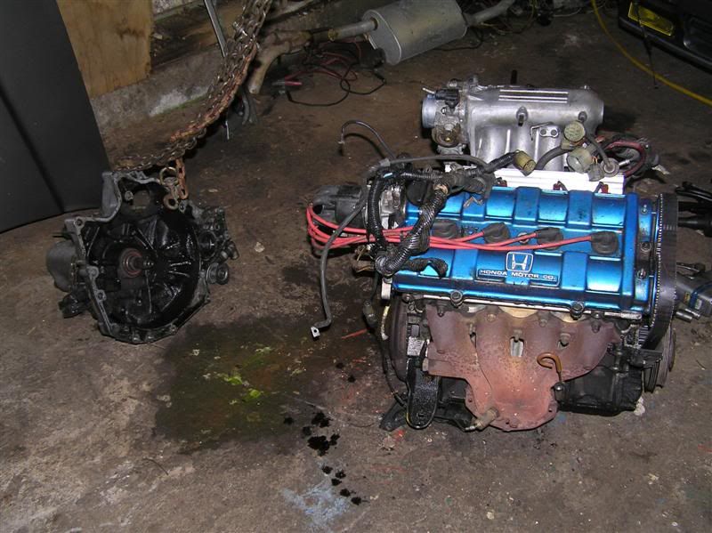

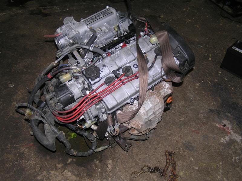

    oh look out comes the engine again
    when i get the flywheel of ill be putting this good b20 motor in

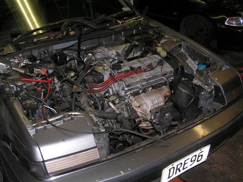

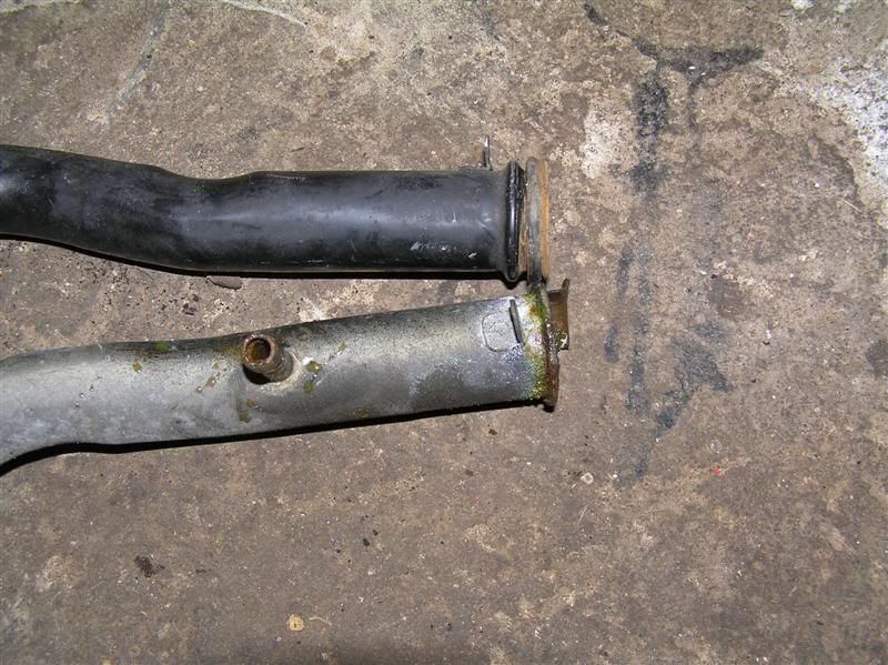

    right the motor had a massive coolant leak, im lucky i spotted it before i put the engine in. the rear engine water pipe where the o-ring is where it goes into the water pump was completely rusted away in there so i swapped it with a good one i had.
    Then i bolted the clutch and gearbox on and dropped it in the hole.

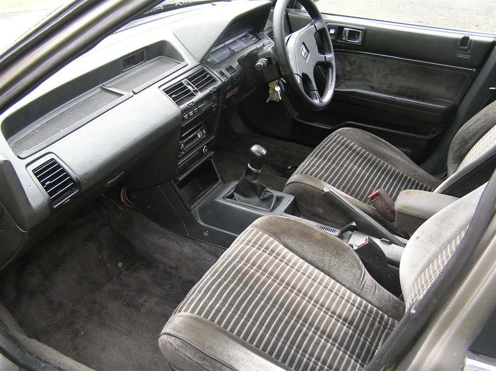

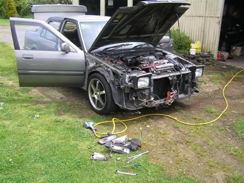

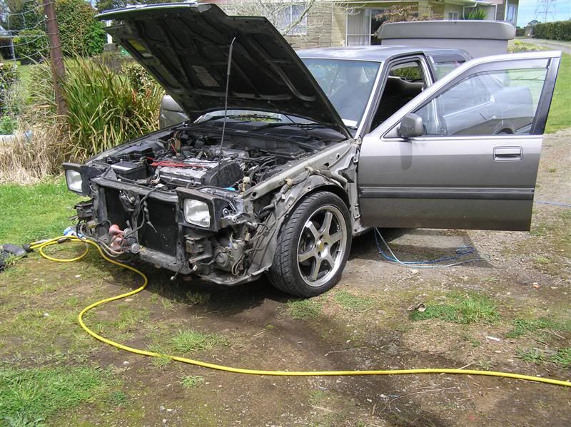

    Right, The Next Step. The heater doesnt blow hot for some reason, the heater core is 3/4 blocked i think. so pretty much i swapped the whole climate control from the parts car into it. While everything was out i removed the whole cars wiring loom and replaced it with the unmolested one out of the parts car.
    So i pulled my whole car apart!
    pile of no longer needed front end parts. the parts cars mint guards and bumper will be going on.

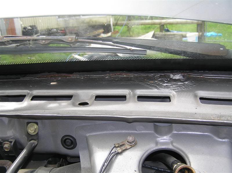

    and this is seriously GAY. windscreen rust!
    Almost time for a new chassis

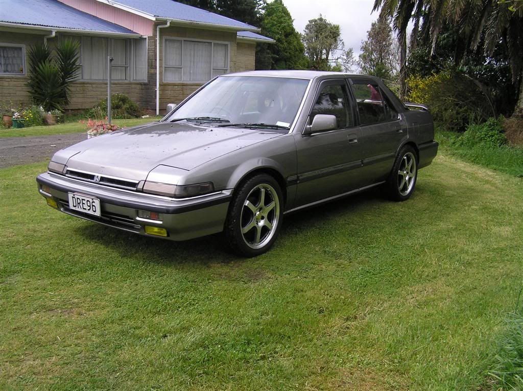

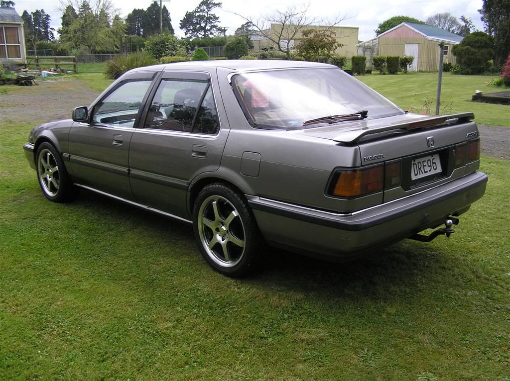

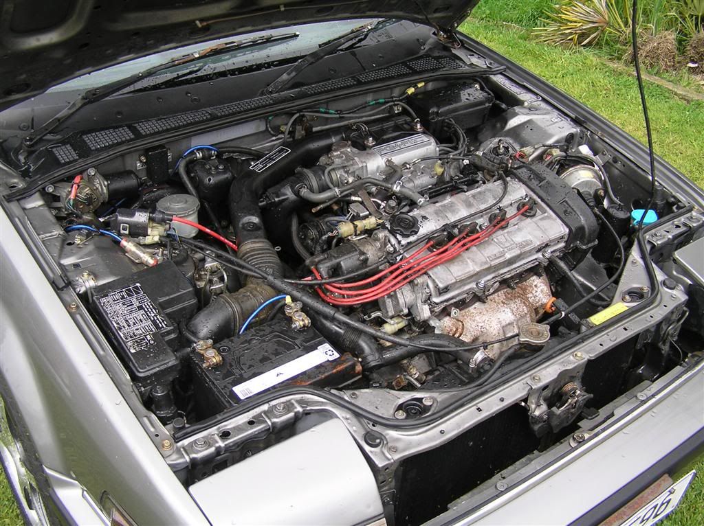

    All back together. interior needs a clean but ill do that later. i just gave the car a wash.

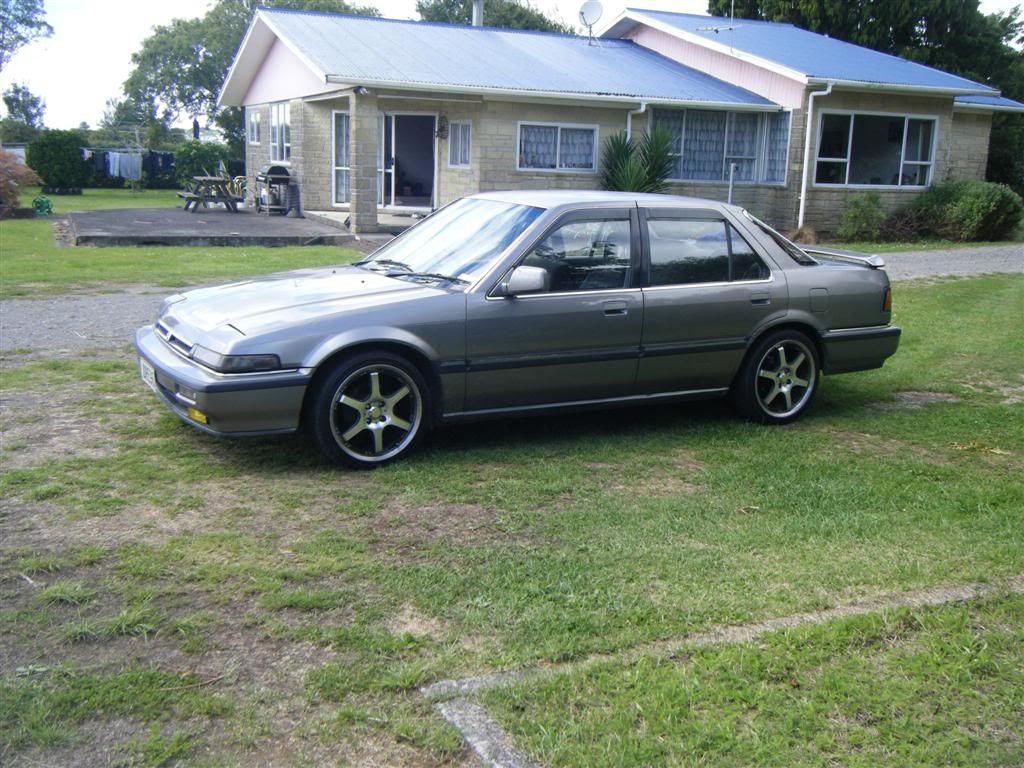

  16. #866
    that lawn looks really mint (Y)

    This is kinda late, but I was wondering what rims these are.....
    http://i687.photobucket.com/albums/v...a/DSCF2942.jpg
  20. #870
    some 17X7 brand of enkei
