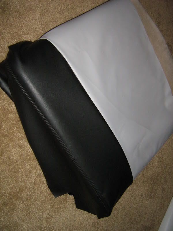

    Here is a pic of the carbon fiber vinyl Im using for my interior
    Re: Interior Showoff thread
    where did you get the carbon fiber vinal bullard? that might look good at the tops of my doors. since the blue has faded. i'm just putting up the link for my hatch slideshow,i have a lot of my interior pics in it,and a lot of pictures of making various parts of the interior. http://www.youtube.com/watch?v=XPO3qn32v2g

    how much vinyl do u need to do all 4 doors?

    2 yards should be more than enough
    Edit: I meant to say 2 40yard rolls should be more tha enough

    it takes a bit more to do the tops of the doors due to how you have to wrap the plastic part.

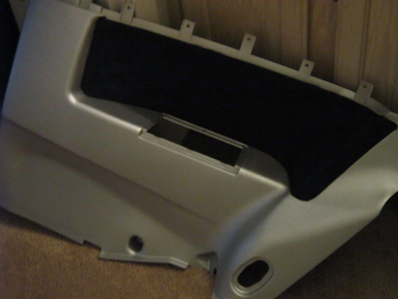

    That looks good Wohdog. Here is a pic of my current progress

    hey bullard on that pannel on the bottom it looks like it need's some stretching.
    get some good spray adhesive and start in the middleof the pannel and work you'r way out.
    get a hair dryer or heat gun and heat up the ends where you have those creases and stretch it to the back of the pannel. you may have to cut slits in the material to stretch them out.
    the top pannel is going to be more diffacult to cover.

    Yeah the curved parts are the parts I had the hardest time trying to cover. I do have a heat gun here so I will definately try that tecnique. And yeah that top part is going to be a lot of fun

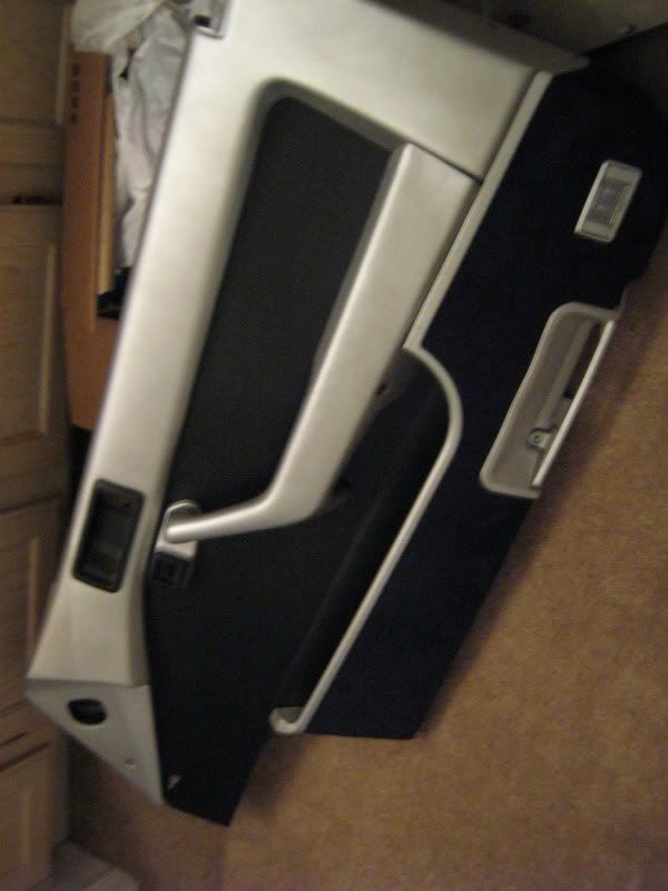

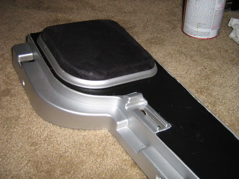

    More progress

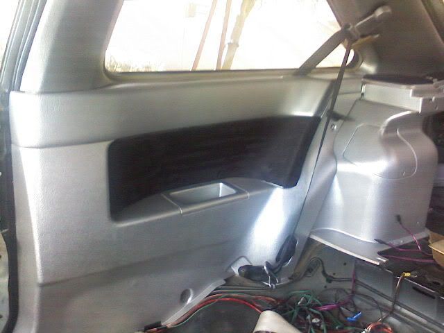

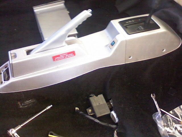

    really nice man!..looks great. did you use the same silver paint i did for the arm rest?
    heres my interior:

    Yep! I tried to cover it with vinyl but it was way too hard

    hell yeah that looks preitty cool
