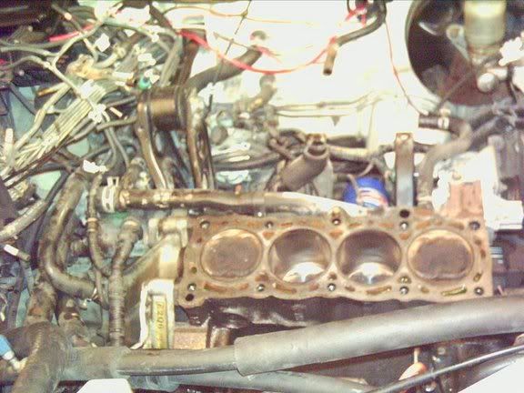

    First off, put the engine at #1 TDC. Also, check the head for any warping. The PCV hose will more than likely break when you try to remove it from the bottom. Here is a few pics of what lies ahead. As mentioned, remove the head, intake, exhaust as one piece. Good luck..
