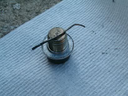

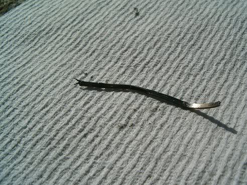

    So right now im draining the tranny fluid, and OMG! Sooo much metal shavings. I also got a magnet and stuck it in the rain hole and found a sliver of metal about as long as a large paper clip. Yea i poured some oil in and just let it drain right out(tryn to flush it and soo much black/metal crap. Yea ill prob end up rebuilding my tranny by the next 4 months..... this sucks.. alot... ill have pics of the oil color and the sliver soon....
    Re: Tranny help please!!!
    Definitely in need of a rebuild.
    Okay pics, at first this was found,
    Then i kept fishing and found this:
    and pulled like 50+ magnet tips full of this:

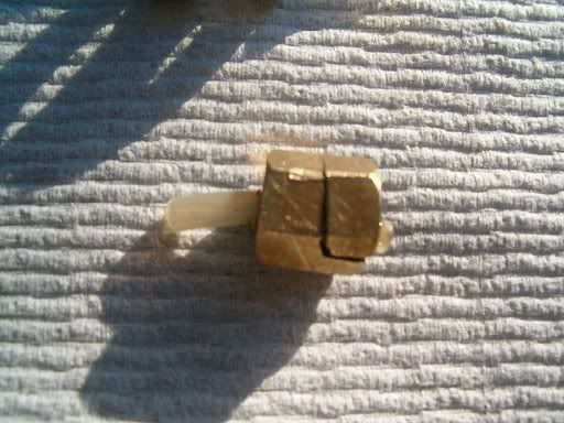

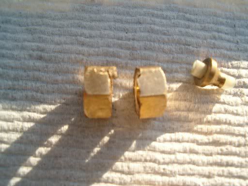

    yea thats my life lol.... oh and this i found this on my oil pressure gauge...
    So i put on a extra on i had and this happened while i was tighting it
    i hate hondas...
