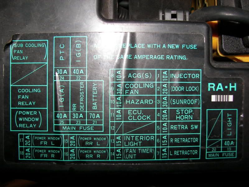

    Does anyone have a picture or drawing of it? Mine's missing from the box.

    Thanks, but I realized mine's probably not the same... I'd need one from an EDM with 4w ALB. And if it's different depending on if it's got an A20A or B20A, I need the B20A(8).
    Hmm... Am I asking for too much here? :P

    no real dif i dont think the 2bo had a dif fuse box and the only dif on mine is im carbed lol
    and as you can see the thing still has the ecu/sunroof/injectors lol you might want to look to saee if you have #20 & #12 and the one inbetween the fan relays lol
    also that pic was taken from the passenger side fender just so you know the placement

    just replace all the blown ones

    I'm gonna compare the pic with mine when I get the car back from it's rust removal operation. It had some nasty holes in it.
    I still think there should be an ALB fuse there somewhere, there's one in the inside fusebox but I read something in the shop manual about an ALB 2 fuse...
    The fixed headlights wouldn't need any retracting either, so I'm guessing those fuses are different too...
