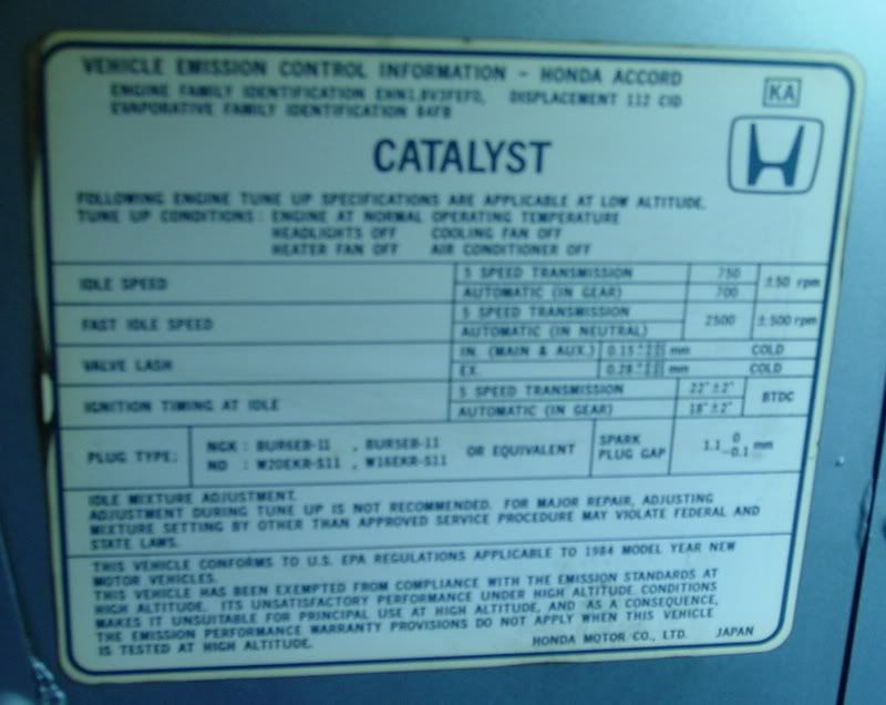

    2ndGenGuy
    Guest
    Re: black box, high idle.
    Thought you might like to see these off of my car...
    DX User Boltgunner's Avatar
    Jan 2007
    1984 Accord Sedan
    Lake Jackson, Texas
    85
    I have been an engineer for 28 years, and I have NEVER seen a more desperate design than the one illustrated in the above decals...

    LX User Lil Mike's Avatar
    Toronto, Ontario
    363
    thanks very helpful with the second picture but the first
