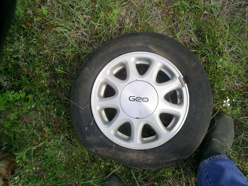

    well at least two of them,have to locate two more, these are from a 94 geo prism, they just need some minor work to make the center hole bigger, and some paint,and of course to get rid of the geo logo in the middle. it's painted on not cast. i need to take maby a 32nd out of the center,going to machine it off, but it could be done with a flap wheel and die grinder if needed.

    why not? they are lightweight 14 inch alloys. i think i might paint them that gloss primer gray.

    well i think they will look different painted and actually on the car. too shiny now.

    this is what they look like off the car with no tire and no center cap

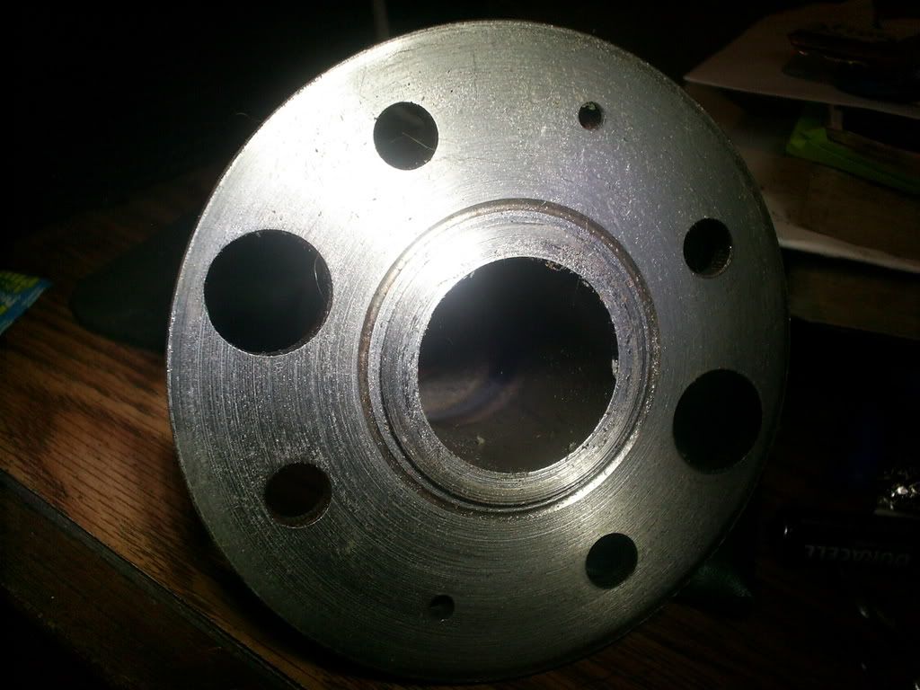

    does anyone know if the rear hub wheel bearing can be removed? i need to make an adaptor to machine out those center holes,and i need to get the bearing out of an old rear hub. have to chuck up the entire rim in the lathe so i can take around a 32nd out of each center hole.
    Re: new wheels
    oh i did finally get the bearing out,well sort of. the center part of the bearing cannot be removed. ball bearings and bearing centers can,but not the race the ball bearings roll in. it was a son of a bitch machining that bearing part to get this heavy tube through it. oh i think i'm going flat black on the wheels with graphite cutouts
