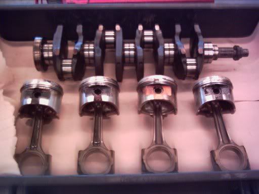

    Well i am building a turbo d16 motor from my research a20 rods are the same as ls rods but they have a 19mm wrist pin just like d series pistons and from what i read they are a little more beefy than the ls rods so yea im wondering if anyone has pics so i can see what they look like Thanks

    i dont think so
    we swap for ls rods lol

    Oh Really Damm So They Are weaker than the ls rods

    i believe so let me do a lil digging
    ya looks like it

    A20 rods snap just below the piston pin if you rev for long @ about 7k
    you really dont want them

    i really dont think the ls rods are that much stronger, the reason why guys go to LS rods is because its a drop in replacement for a20 rods when guys go with bigger wrist pin sizes with forged pistons.

    yeah the eagle rods are a good alternative choice...plus they are cheap

    exactly. A20 pistons are heavier than B18 pistons too
