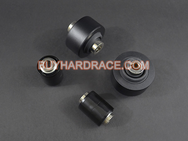

    I want to make it a project next year to rehab these. I m really into those pillow ball rod ends. All the OEM chassis are going to them. Just got to get a spare set to work with and ends that are close in size to retrofit in there.

    if your looking to use a factory style ball joint and have the arm look similar to the picture you posted id look into Delco P/n# 45k0090 that one should have the fatter end for the joint, the 45k0060 has a poly bushing on the body side but has a different cup for the ball joint. I used the 45k0090 on my hatch without a problem... a joint with a zerk tho is a different matter
