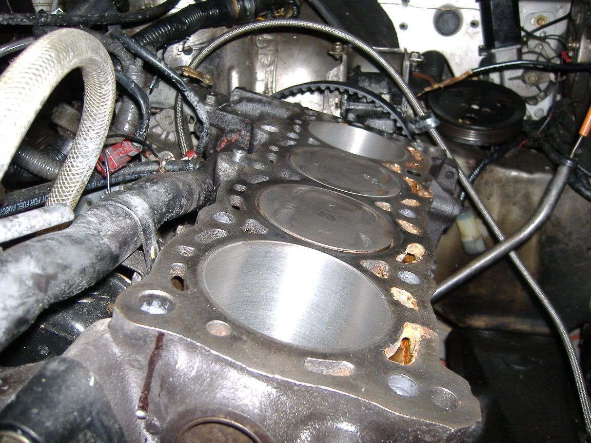

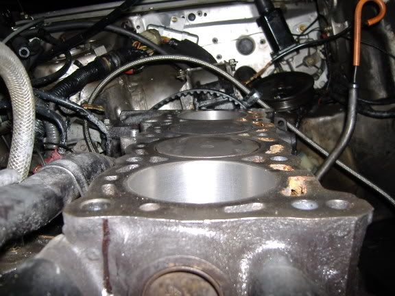

    alright well the reason i brought this whole thing up is i had a set of my friends old b18 rods and pistons sitting around and decided to see how they sit in are blocks and they look like they would fit PERFECTLY!!! And im serious... b18a/b pistons and rods seem to be the perfect height with are block/crank....
    on the left is the b18 piston/rod and on the right is the stock a20 piston/rod. The engine is at tdc...
    Remember these pistons are way too small for my bore so dont mind the big gap between the cyl walls and pistons but other then that they seem to be the perfect height!!
    Check it out!!!

    3Geez Veteran gfrg88's Avatar
    1986 Honda Prelude 2.0Si-T
    A Mile High.
    4,790
    Re: b18 rods fit perfect??
    THANK YOU ADAM!!!!!! ive been trying to see why that wouldnt work!!!! i always wanted to try that out but i didnt have any b18 parts to work with, but you just found out some great things for us!!!!!! looks like its time for me to start building an engine
    Quote Originally Posted by gfrg88
    lol no problem man!!! I couldnt belive it once i saw that they were perfect fit for us!! I dont understand how no one hadn't relized this before lol....

    SEi User
    Jan 2004
    1,396
    The only problem i can see is that the inlet valve relief pockets aren't quite in the right place, and also there is a deeper dish to the B18 piston so CR ratio will be lower especailly as the vlave relief pockets are really big too. I would order up a set without the valve relief pockets in just plain flat top and have just a 3 valve relief pockets machined into the right place to suit our heads, and obviously a 82.7 or 83mm size piston to fit our blocks and that would be perfect best CR for NA guys or if you are running turbo then have a Deep dish machined into the top to drop the CR ratio and have the valve relief pockets machined so they fit with the valves although with Turbo guy's running less duration and lift shouldn't be too much of a problem with vlaves hitting pistons anyway.
    the stock pistons have 4 valve reliefs, not sure if they are in the exact same spot as the b-series pistons or not, but it would be easy enough to check visually.
    since you can order b-series pistons in particular sizes, like 83mm, this does open up a lot of options, but we have to keep in mind we don't know what the real CR would be. maybe a quick call to diamond would help figure this out. if they ended up making us custom 'b-series' pistons it would probably be cheaper anyway.
    this is cool news though.
    yea im pretty sure the valve reliefs wont be too much of a problem though, in my case atleast... I would be using mostlikely low compression dished ones so there will be even more room for the valves... But im pretty sure even with comparing the 2 pistons the way they are in the block the valves wouldnt hit... I have put pistons in my old b20 where the valve reliefs were WAY different and it didnt give me a problem at all! I cant be positive though but i dont see it affecting us unless we get high compression ones where it has a domed shaped to it.
    id bust out a micrometer and see how much the difference really is in the pin height from the top face of the piston, it looks slightly different to me but maybe its just the pic/angle or the fact that its not the right bore lol. Can you measure them and post a pic side by side comparing the pin heights in the pistons adam? And yea, to make this even semi viable somebody needs to sit down and play doh the piston and see where the valves are gonna end up and if they are gonna hit, since the reliefs are much different.
