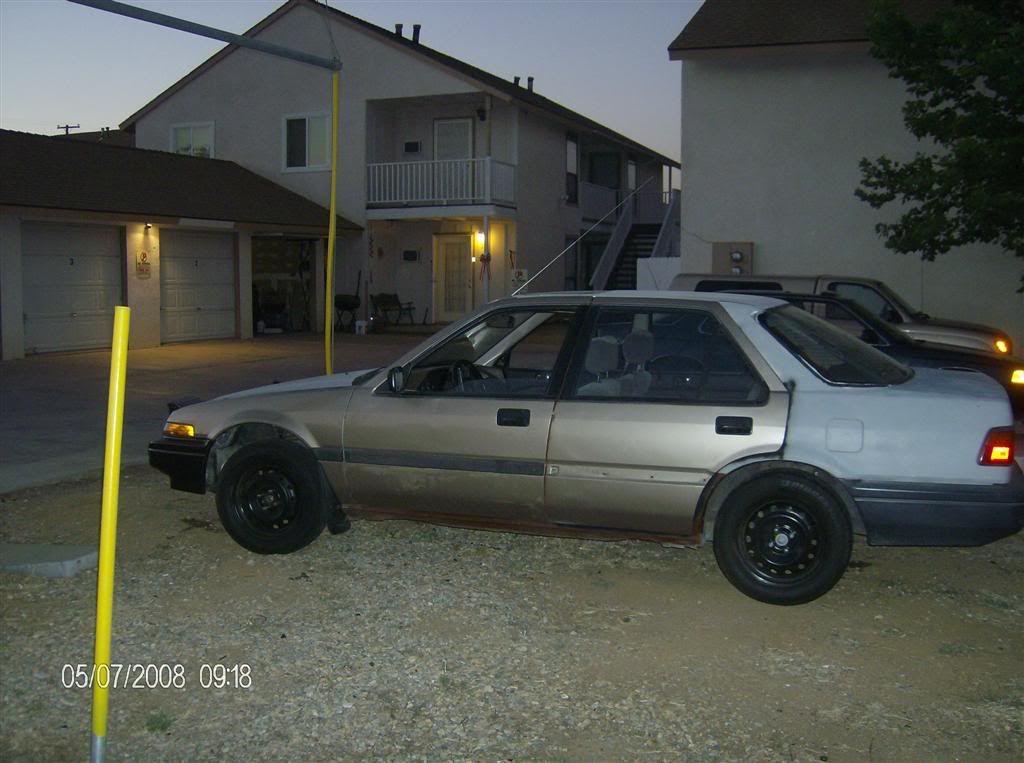

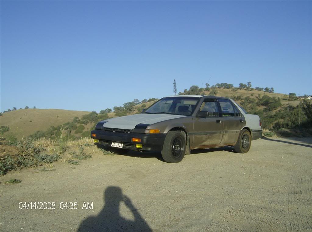

    heres a pic for yall who have not seen how it looks now

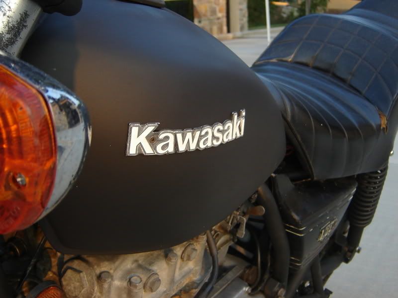

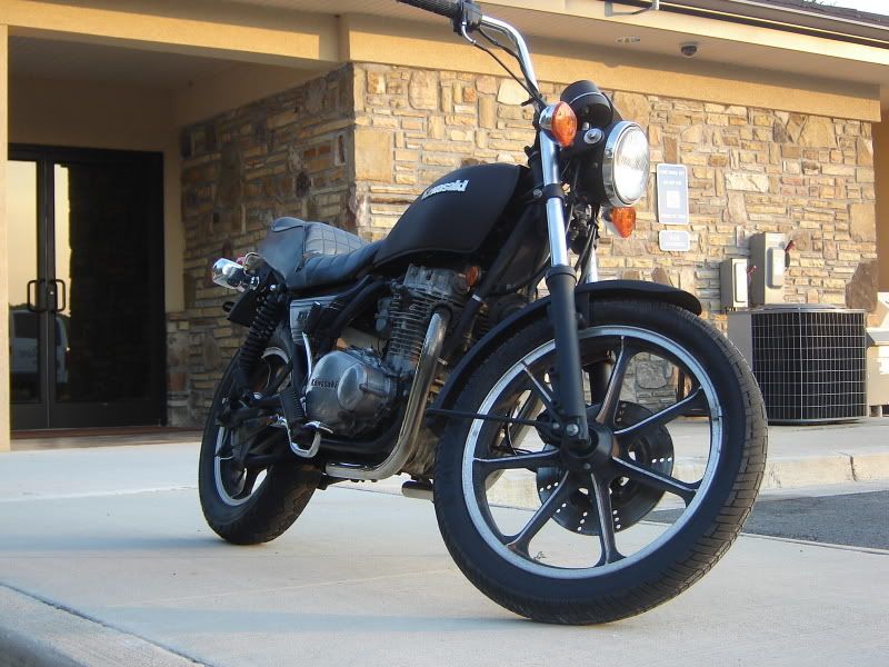

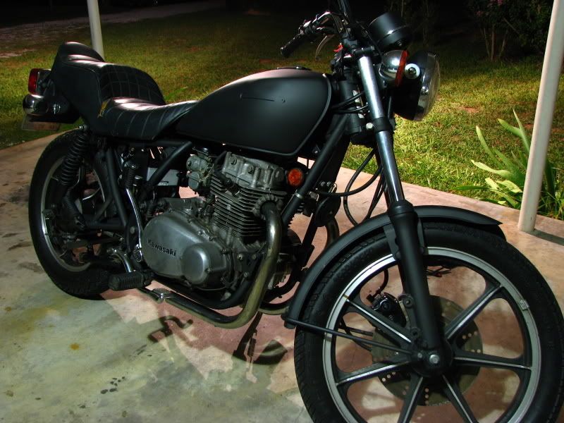

    DO the flat but do it right. Mask off everything sand with finer and finer grit. Primer 2- or 3 coats with rustoleum then 2-4 coats with flat black by rustoleum works best. If I were you Id take all the major panels like the fenders, and hood, etc off and spray them separately hanging in the air. If you do it right it will turn out like this, without the regular paint spray marks in most peoples flat jobs.
    A good flat job WILL show lots of dust so make sure you wash it regularly. Top pics have maybe a days worth of dust on them and bottom is right after a good cleaning.
