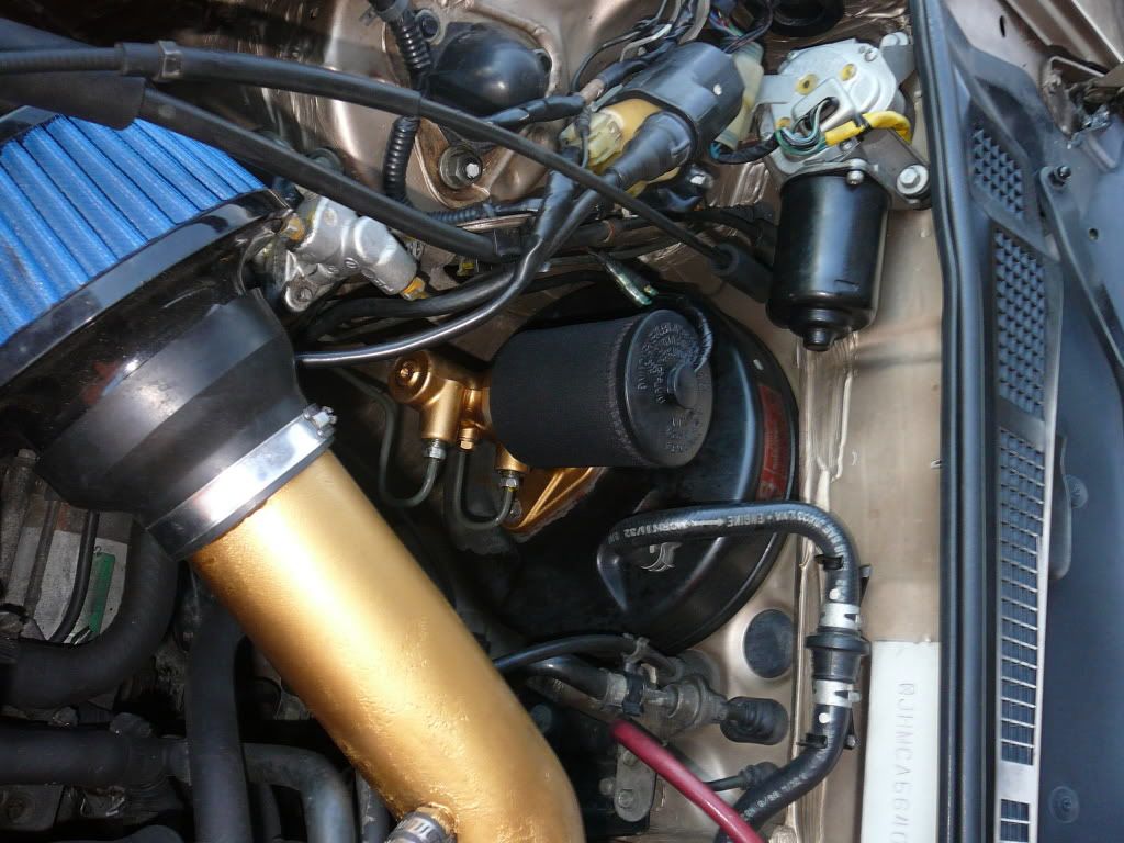

    so did the master cylinder today it was a piece of piss...bled the bastard before i put it on...hardest bit was taking off the mags to bleed them all...bled a whole bottle of black shit from the brakes and flushed them....fuck it was easy...saved my self $120 in the process....and yes stubie holders make awesome catch rags on the mc......

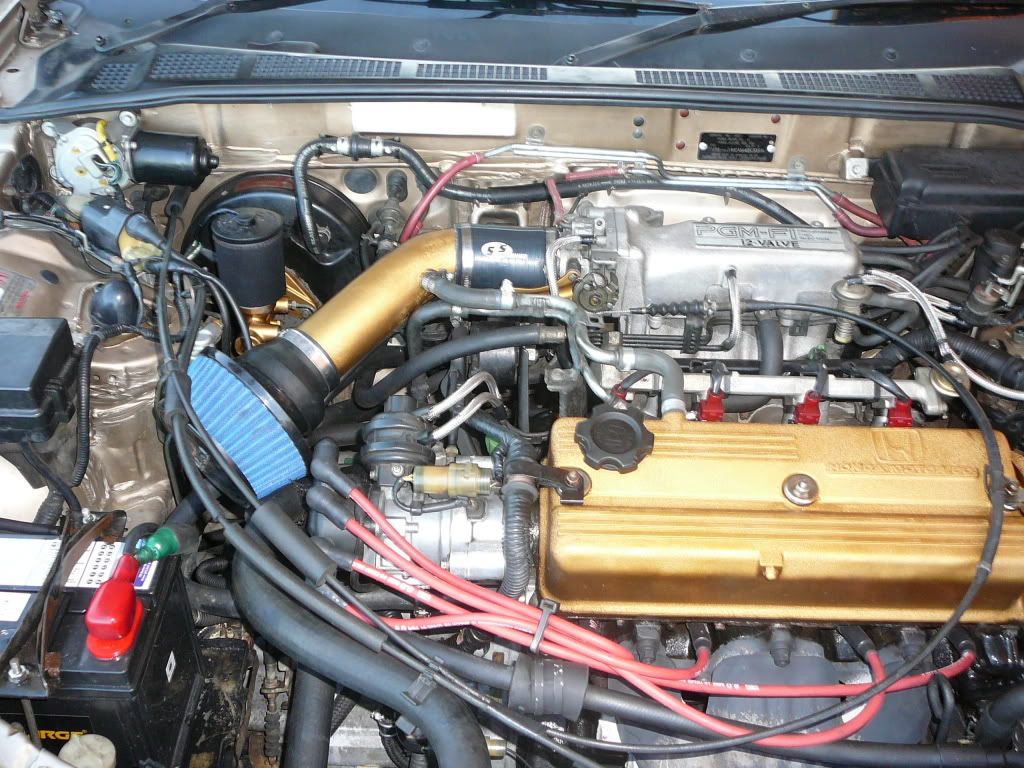

    day shot of 17cl15vn plus t23 bracket on stock disks
    integra king springs...would they fit? any one know? b18 cant be that much lighter?
    interior of the dohc accord

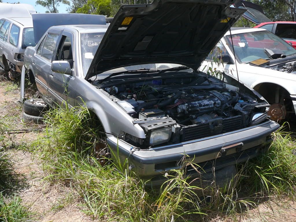

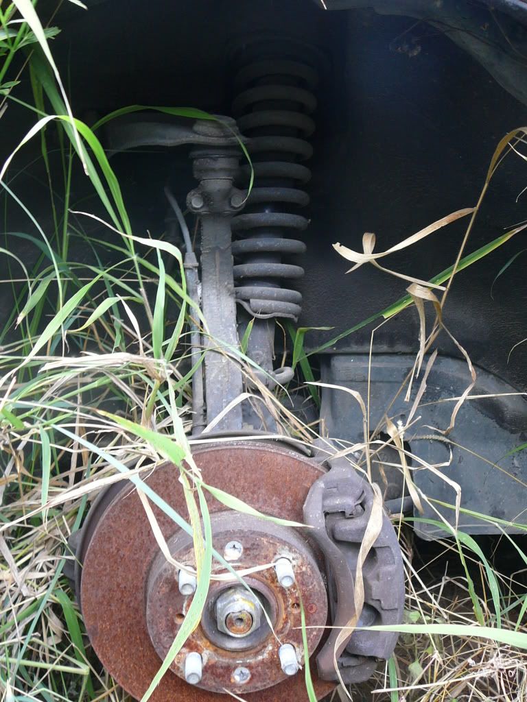

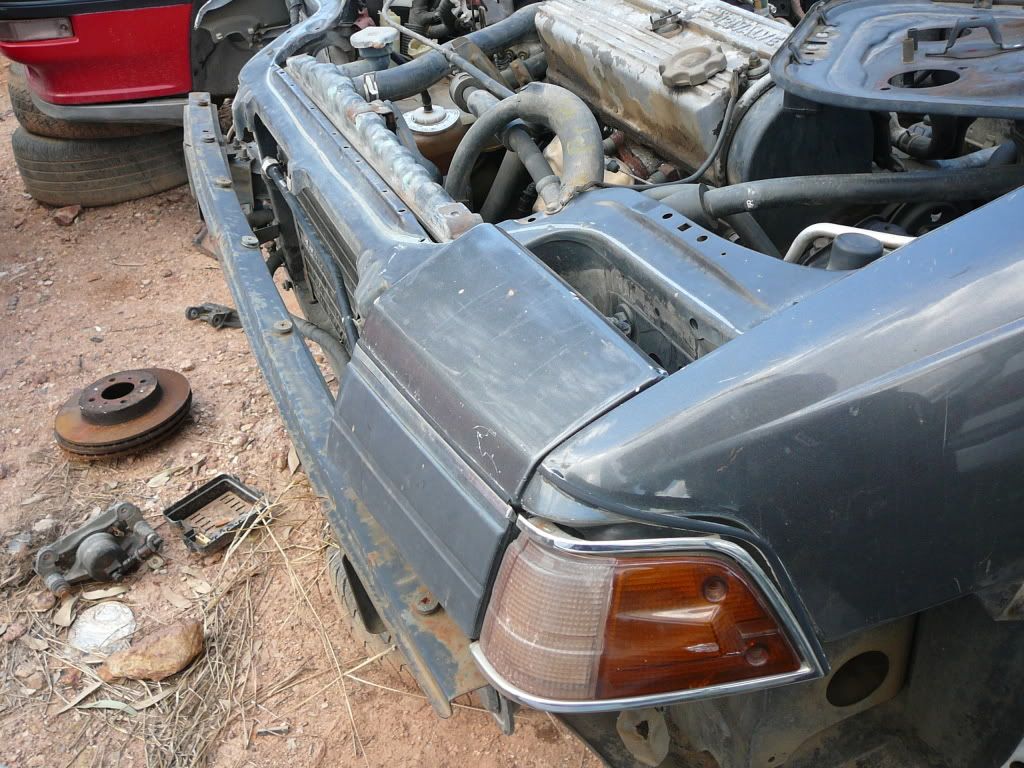

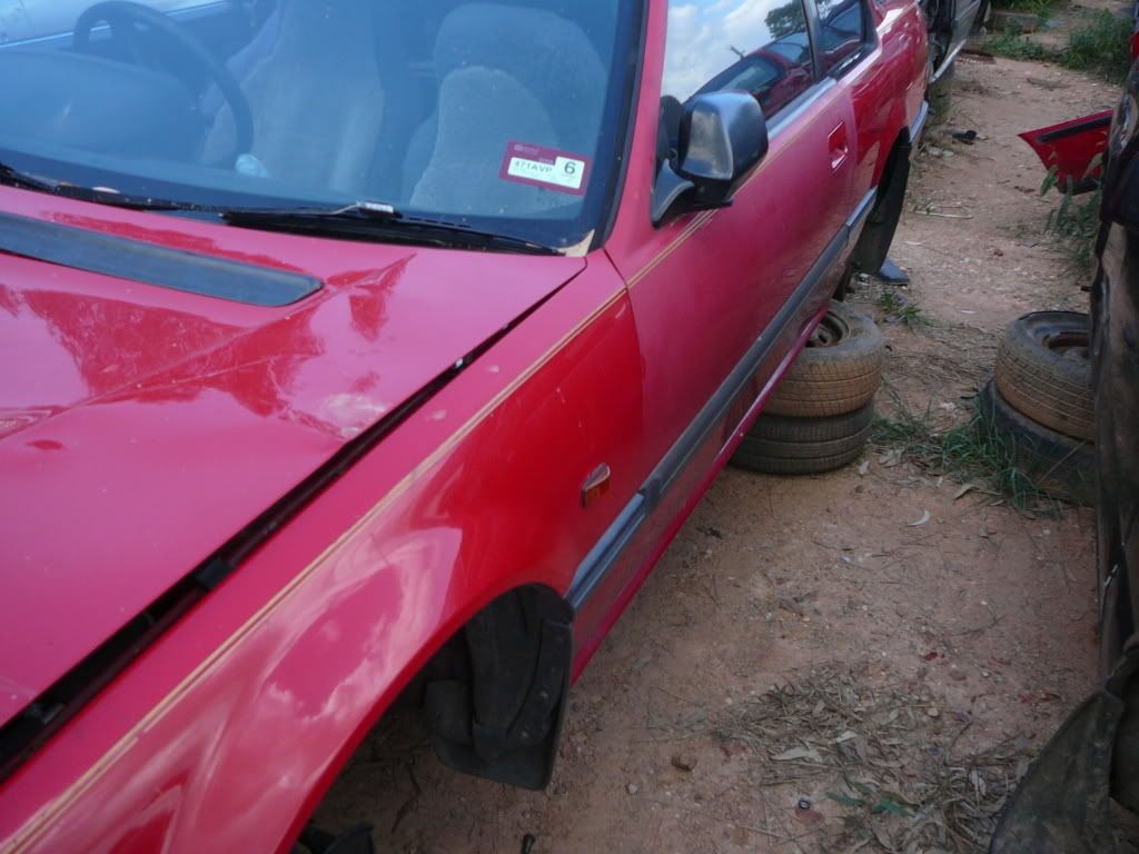

    so went to the junkyard today...it was raining so i couldnt do all i wanted to....pulled some 25t brackets, the visors from that doch accord and a front lip from an integra ls/sx 16 88 89 ish......visors are sweet and are on the car already...
    the lip looks ok needs a bath in the rain and a coat of black...think its a little narrow accross the car and a bit long on the sides....itl be sweet so flimsy it should bend the new curve anyway with a little help...got some foggies to wire when i pull the bumper off also....couldnt find an original switch though...just have to put another out of site for the time being...

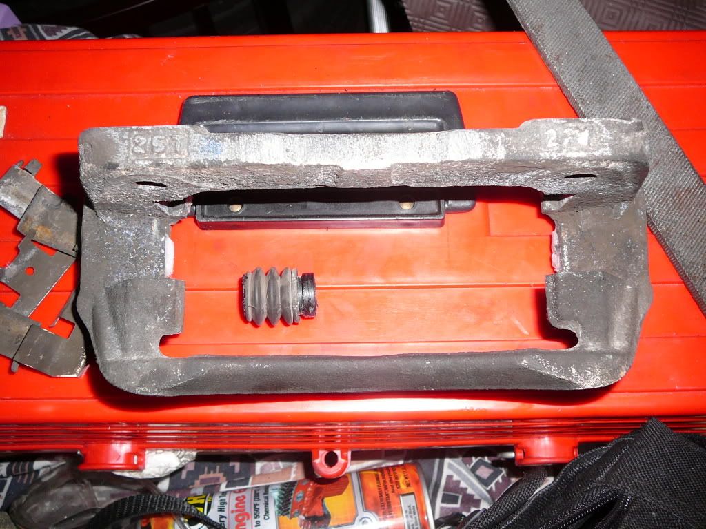

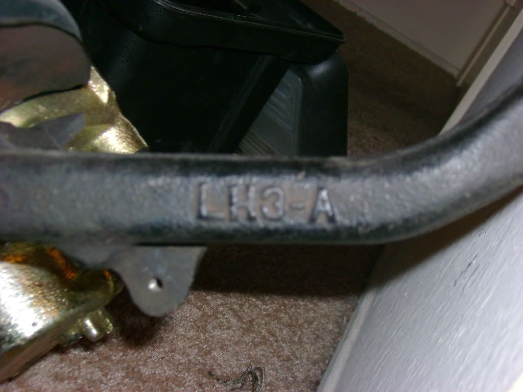

    so was hoping to fit the brakes up but no suprise they didnt fit...turns out the 25t brackets are exactly the same casting and everything as the t23 i could probably make them fit i guess
    oldblueaccord could you please do me a huge favor and look at the t marking on your bracket? if theyr the 23 or the 25 my hubs must be wrong? but they should right be since i have 4w disks? driving me crazy...

    ok so i found out that the t markings refer to the thickness of the disks that are used and the brackets offset...any way measured the disks and they are 9.5 inch so im thinking i will be hunting for the bigger knuckles off the lx-i or australian equivilant..what a fuck around...guess thats what happens when u assume....
    if i cant find the right ones on an accord i guess ill have to find them on the 85-87 prelude or something.. should be fun no doubt...does any one know what disks the jap spec b20a came with? would they be the bigger knuckles? might be able to get them from the wreck below

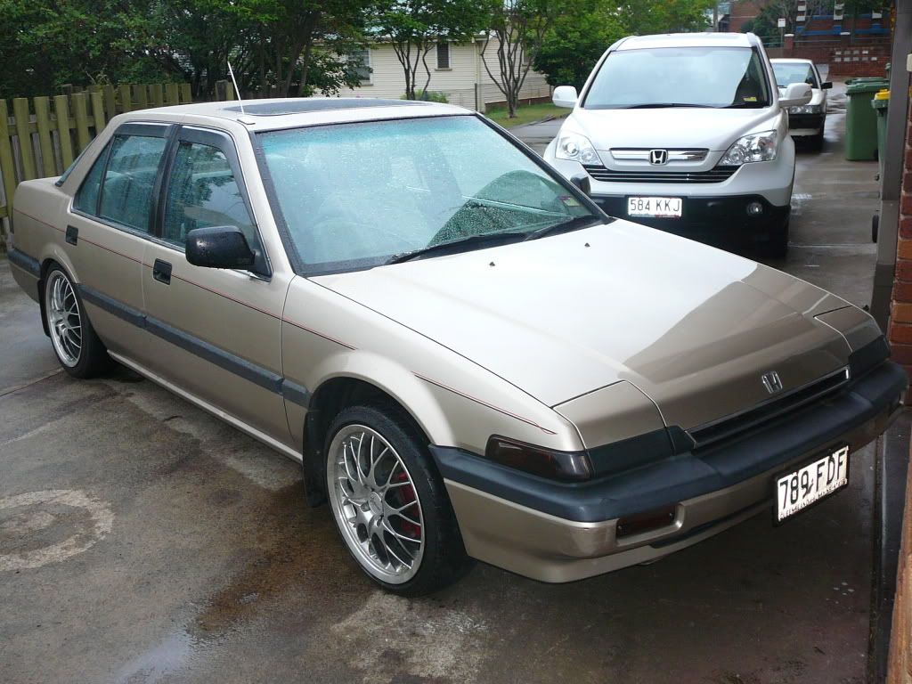

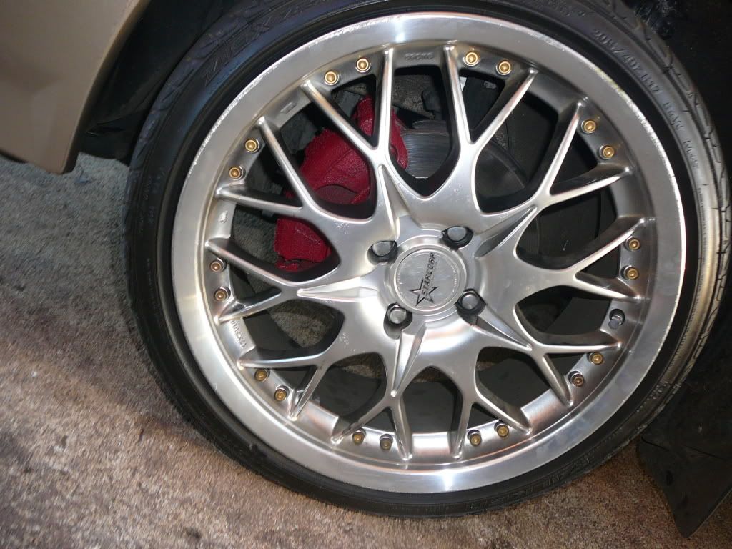

    sorry this is unrealated to your post, but. I love thos rims, What are they and what size? whats the price. Also a 20% tint will make your car look complete.
    May 2008
    88 accord Si
    56
    Re: 11 inch front rotor + legend calipers
    cheers budy...yeah if you scroll down theres a flick of them up close....they are 17s with 205/40zr17s on them....cost me 350 second hand..they are single piece starcorp le mans style rims....

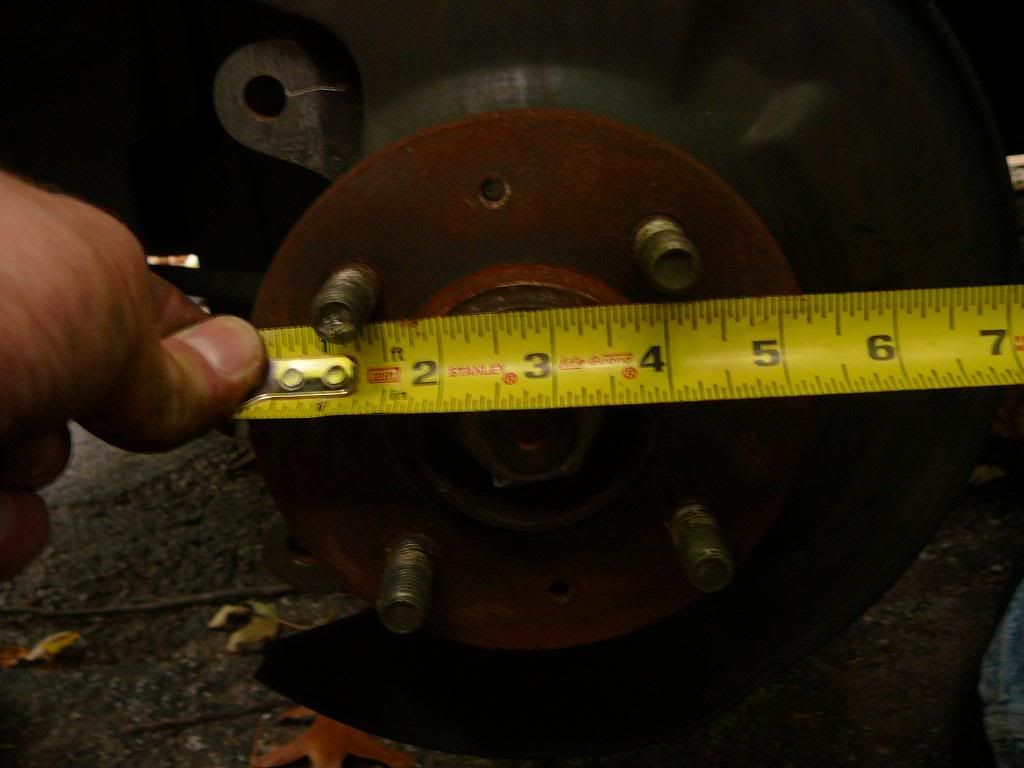

    yep put the tape measure straight across the centre so it comes out between the tabs where the caliper bracket bolts to....and a flick of the numbers...just grab a piece of sand paper and rough them up...
    heres the code on the ex knuckles so you get the idea
    http://i256.photobucket.com/albums/h...0/DSC00254.jpg
    grab flicks of the setup all together and as you pull it apart as well..is that all good?

    Hey guy sorry I forgot about you.I have the aftermarket brackets they don't have the T- number on them.
    I think you need to re=look at what you are trying to do with what parts you have. You got a rotor that works. get the stats(measurements) off it and try and match it to a bracket/ caliper set up. Don't get to hung up with some of the factory parts numbers there just not as good as a guide as you think.
    You may be better off with an aftermarket setup thats available there then messing with parts that you may never find in a junkyard or never were even available over there.

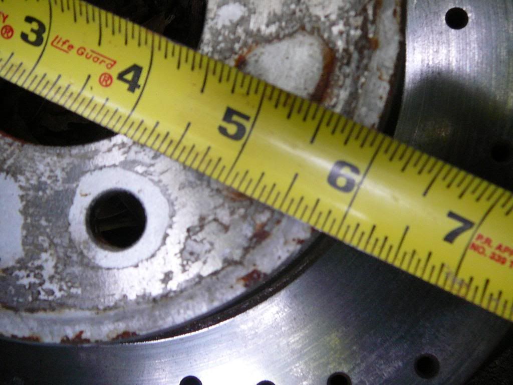

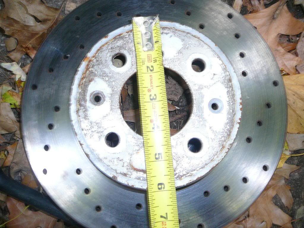

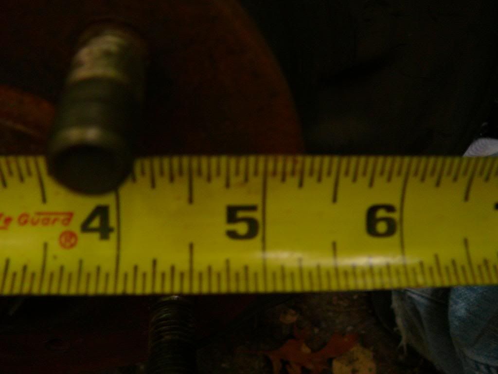

    http://i168.photobucket.com/albums/u...6/P1050701.jpg
    Hub ^^
    http://i168.photobucket.com/albums/u...6/P1050702.jpg
    Hub Zoomed in ^^
    http://i168.photobucket.com/albums/u...6/P1050703.jpg
    Rotor ^^^^
    http://i168.photobucket.com/albums/u...6/P1050706.jpg
    Rotor Zoomed ^^^

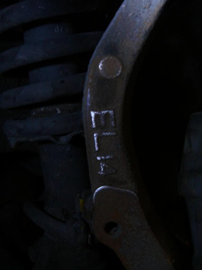

    http://i168.photobucket.com/albums/u...6/P1050723.jpg
    Knuckle Number ^^^^
    i made Links b/c i had the low bandwidth users in mind
    on the knuckle i dont know its its EL I4 or if that was an EL 14, :/

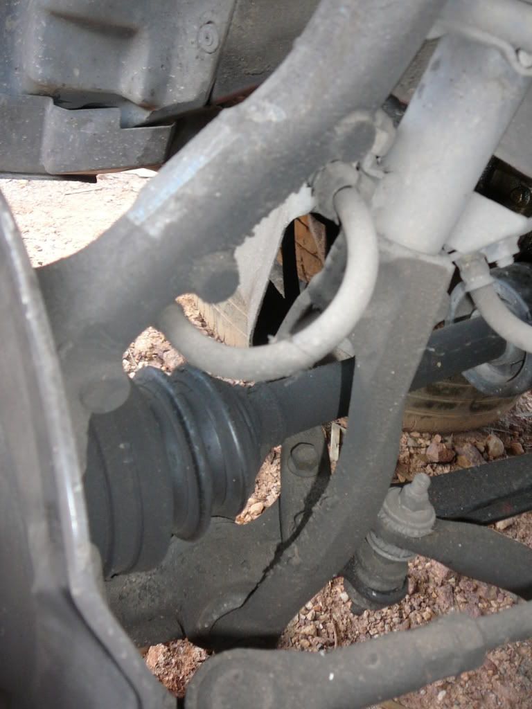

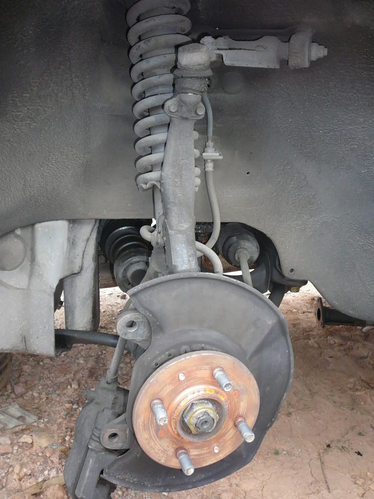

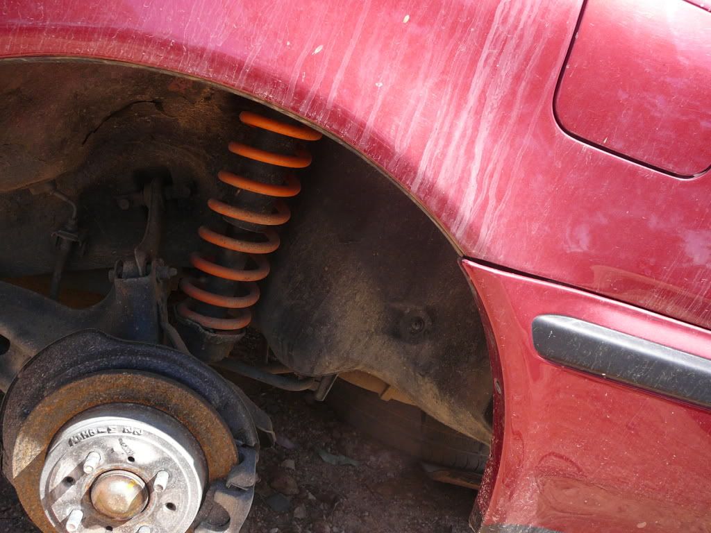

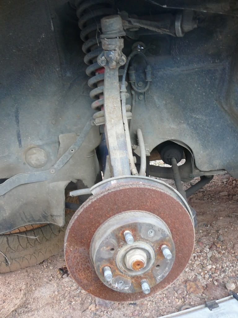

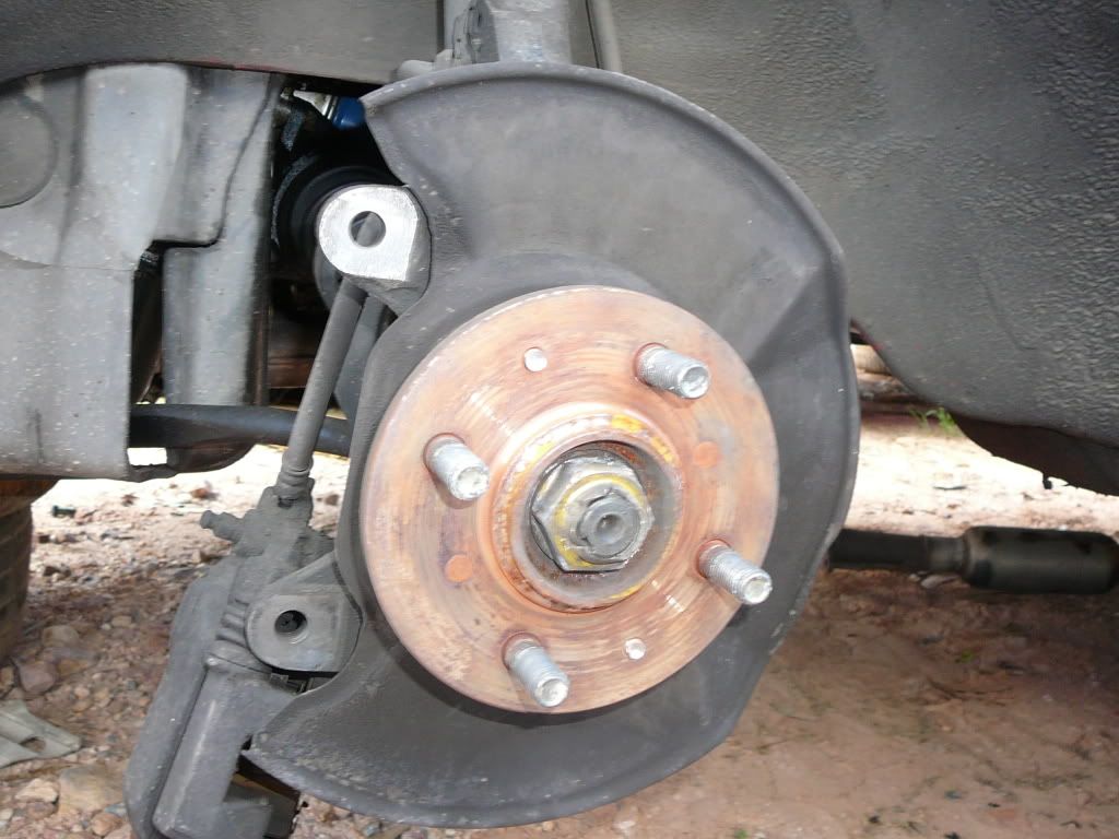

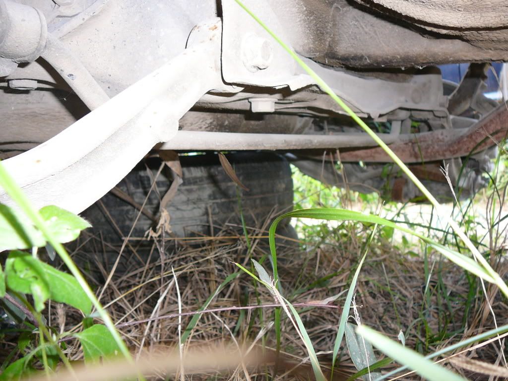

    got 10.3 disks from an 88 lude today and took a few photos for r&d...
    wagon 92 rear bar, i noticed that the white accord hatch below is actually a vigor...i was too busy looking at the motor lol....getting the rear garnish next time...are all the sway bars bigger from this model? shall measure next time...
    88 lude suspension after removing disks...looks like it would fit...remembered that the strut bolt to the lower arm not the nuckle...what you reckon? front prelude knuckle conversion....maybe?
    85-87 front suspension...pretty much the same as accord but small disks
    88 2.0 si suspension with twin piston calipers but still 9.5ish disks...really hard to measure without taking them off though...
    anyway check accord pics for the rest of the shit i got...

    the 3 side by side
