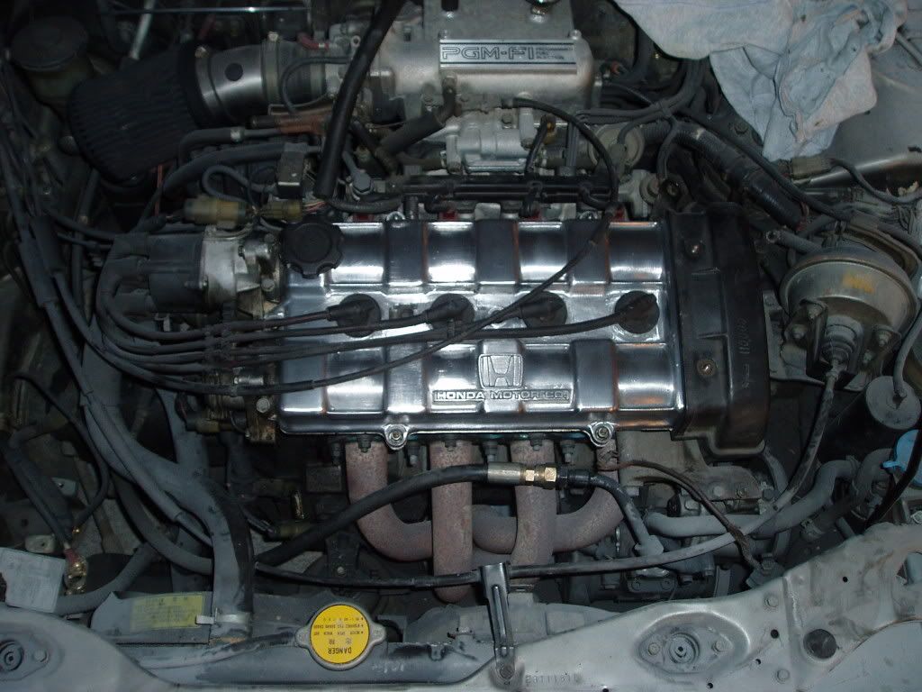

    heres a quick pic of my headers.
    nice, simple design that works well
