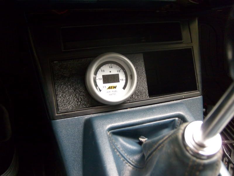

    Okay here you go. Here are pics of my AEM WBO2 setup:

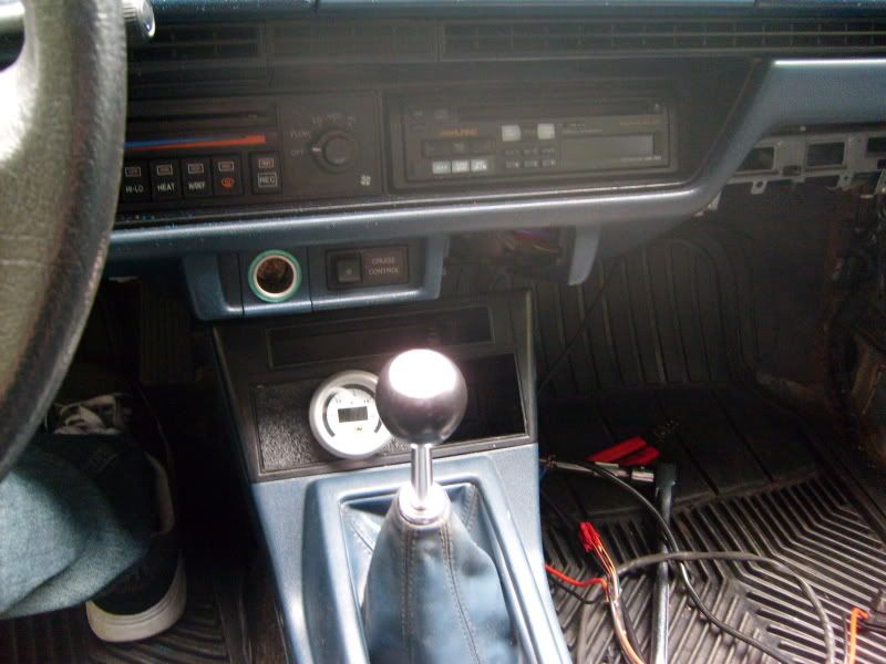

    And in this pic you get a broader view. You can see there is still no interior in the car, the center console is just kinda hanging out, it's kind of a big state of disarray. But you get the idea. Also, my fucking sweet ass 1995 model Alpine I found in the wrecking yard, already in an 84 Accord with the proper dash harness already soldered up properly. Looks nice and sounds clean. Great for $25. No blue flashing face plate sliding / WMA / MP3 / OMG bullshit that just takes away from the actual quality of the unit.
