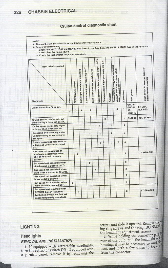

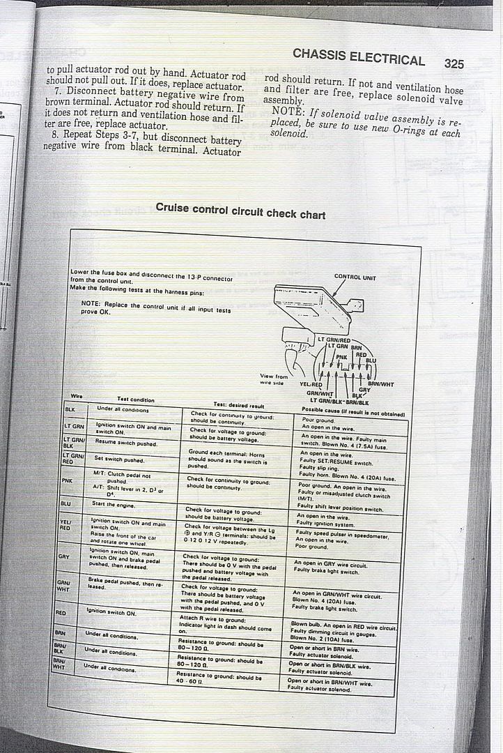

ok here are the scans from my 73- to -88 chiltons honda book,this book is out of print now and is hard to find,but if you find it hold on to it.
my scanner isn't the best, so you may have to use maginifer. hope everything can be read
cruise control scans
