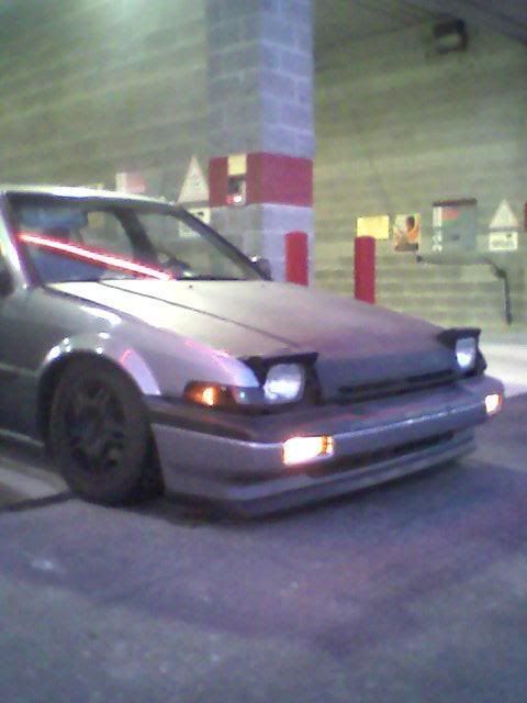

    you liked my idea alot didnt you dewd heres how it should look

    Quote Originally Posted by Sik_sohc View Post
    Yeah dude I love it, it's gonna look sick with my yellow fogs.
