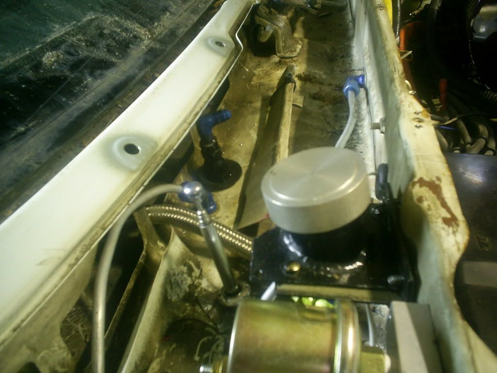

    some more stuff done ,about to finish up under the dash area. inside of the cowl area, i just ran the bulkhead fitting for the washer fluid. all i need to do is run the tube down to the other end. You can see the antenna hidden in there,it will come up through the cowl, and through a small hole in the back edge of the hood. I have an interlock system with the hood pin switch, it won't move with the hood raised, and if i pop the hood it retracts.

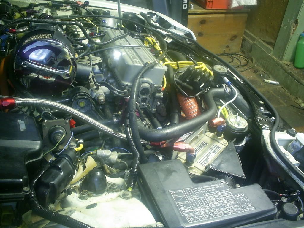

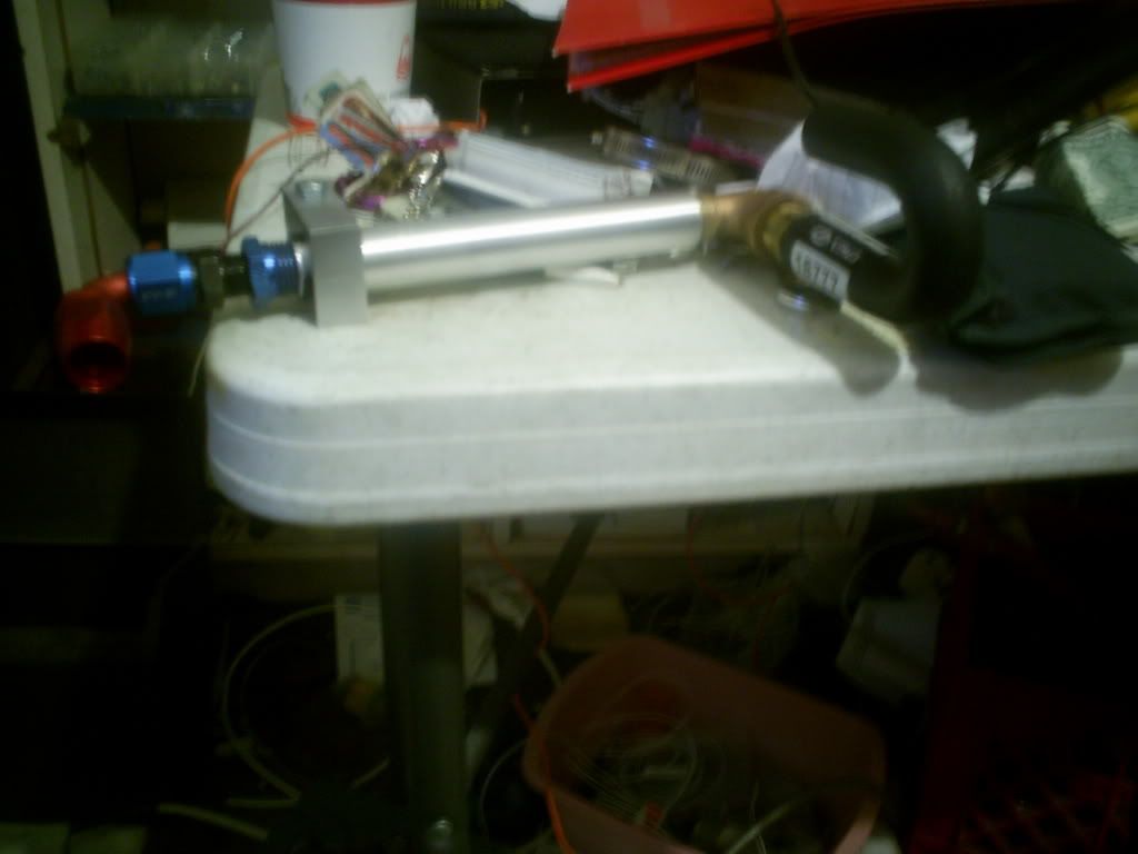

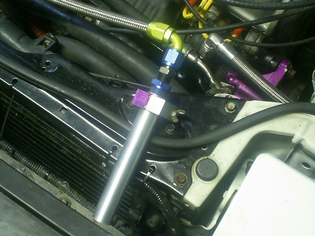

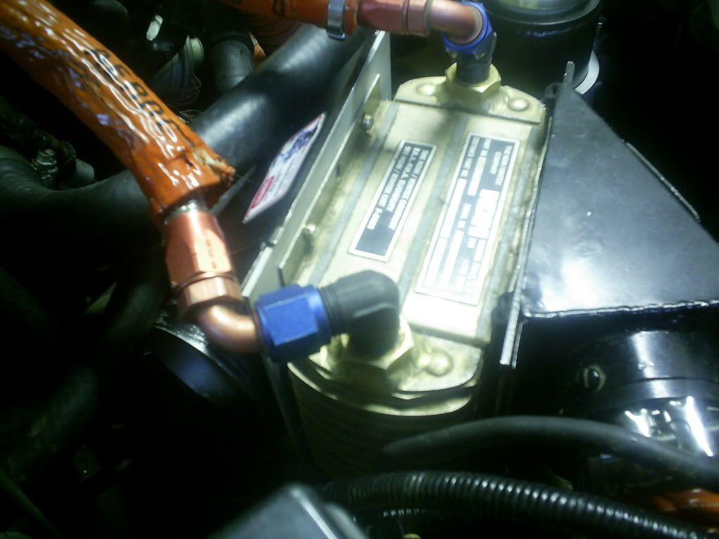

    picture of the oil cooler,i will change those fittings on the top of it to straight ones later, i was just fitting it in there.

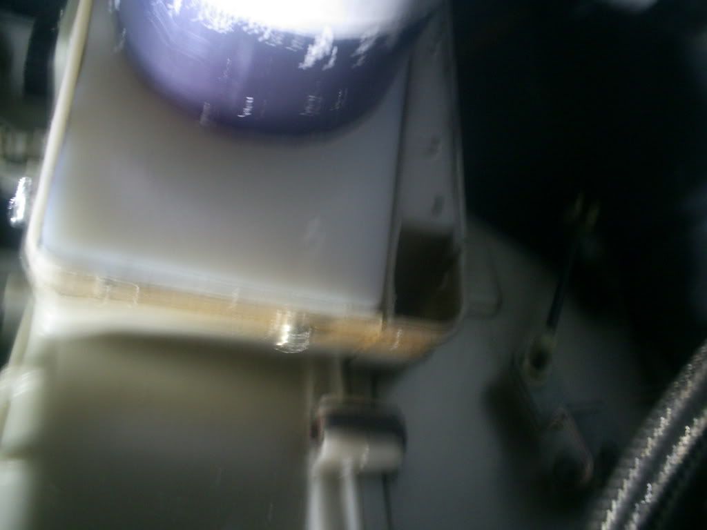

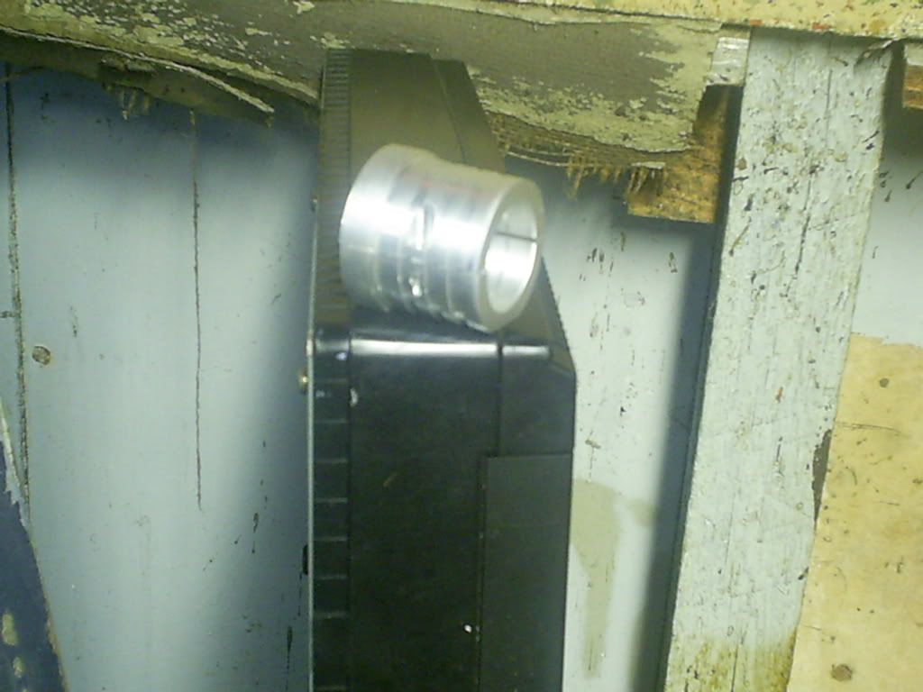

    better picture of the radiator resevoir tank.

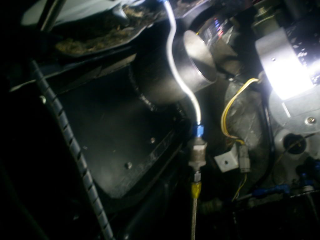

    I removed the AC condenser, ac is junk anyway, hasn't worked in a decade. this is the heater box side of the adaptor, it connects to the heater blower with 3 inch silicone hose

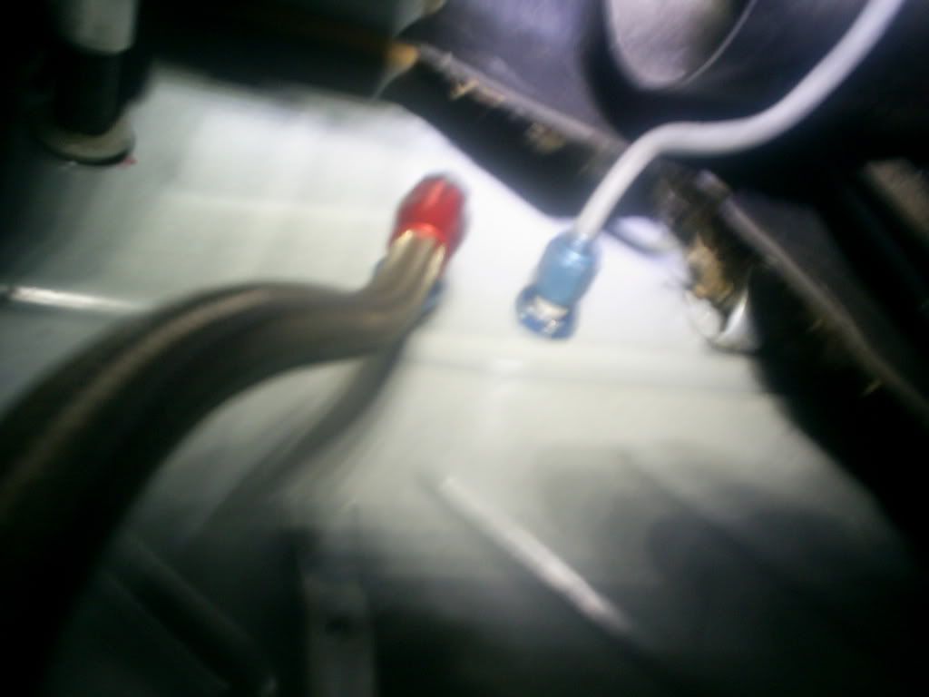

    oil pressure bulkhead fitting and washer fluid bulkhead fitting
    this is the blower end where the hose goes, the adaptor is a really hard nylon material with an aluminum tube.

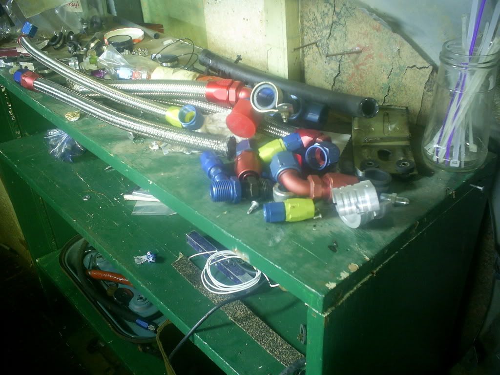

    what i've been staring at all week

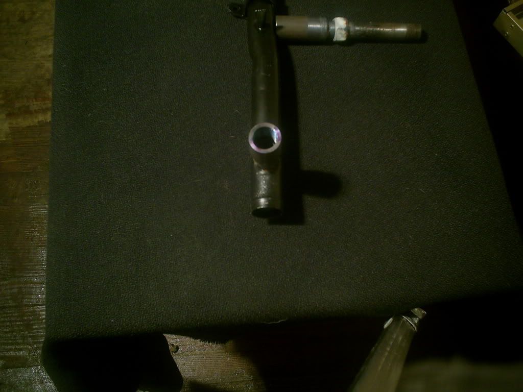

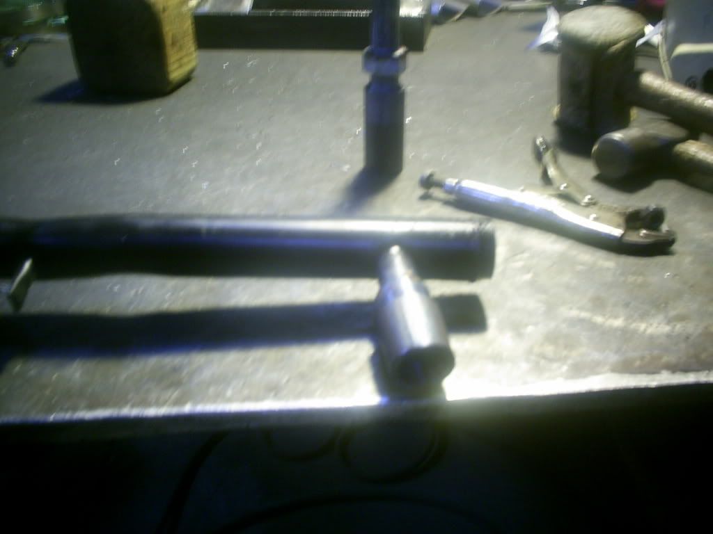

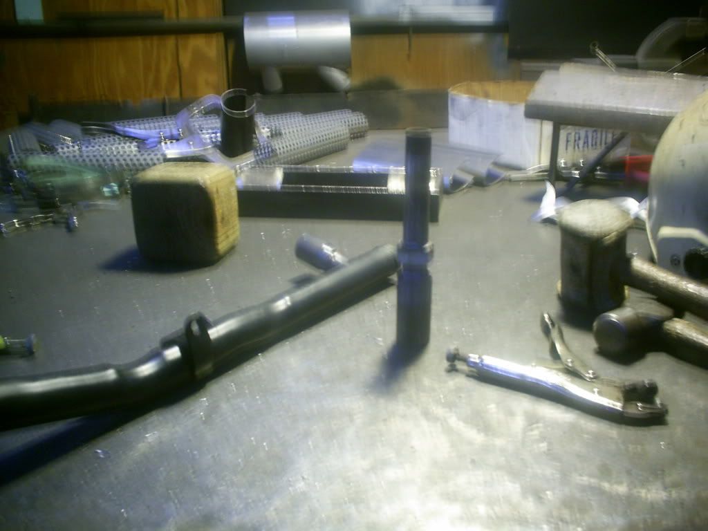

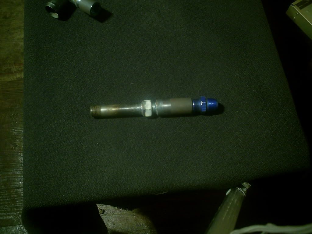

    Ok first coolant hose about to be replaced, this is the one from the cyl head to one side of the heat control valve, i wanted to run all braided line, but there has to be some small pieces of rubber hose to the heat control valve. my solution is simple,run braided line to the firewall,drop it down to near the heater with a down pipe,and connect to the valve. but i never do anything half ass.
    first attempt at the down pipe, was fine, was cleaning up the welds and the tool caught a weld. FAIL
    second piece, split clamp with two pieces, was fine, was drilling the holes,part slipped in the mill and the cutter gouged across the surface. turned it down some more, then it was too thin for the threads. FAIL
    third attempt, had a two piece clamp for holding the PS and AC hoses over the manifold, it's obsolete now because I got rid of the AC, hacked it in half with a cut off wheel in the angle grinder, it fit,so i machined it down at work.
    I made the down pipe from a solid piece of aluminum I bored out, then threaded it to 1/2 NPT threads. yop piece is an AN adaptor with a reducer, bottom had to use a brass street elbow to get the connection I wanted, goes to a barb fitting for the heater hose. I didn't need to use the bend,I rotated the entire thing, and used a piece of existing heater hose. the two studs get nuts at the inside of the firewall. not sure about the other part of the heater hose yet,i need to measure it, if it's a standard diameter, i can use a compression fitting after cutting off the flare. I hope it's just a little big,thenm i can machine out the brass ferule to make it work.

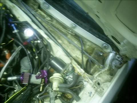

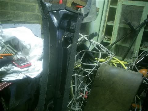

    Re: more plumbing done

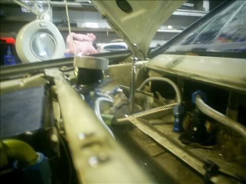

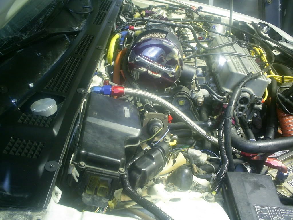

    ok the cowl cover is ready to go back on,everything is tight. I'm putting nut plates on the back hold down holes now,no more plastic fasteners.
    back of cowl cover, i have all the weatherstripping on
    all plumbing is in and the antenna is in

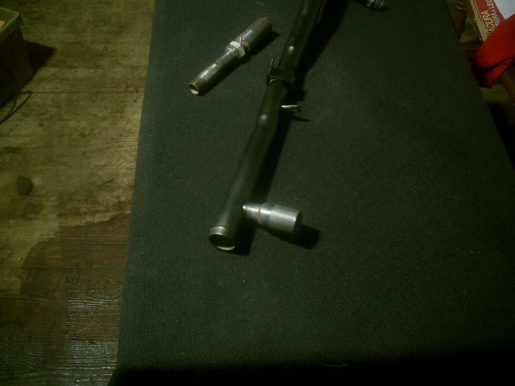

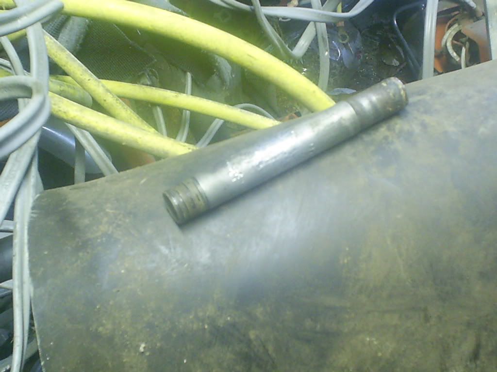

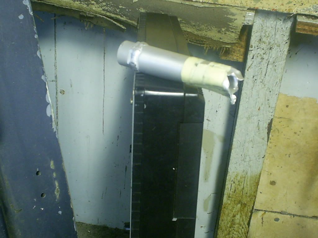

    ok the pieces for the cooling system are done, thanks to Davie Maule for help with the TIG welding.
    [b]this is the water pipe out of the cyl head, I had to fabricate a steel piece with 1/2 npt threads that went over the end of this,and got welded on. I also took a nut,bored out the threads,and pressed it over the piece,then welded it on. this will give me a way to screw it back in. All the other eighties hondas i saw had water pipes with hexes to screw them in. except this car. had to take it out with a pipe wrench.
    cut one of the welded on pieces off of the water pipe, again, changed it to a 1/2 inch npt, I think the smaller threads were too small and would have restricted water going to the heater core.
