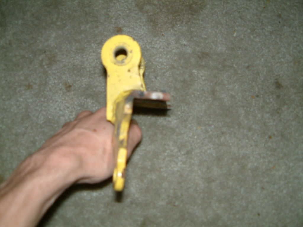

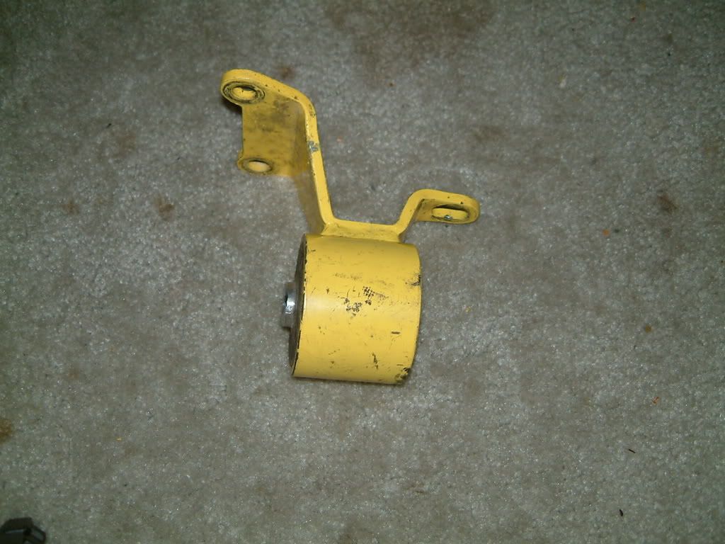

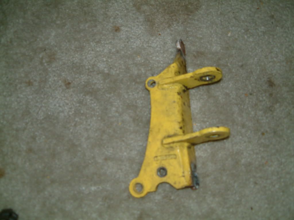

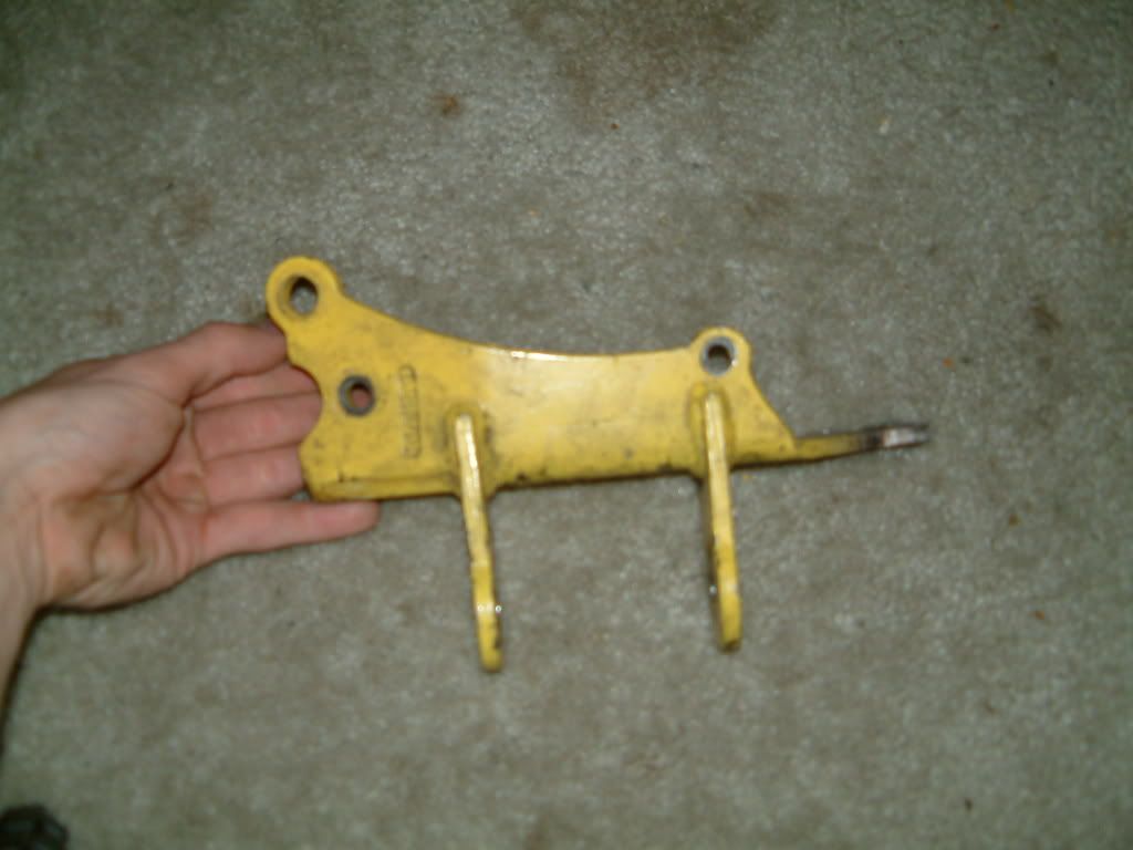

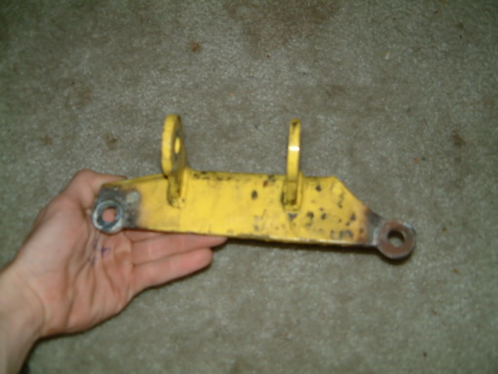

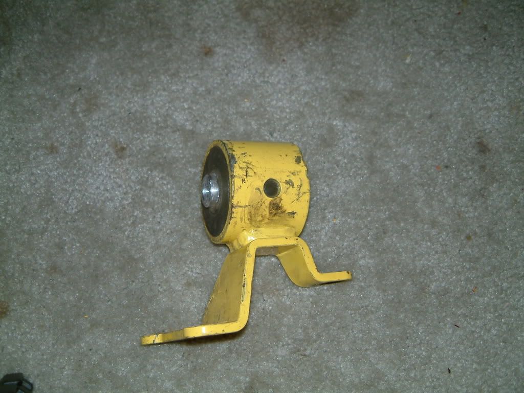

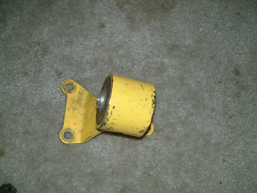

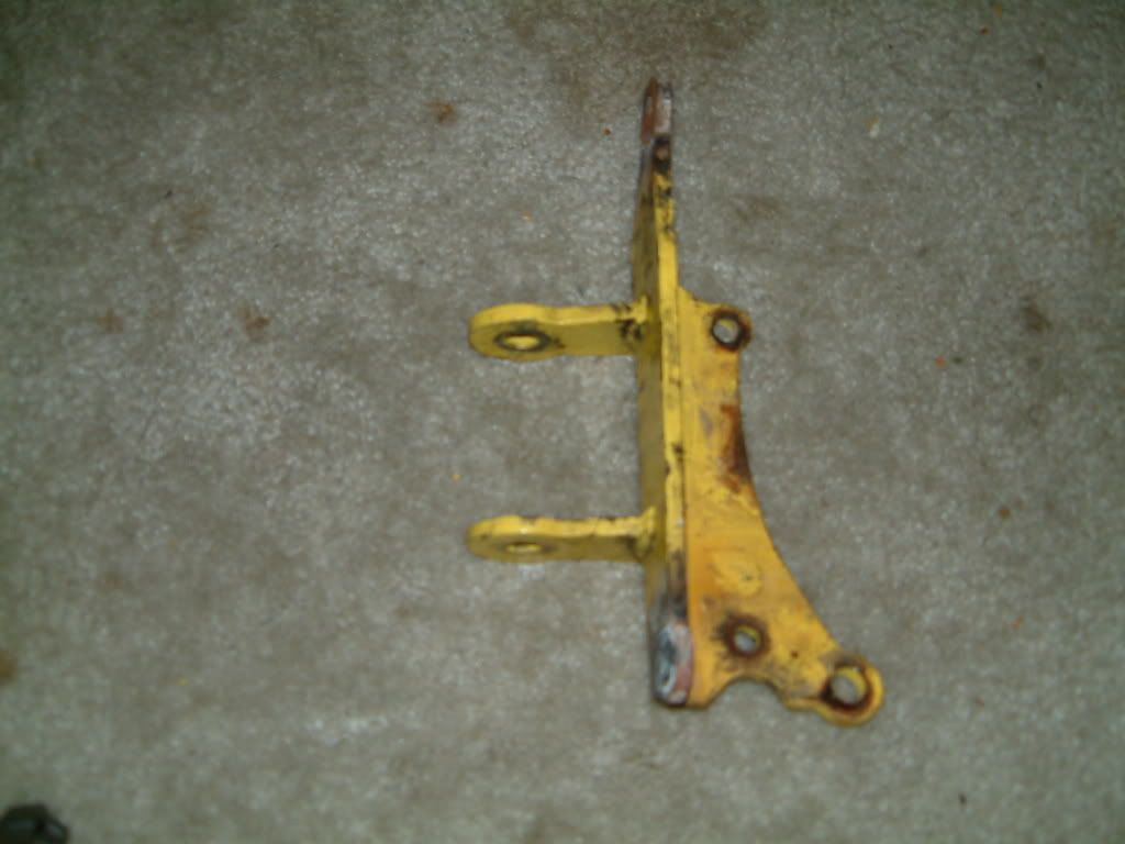

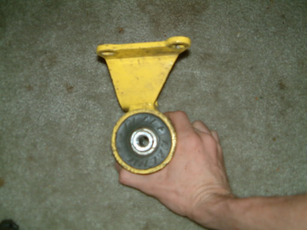

    Its sad to hear that people would be hiding things like that, I mean this is a forum where we share everything and try and help each other out? It would be nice if we could get someone to fab us up some mounts to distribute among the members for a decent price, someone could make a very nice profit and everyone would be happy. Hell I would buy a 2nd 3gee that is just a rolling chassis to swap all that into if mounts were easily obtainable.
    Re: Vtec possibilities...
    i accidently closed the link to the rest of the pics. oh well

    that did not happen in this thread did it? I mentioned BREIFLY the facts and as well a non insulting opinion on that fact, no names, no suggestions for anybody to do anything they don't want to do, and certainly no flame.
    And thank you A18A for posting those pictures so all can see how simple theses things are. Actually most of those are motor supports, not mounts. If you get a B18(c) or B16 from a donar car you will get the motor supports with it, all you need to do it get some angle iron and some flat bar to weld up the adaptation set up to the cradle you are working with, and use your motor mount (isolators) or some other isolator from another FWD car.
    The big cost of those PR mounts is the whole process of how they made them as a bolt in kit, materials (are those billet?) powder coating, etc.. This is not really the only way to do swaps, just the easiest.. and you pay for it.
