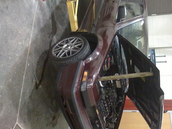

    After being like This for a while,

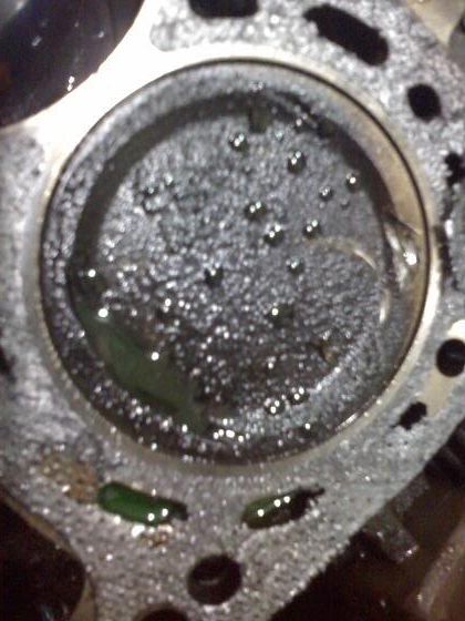

    i got the head off and found this:

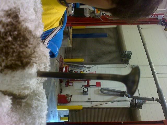

    This thing, did this:

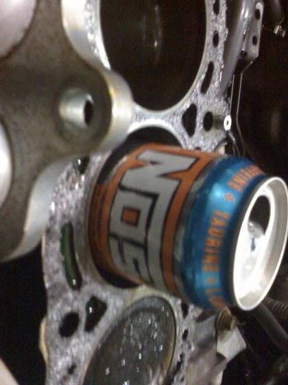

    and when its goes back together, im adding this:

    Damn so now you need a new piston too. That blows donkey balls.

    ^^ no i dont.... lol ziz wheel son...

    i think the valve may have hit the piston....

    is that a chunk out of the edge of the piston? you need a piston. it's weak there now and eventually it's going to break. go ahead and add the nos i want to see the remains of that piston after it melts.

    it nicked it, the pistons have the lil grove for the valves so they wont hit eif timing is off, but it dropped some and hit the spot, its no biggie. Looks worse cuz of the crappy camera.

    i'm with everyone else in saying that the guides and piston might just be shot. that piston does have a clear mark where the valve bent in and kept tapping it. is the bowl all marked up from the edge of the valve banging it?

    Tim I would go ahead and replace the piston. I know its not what you want to hear, but i would do it as a precautionary measure. You know Im cheap and if I cam upon a piston like that I would probably replace it.
