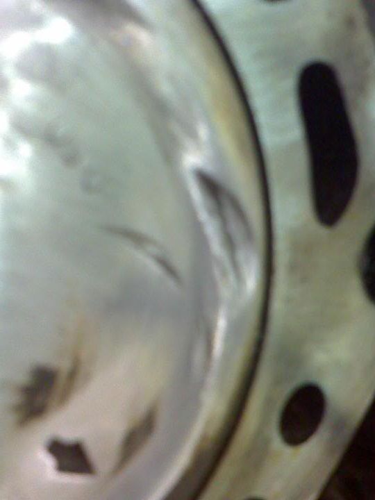

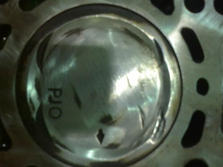

    you could have damage under the piston, as well as rod. I would pull that oil pan just to inspect that piston and rod and slap a new piston and all the rod bearings in it. Not a lot of money involved there and you have access to a lift so that wil be easy breezy.
    On the other hand you can fnd these motors in the JY with minor issues , mostly head gaskets blown.. for $100 so if you want to put this one together and spray it scatter it.. no big loss except what you are putting into it this month.

    i'm with everyone else in saying that the guides and piston might just be shot. that piston does have a clear mark where the valve bent in and kept tapping it. is the bowl all marked up from the edge of the valve banging it?
    it has a clear mark, but you can clearly see that it only hit 2-3 times, first time was the worst(where the grove for the valve is), a half inch or so it hit once/twice and kinda nicked it. I will be getting advice form someone who knows his shit..
    Tim I would go ahead and replace the piston. I know its not what you want to hear, but i would do it as a precautionary measure. You know Im cheap and if I cam upon a piston like that I would probably replace it.
    ugg...
    ^^^abosolutley, cheap insurance dude
    yea i would love to do that, but I have NO funds and my time on the lift has expired really. When i said i had 100, thats all i got, i cant even bum gas money from the rents, nor do i have a job, shit is hard right now. The shop is at my school and I'm really not supposed to be working on my car if im not making the shop money...
    fuck.. ill talk to someone tomorrow bout this..
    ugg...

    here are some simi better pics of the piston(cell phone)

    Doesnt look as bad as I though....just make absolute sure there is no part of the piston sticking up. Also you also know you might lose some compression on that cyl.
  16. #66
    Re: SUPER Day!
    ^^ yea its not THAT bad. I already took a ziz wheel/brillo pad to it , nothing is sticking up. And i dont mind losing compression, Im gonna just save up for a super sayon(lol DBZ) rebuild.
