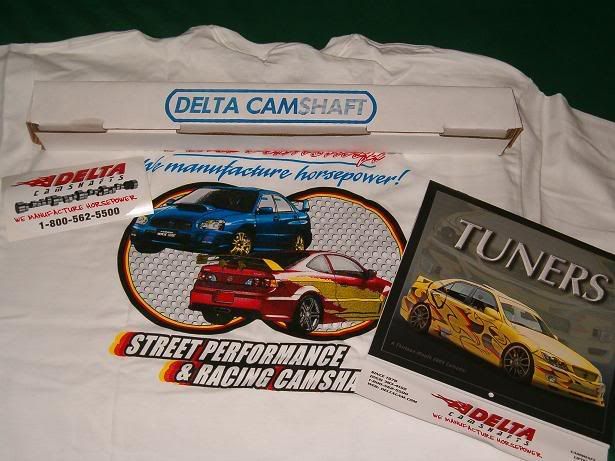

    SOoo i got a box in the main today after waiting like this for weeks. Just wanted to show everyone wut i got.
    272... the guys at delta are the shit. Gave me the shirt for free, and didnt even kno i was getting the calender or stickers.
    it was 82 and some change for all of it. lol I love them now.

    Nice man. I'm thinking of getting one of those after my next paycheck. Tell us what kinda of power gains you get with it after the install.

    looks good, was the shirt included if so

    shirt did come with it, scott(i think) threw it in fo free!!!
