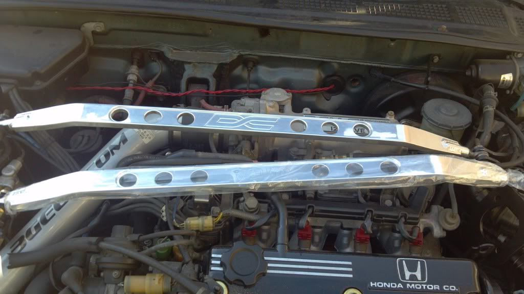

    Ok well here are the Pics as promised:
    So been searching and i mean searching every day! And finally found the strut bar that look like DC but i was wrong... Notice how everything is exactly the same so i was curious and bought it.
    So i did a match up and bingo lines up to the DC Sport Strut bar Perfectly!!!! i was shock and thought it would be shorter by a 1/4 or so.
    heres a pic of the line up:

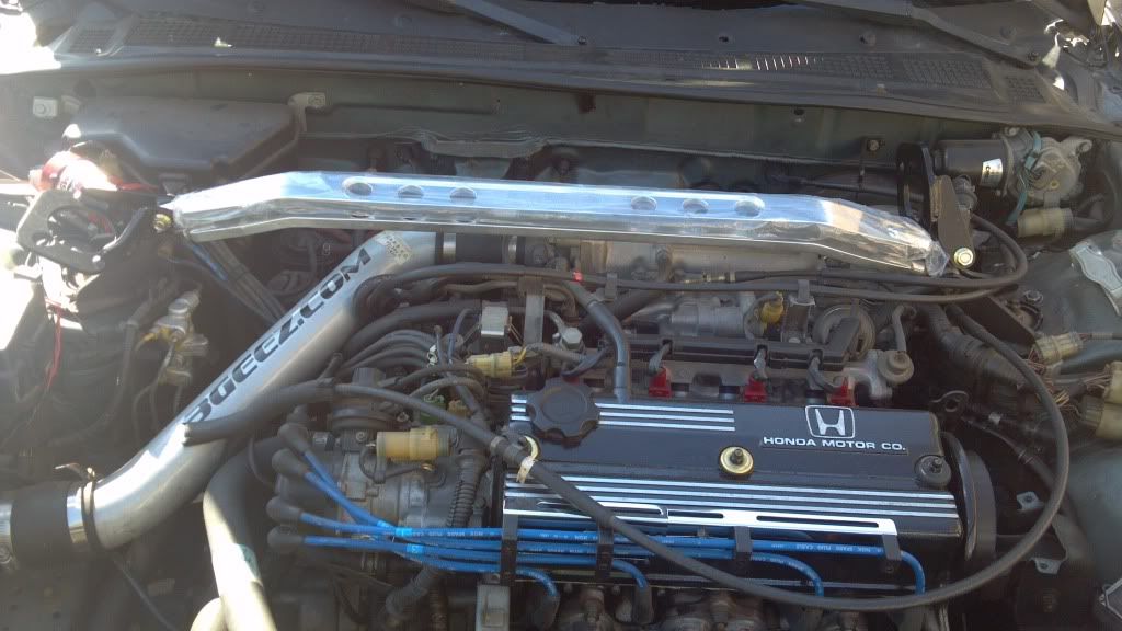

    Ok now to install this bar is really simple, you would need to make the mount where the bar bolts higher (Not doing this will not clear on the intake manifold If you have B series it will be the same.) and longer. Do a bit of cutting and drill new holes. Or you can make your own mounts from scratch to your liking.
    Now this work is not for beginners!!! This is for people that like to do Minor custom work on their parts so if you messed up thats all on you.

    umm instresting. I have a dc bar. looks the same besides the DC logo
    Yeah its a Revo Technica strut bar

    I crashed my coupe a few months back but I still have the car. I'm looking to buy another coupe or hatch or maybe a sedan, to revive my legendary sei but I can't seem to find a 2dr or hb for a good price in fl. Anyway... a front strut bar is 1 of the few mods I had left to do cause its got just about everything u can throw at it. So I'm down to buy 1 too. NOTE: I used a 90-93 accord rear strut bar for the rear and it fit like a glove with just a bit of bending of the brackets. And let me tell ya...it made a big difference. It keeps the rear planted on the road. But I also have the 16mm rear vigor sway bar and polyurathane end link bushings the rest of the rear bushings are rubber. So yeah I'm down to buy a bracket if its 20-30 dollars

    Quote Originally Posted by Sickest3G View Post
    Can you post a pic of your rear strut bar? we could add the info to help others that are also looking for Upper Struts bars
