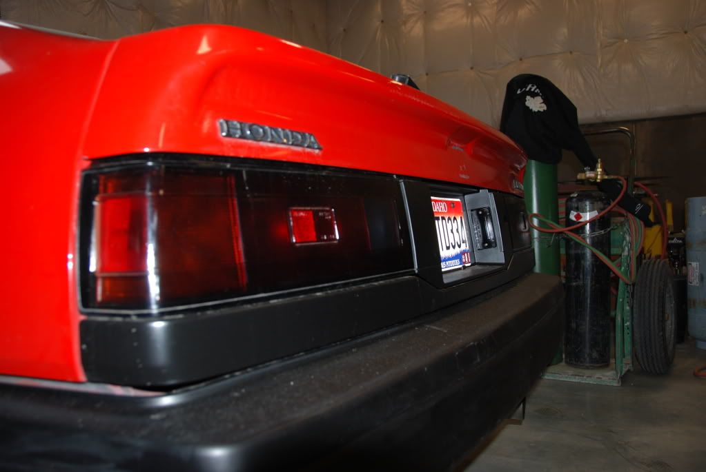

    My dad and I worked on installing some new goodies into my car, and fabbing up some stuff this weekend. Finally some interior pics of the hatch!!
    Got new my corbeaus installed, and my 4 point harnesses. Unfortunately I forgot to get a pic of the harness bar my dad made. You can see what my old seats looked like in one of the pics. Absolutely disgusting under the seat covers.

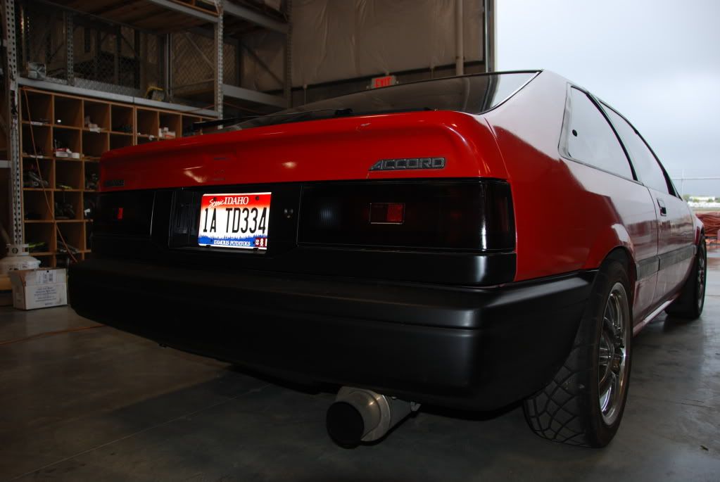

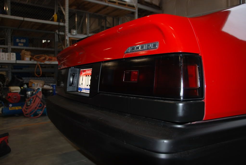

    Also tinted my tails earlier in the week, and I'm thinking about painted the hatch deck satin black to match the tails, and the piece right under the tails.

    Nice man, those seats are pretty bad ass. Hatch is looking good, did you spray the outside of the tails or inside? Looks like the outside. Your ready to go, cooler and all!

    yeah man. It was the outside. I'm gonna grab a can of satin clearcoat, and spray them with a few coats of that.
    Re: Alright guys. New pics of the hatchy.
    interesting look, black out lights and lower panel plus bumper... Looks good on your car

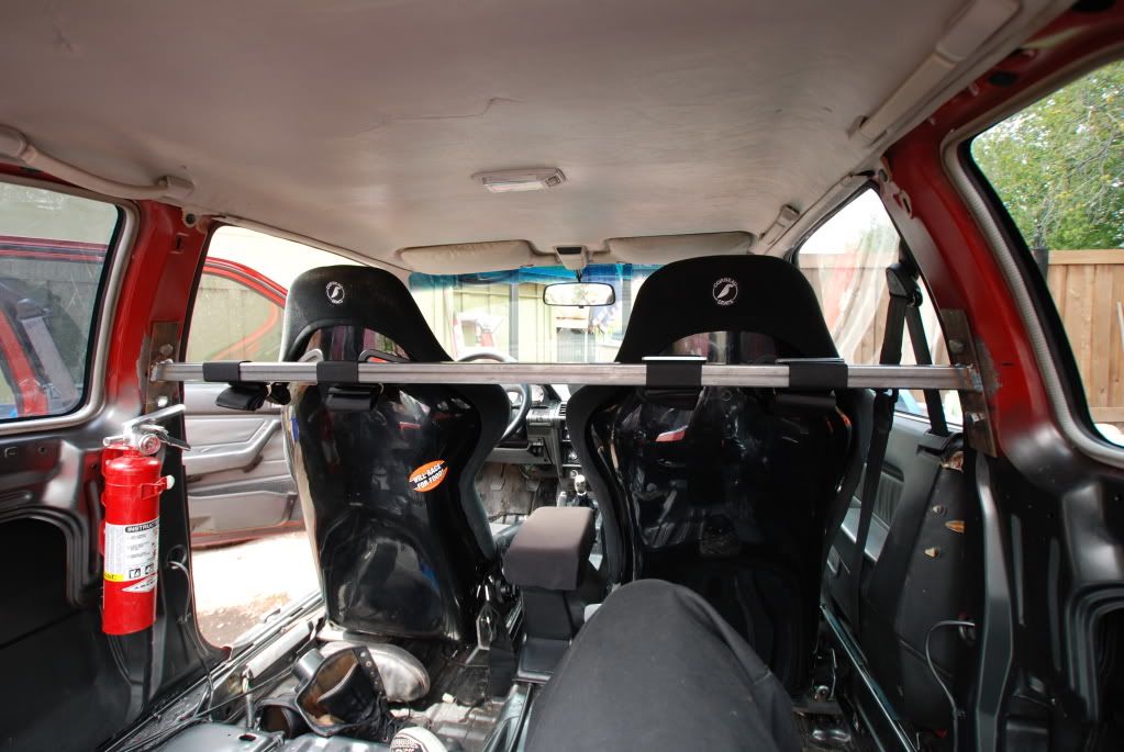

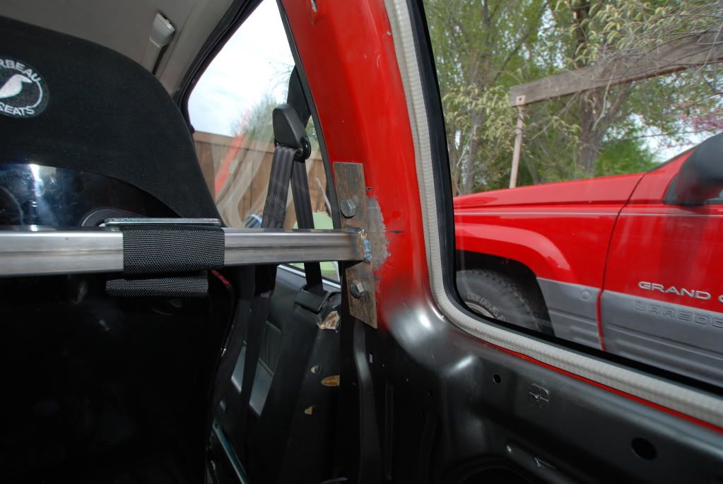

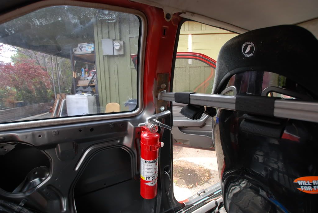

    Alrighty some closer pics of the harness bar, and an explanation on how it's mounted.
    You can't see any of this in the pics obviously, but there's a 1x4 inch square hole cut in the b-pillar. We then took a piece of 2x7x1/4 inch plate and welded two nuts onto it. The plate was then slid into the hole and tacked into place with the nuts facing toward the outside of the car. After that a 2x8x1/4" plate was bolted to the outside to get the measurements for how long the bar needed to be. The bar was then cut, and welded in place for the final step.
    The bar is so sturdy that I can literally hang from it, and nothing happens.
