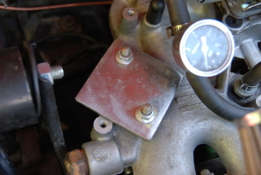

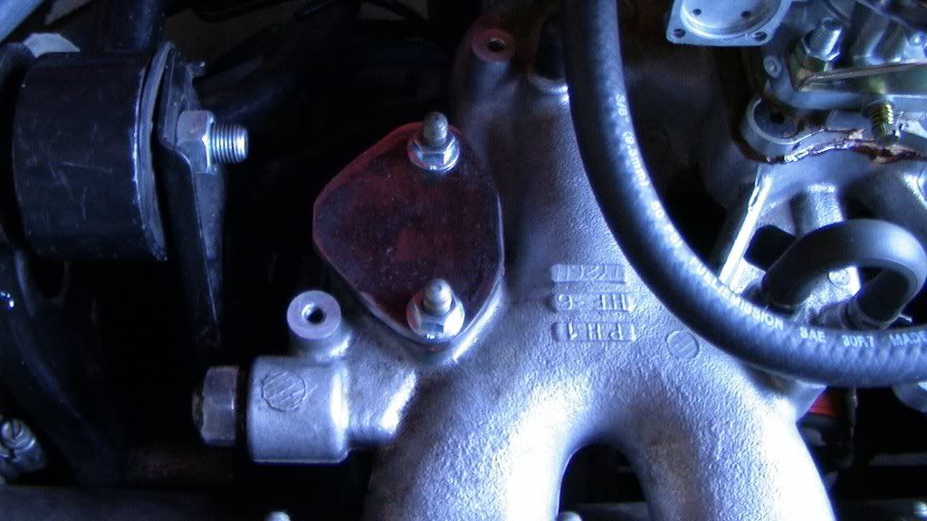

    Alright guys here's the pics of my egr block of plates.
    New one. Currently the one on my car.
    And the old one.
    I can make these in either style. Square or cut to generally match the opening. I did both of these with a grinder, and polished them afterwards so it's not exact machining or anything.
    There's some water/antifreeze spots on the plate in the first pic so it doesn't look as shiny as usual. I definitely need to wash my engine bay. Maybe that's what I'll do later today.
