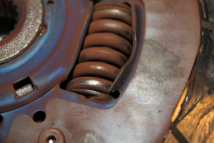

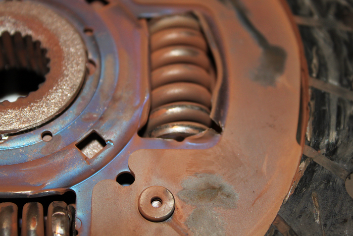

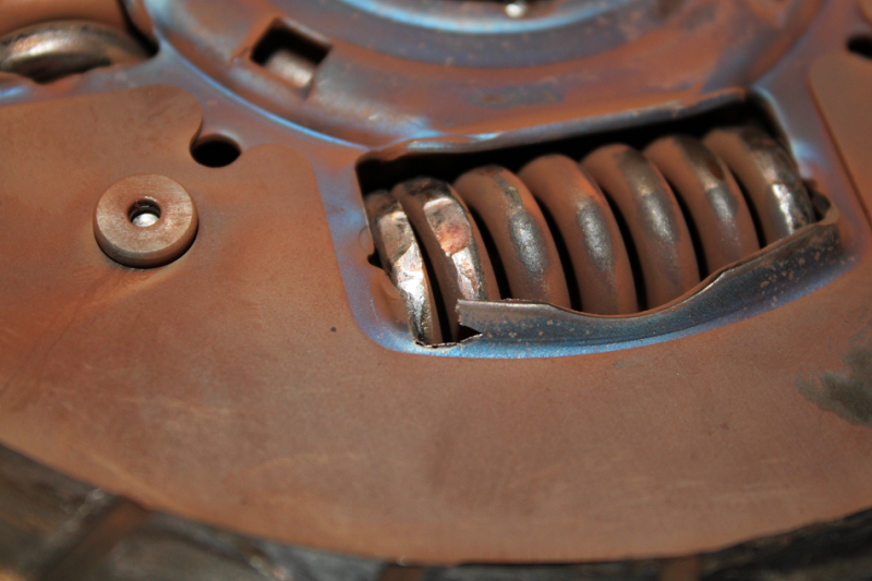

  15. #565

    so whats the clutch look like and what stage is it?

    Looks just like mine. And your tq wrench is here, just gotta come get it. *cough* Gas money *cough*
  17. #567
    Re: Tdurr's Turbo Thread!
    Stage treeee.
