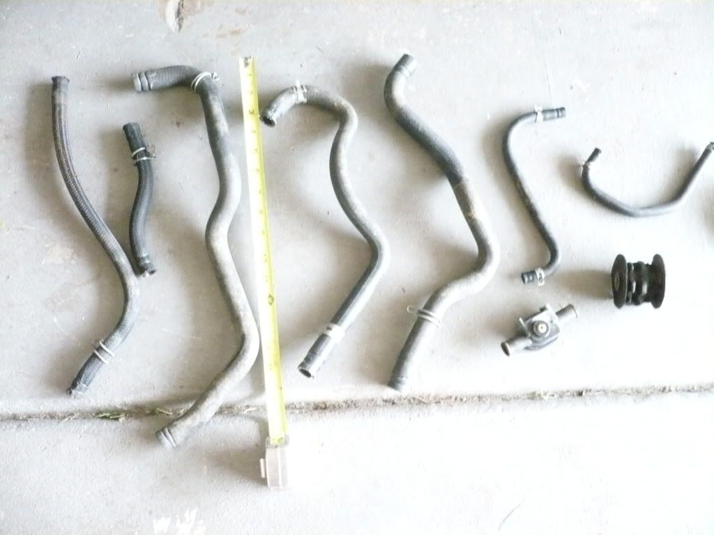

    Here is the batch of hoses that I replaced in my 89LX. Also 2 transmission cooler lines, the heater valve and I noticed that the front dog bone bushing was shot. I think that these are all the hoses except for the two bigger ones on the radiator. I replaced them two years ago along with the radiator. What a heck of a lot of sweat for such a small job. But now the coolant system is fresh and dependable except for the heater core....all the leaks seem to be gone. Hopefully the next job will be more fun. Thanks to all the previous posters for the help.

    Apparently the rotten dog-bone bushing that I replaced allowed engine slapping enough to break the exhaust somewhere. Probably in the first section. I read in an earlier post that this could happen. Back under the old 3g......

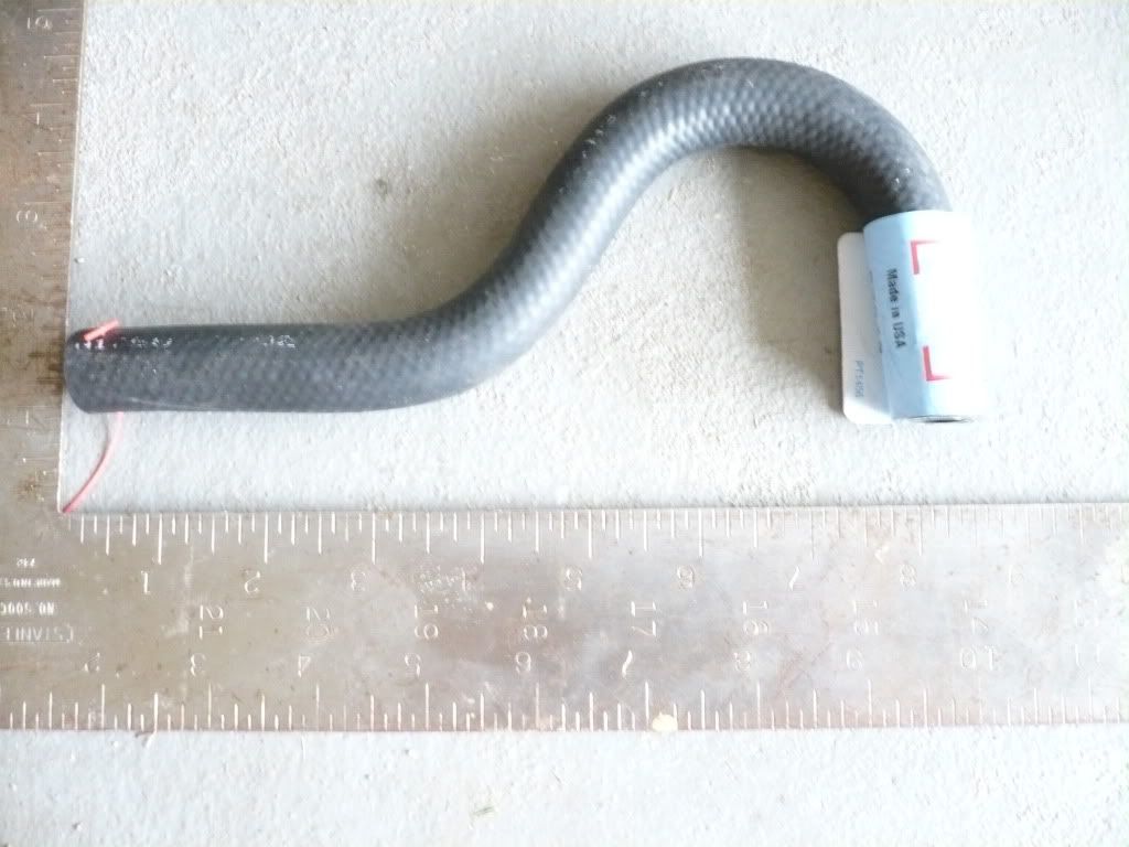

    Thats not all the hoses. You missed the worst hose of them all; the one running from behind the water pump to the intake manifold. Have to move the alternator, remove alternator bracket, water pump pulley, and snake your hand in there to get that bitch off the water pipe.
    conozo's Avatar
    Fort Wayne, Indiana
    1,165
    Re: Coollant hoses
    Its a P shaped hose about 8 inches in length

    Re: Coolant hoses
    Thank you both for the help. I was gonna send this back to rockauto tomorrow. Does it look like the last one? I have a new timing belt and water pump to install anyway, also have alternator brushes. Is it possible to remove the alternator on a 1989 carbureted LX without removing the axle?

    Re: Coollant hoses
    Your dog bone mount looks fine to me.

    Re: Coollant hoses
    Yes that is the hose.
