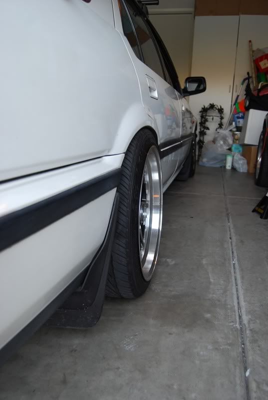

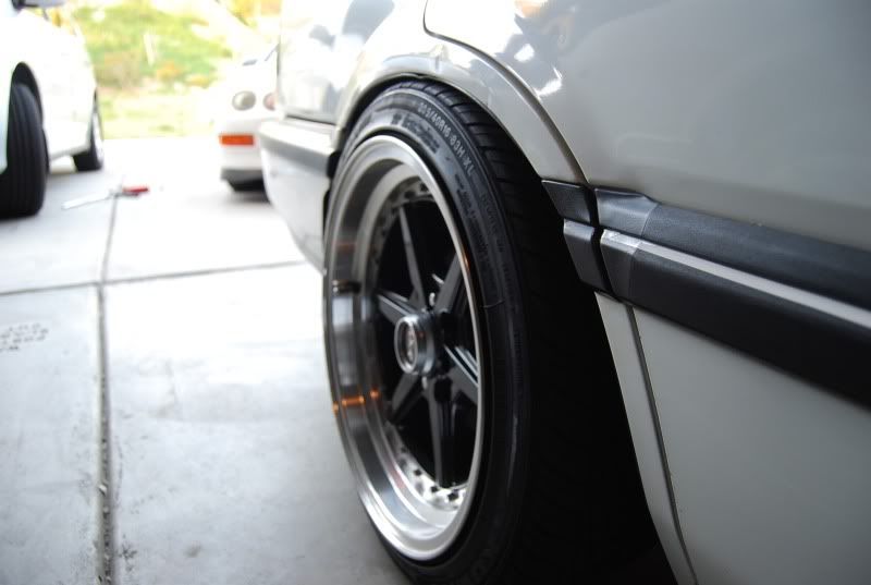

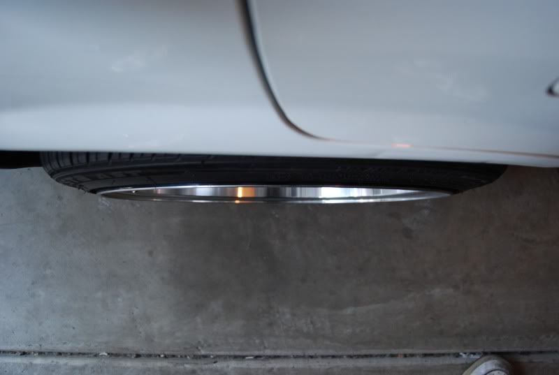

    Here are pics with the 16x8 +15 sportmax 501 my friend let me tried on.
    Plans now: Run camber, tuck tire, and probally run a +20
