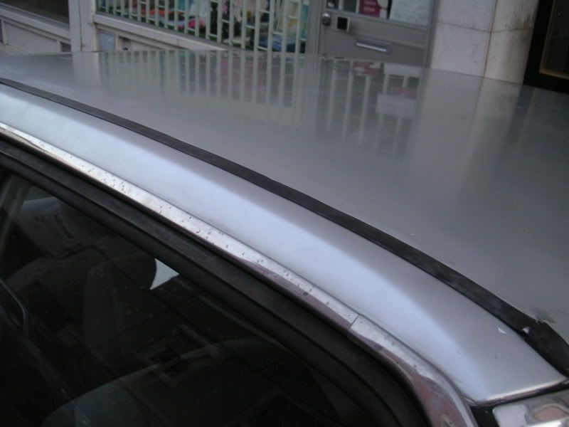

Have in mind that im new at this things, it is not perfect but without trying, experience cant be achived. Im doing my best
The job isnt finished, tomorrow is another day

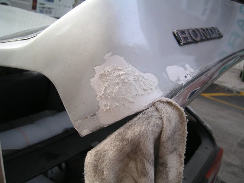

Cancer n1

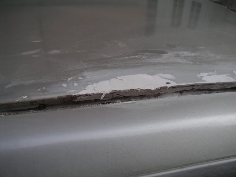

Cancer n2

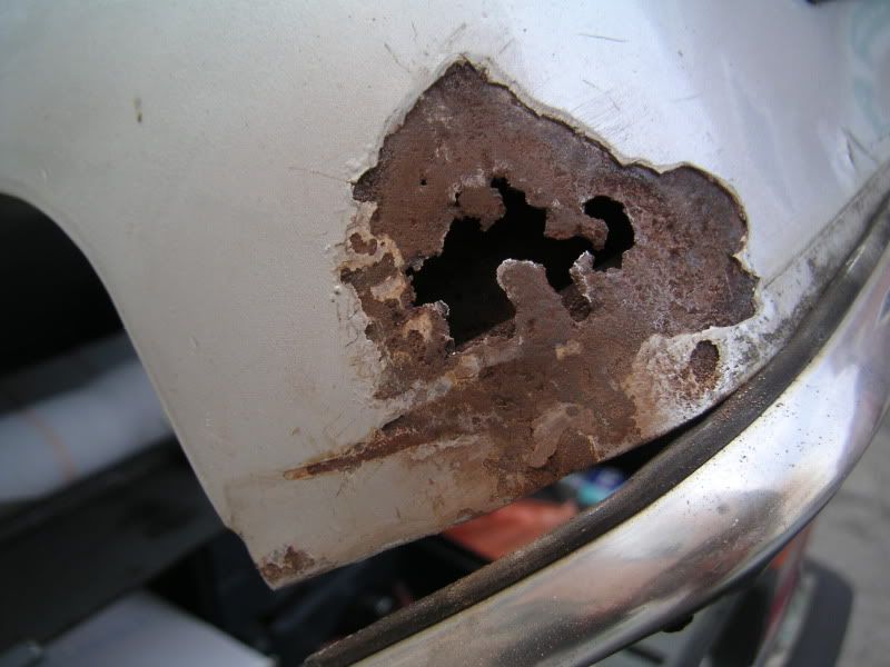

cancer n3

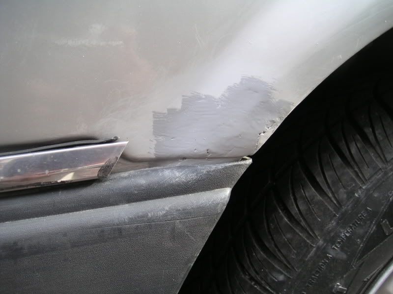

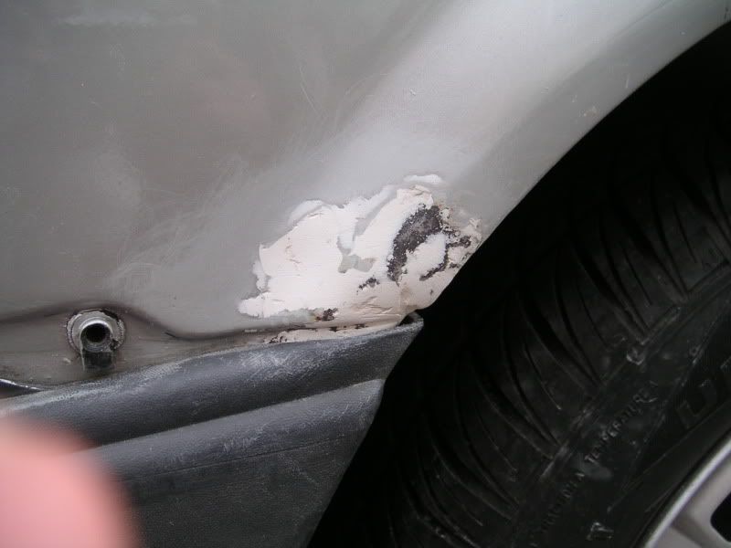

cancer n4 and 5
Cancer n1

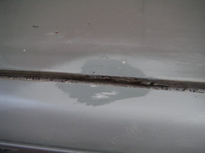

Cancer n2

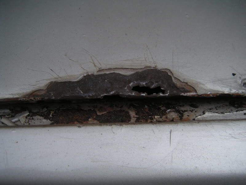

cancer n3
cancer n4 and 5
Does that stuff you laid down have any anti-corrosion properties to it? You might want to spray down some etch primer or something before you bog over it...
Cancer n1 is dead!
Good work! Looks like new!![]()

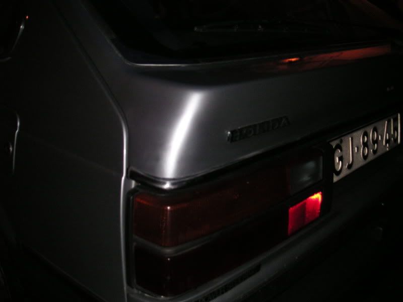

Today when i got back to the accord i didint like he results, so i do it all again, this time with better results.
Cancer n2 its done but i can do better.
4 and 5 are dead aswell

I have to worn you about your rust repairs.. I bout my car wit the same rust treatment un rear fenders and few other places, you know what? the rusting never stopped and it looks ugly now.. I recomend to do it properly with welding..

Wise words... the rust never really stops once it's there!
I'm needing to redo bits of my '82 once it's back on the road... needin to sort a couple of areas of paint where the shade is off so it'll get done then.
There's a few products made by Hammerite... one called Kurust that acts as a rust killer/barrier and the rust struggles to get through once applied; another is Hammerite No 1 Rust Beater and it's an all in one rust killer & primer. I fiberglassed a hole in my '85 EX rear quarter over 10 years ago, used this special paint & the rust round the repair has never come back through! The car is spares only now & is stored in damp conditions which is saying something.
You get good weather in Portugal so whatever repairs you do will last longer, so maybe do a more permanent repair next time... otherwise nice Hatch & photos!

As you guys said, the rain season started and its becoming rusted again
No surprises there, the areas getting rusted again are the ones i did not use fiber glass, i was an idiot. The others treated with the rust converter and with fibber glass are good and healthy.
