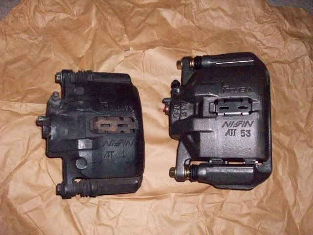

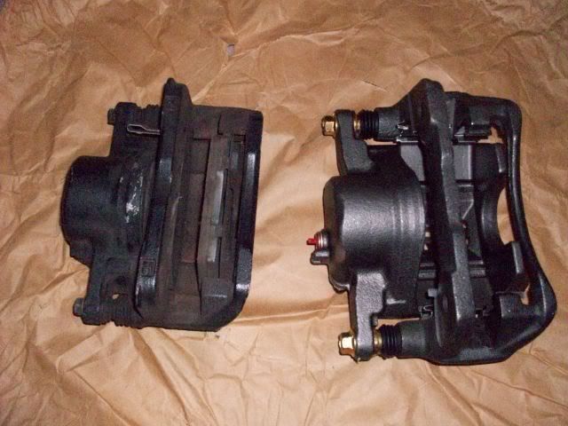

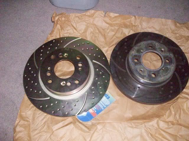

    here are the pics guys

    no...i bought them off this local speed shop for 130 bucks a pair and i paid a machine shop 25 bucks to redrill the hub...not bad for a bolt on upgrade

    Here is what they look like behind some 16's
