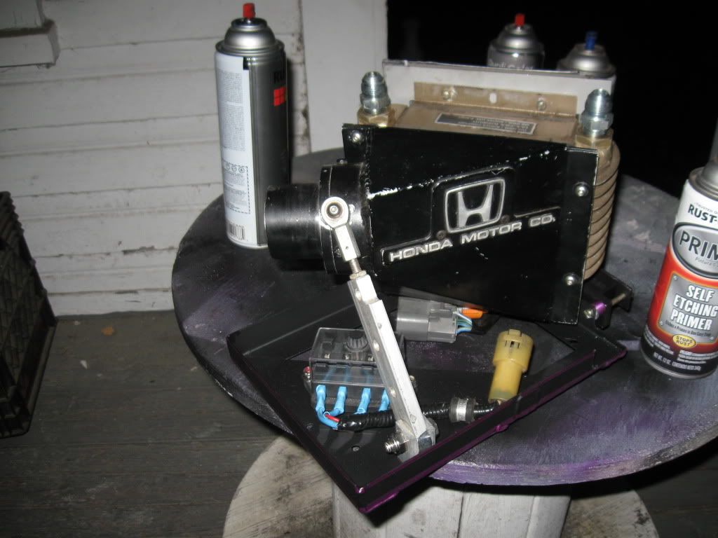

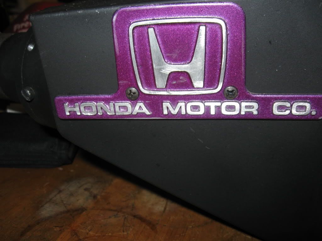

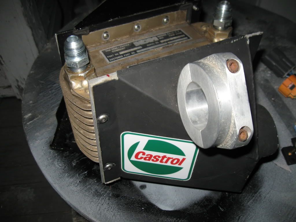

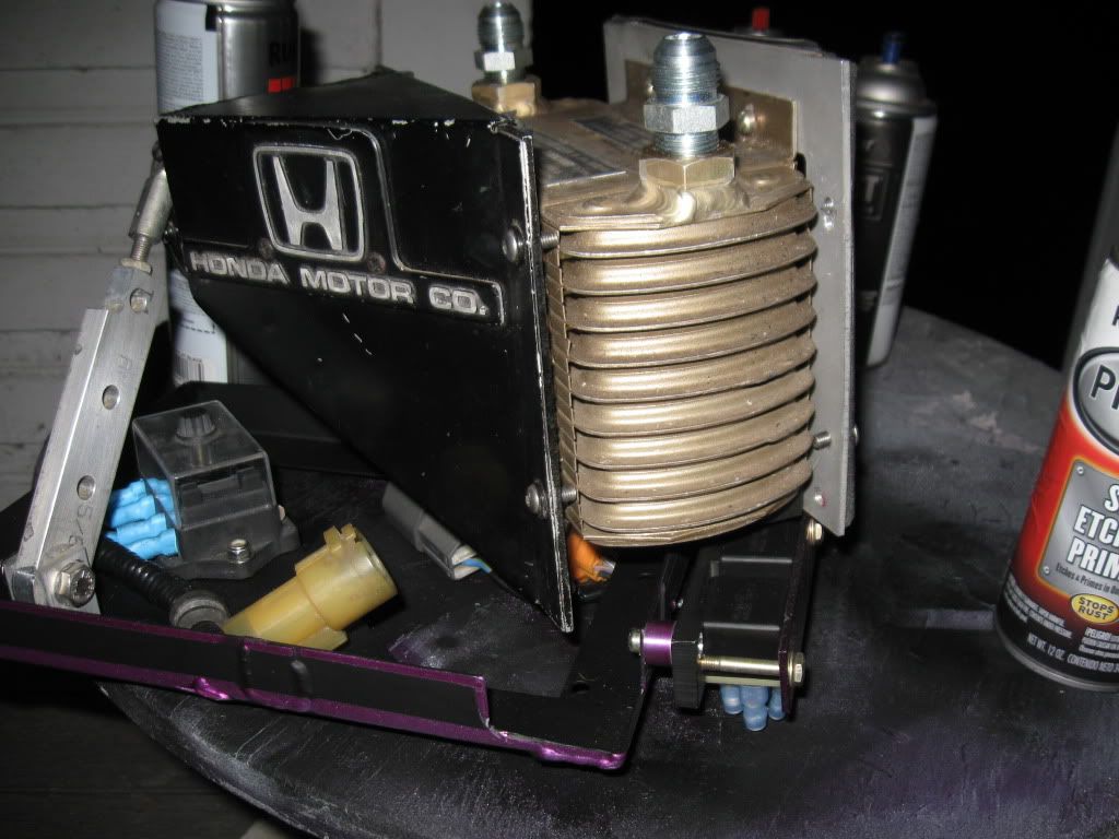

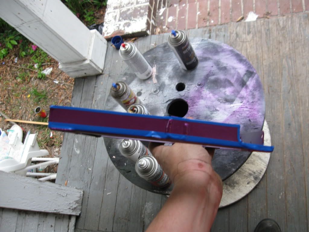

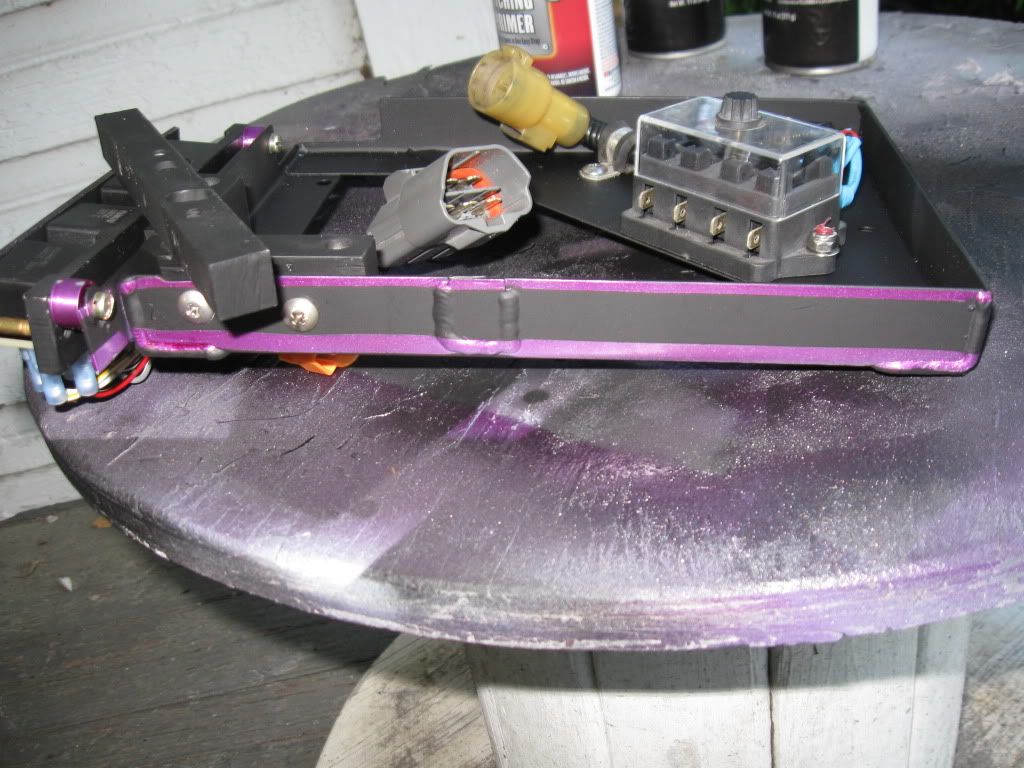

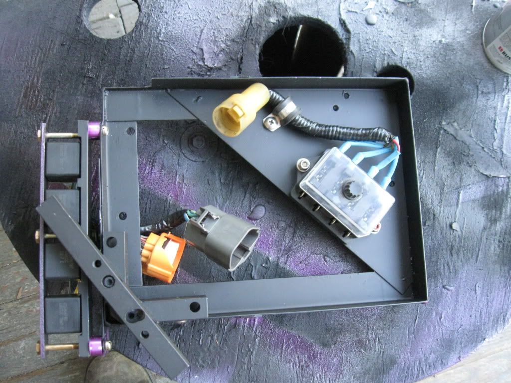

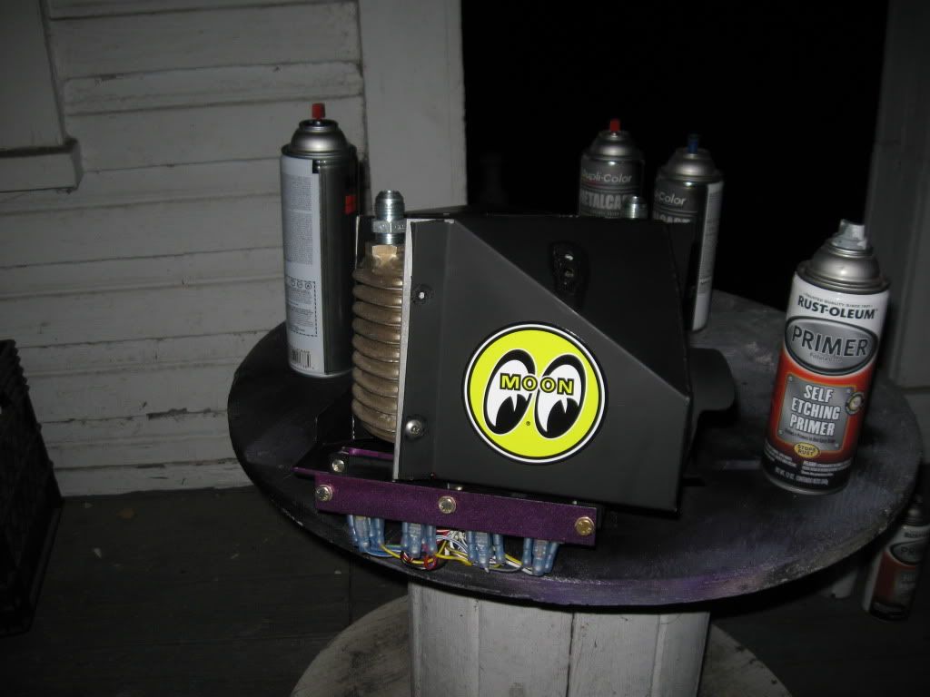

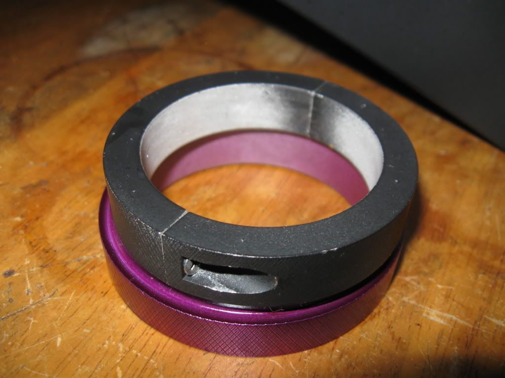

    I still have to paint the other half of the plenum, and the brace, but it's mostly done. I also have to paint the aluminum hose clamp and put stainless bolts in it.
    hose clamp

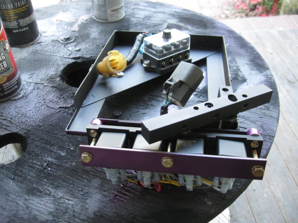

    bracket welded on to existing cooler tray, and spacers I had to add for the relays

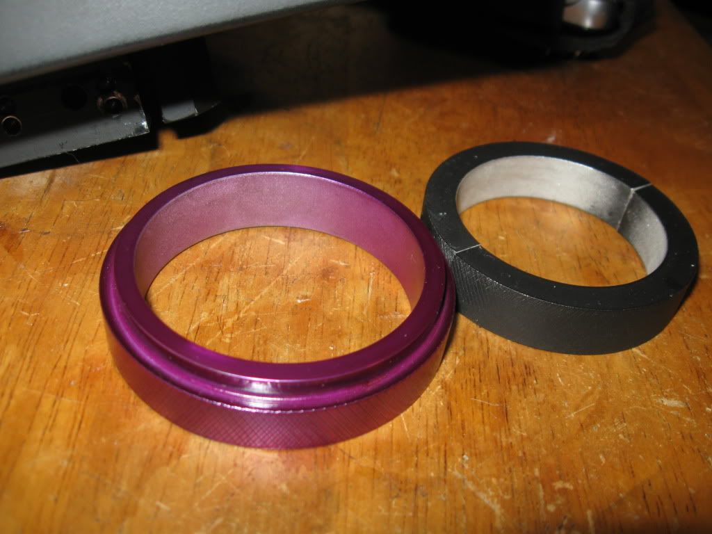

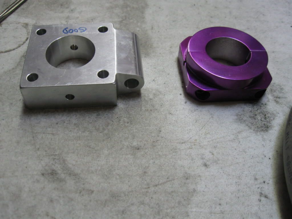

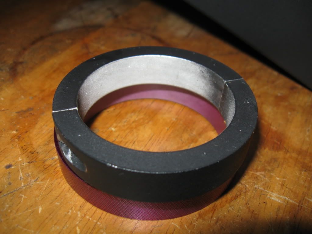

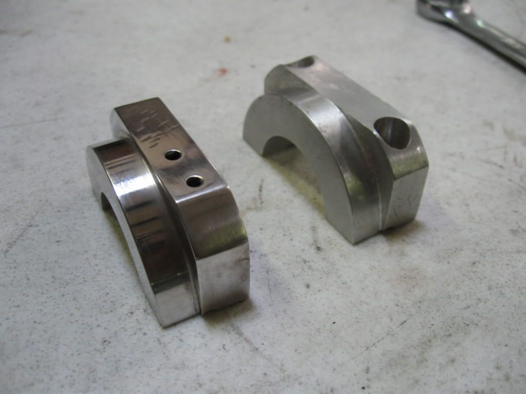

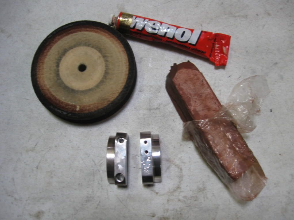

    I went ahead and polished up the hose bracket today,
    polished half, vs. unpolished half
    this is what that piece was originally made from, I can't remember how in the world i made this, it's been a while

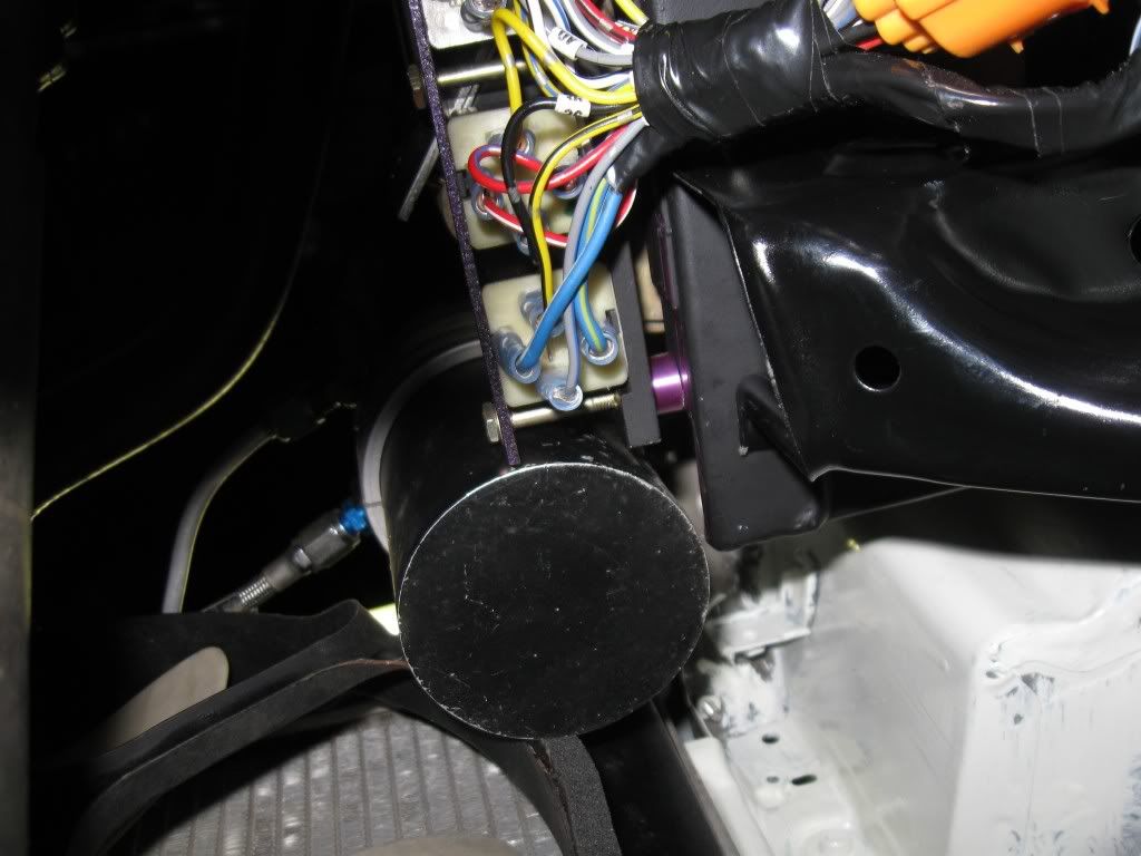

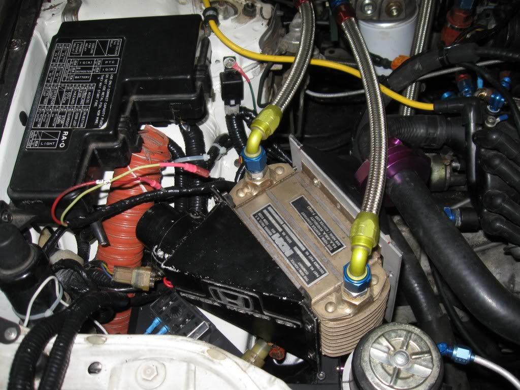

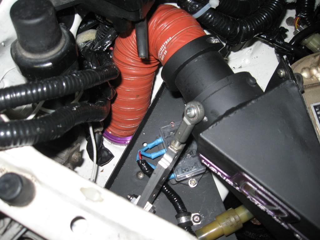

    I need to replace my air outlet hose for the cooler, but you get the idea, I still have some clearance issues with the overflow can, but thats eaisily fixed

    What are all the relays for?
    Re: A little paint, and a couple of new brackets for the oil cooler
    one is the oil cooler blower, one is for the fog lamps, one is for the driving lamps, and one overrides the driving lamp relay to allow the alarm to turn them on

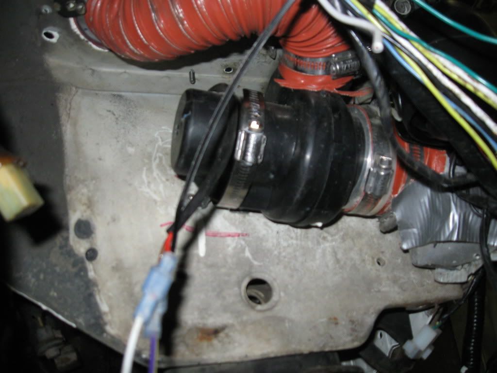

    I have it back in, I made an interesting piece out of stainless and aluminum to route the blower line through the hole in the fender, once it's in I will take some pictures, these parts are now installed permanently and don't need to come back out again

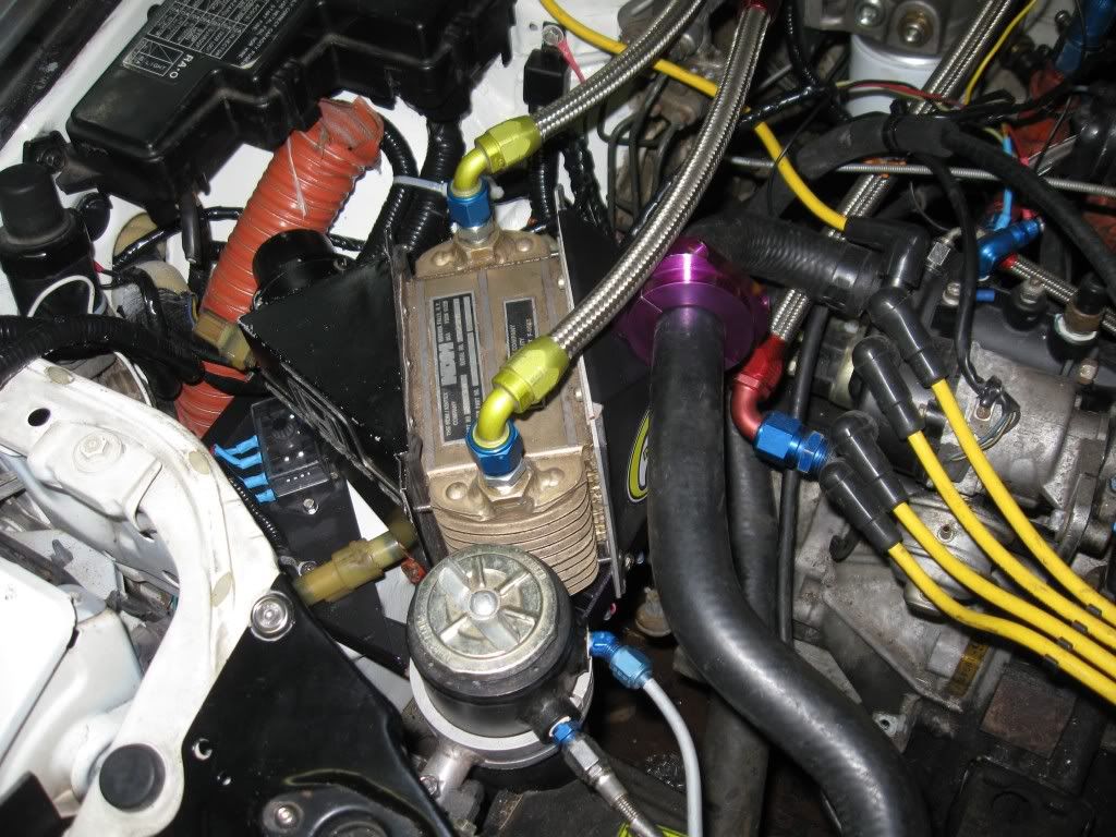

    I finally got the oil cooler back in, and finished, even though I have to remove it yet again for wiring

    Good job on getting it working, do you not think a passive cooler would of done the equivalent?

    there is really no where to put it, also when the oil is hottest is sitting in traffic in 100 degree heat, where there is no airflow to a passive cooler, this is all thermostatically controlled, there is an oil thermostat and a temperature switch for the fan. all those wires will be sorted this weekend, I need the alternator to be mounted before I can finish those harnesses.

    most people run a remote filter base and remote filter, then the lines get plumbed from that, I have seen sandwich adapters that retain the factory filter location, you need an inline thermostat to maintain proper oil temp, it has to stay around 200 degrees to boil off moisture, the thermostat allows oil to the cooler after that temp is exceeded. I'm using a miloden, you don't want a cheap one, it allows oil to always be in the cooler, but the passage between the halves of the thermostat stays open under 200 degrees, this prevents air pockets and pressure drop, when it's open, oil will bypass the cooler, since the path through the thermostat provides less resistance. once the valve closes, oil will start to flow through the cooler. The remote filter is still best though, I'm running an oversize filter, this allows the oil capacity of the engine to be increased without pan modifications, more oil means the oil will last longer and it's not working as hard, plus it stays cooler, I've probably picked up an extra 1 1/2 quarts

    you must be running an oil temp gauge, I would like to see what those are too, I had one temporarily mounted for a while, and in the summer here, the oil temp would exceed 200 degrees in traffic. with the modifications to the engine, it's going to be running hotter then stock, so this should help. if you generate horsepower, you also generate heat in the creation of that horsepower, Another thing that will help. is that Ac condenser is no longer in front of the radiator, so more airflow to it
