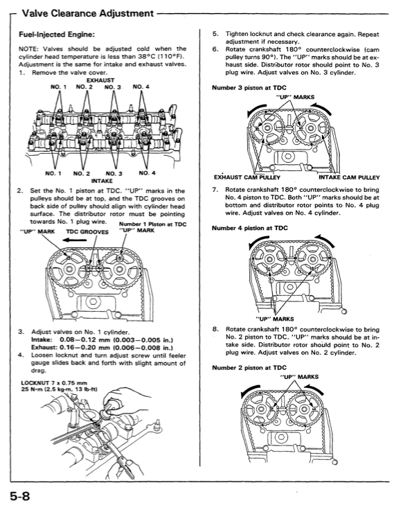

Does anybody know any tricks to getting the feeler gauge between the rocker and the top of the valve? I tried the smallest feelers possible, and can't get the damn thing in there. I even adjusted the rockers loose and still can't get the feelers in there.
Is it possible that the valve has just worn into the rocker so that there's a divot in it, and it's sunken down over the valve? Or am i just crazy?
I've adjusted valves on K-series, ES, A-series and D series motors without any problem... So I sorta know what I'm doing...
