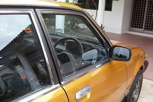

    I hated the aftermarket ones on the car. The view sucks, vibrates like hell at high speed, and look like shit. One of the mirrors cracked so I thought, why not fit something from another car? I really want the USDM door skin mounted mirrors, but I doubt I could get my hands on one. And I'm not a fan of JDM fender mounted mirrors.
    I've been looking and experimenting different mirrors and I find that my dad's Nissan AD Resort mirrors ( I have no idea what it is called in Japan) which is essentially a wagon Sentra, I really like the shape of it. Its not too big or too small. I stole one of them and test fitted it to the Accord. I wish I could keep it Honda but there none of them look as nice as this. The one posted here with 3g mirrors don't look right. The mirrors seems too big and don't fit the car at all.
    Anyway, heres some pics:
    The black trim need some work, nothing some fiberglassing work can't help.
    Looks like its made for the Accord!
    The base need some work. Not too hard I think. I could make that fit with proper brackets and stuffs.
    So I'm off to the JY to find a set, preferably with power folding ones, or any other mirrors that might look okay (and cheap). Else the Nissan ones work just nice and I don't mind with it not being powered. How many times you actually adjust them lol
    Any thoughts?

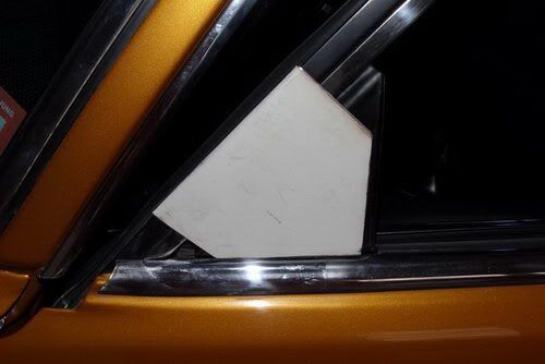

    Template for the bracket made from cardboard.
    Cut on a piece of scrap metal I had lying around.

    Fitted the bracket
    Almost there!
    Went for a test drive (can't resist!) I can't believe how great the view is! And most important of all, no more ghey vibrations!!
    I need to figure out how to properly secure the bracket. Right now its jammed under the window seal, just like the old mirrors.
    Now all that left is to do the left side, wiring, fiberglass work and paint.

    Damn dude looking good. I like your "scrap metal" being an old computer case, lmao! Your factory mirrors were jammed into the window seal too? I figured there would be a little triangle bracket there like on the 2gee, where there is no window. Looks great through! Loving it. I almost think they look great black. Are you gonna paint that middle section to match the car?
    Re: Side mirror retrofit adventure
    Factory mirror is mounted on the door skin, just like the USDM ones. The aftermarket is the one that is jammed into the window seal. It seem to work just fine after all these years so I figure out they shouldn't be a problem securing these mirrors, although its tiny bit heavier with all the motors and stuffs.
    There are no other way to mount the mirrors since there are no triangles bracket thing unless I fit the one that is mounted on the door skin. I was looking at the powered ones from newer cars, but they are huge, and EXPENSIVE lol.
    I'm going to fabricate better bracket with heavier gauge steel later as this one is rather flimsy. What do you expect from a cheap ass computer case?
