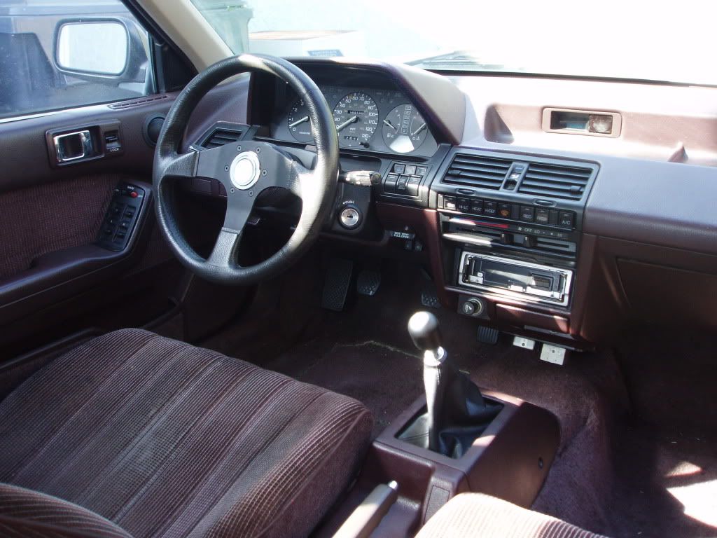

    Ebay. It doesn't quite fit.

    I used a Tekniq hub -part# 524.279.2
    It said it was for 88/89 accords with cruise control, but I still had to modify it a little. I had to grind down the inside of the lip because it fit so snug you could barely turn the wheel. I also had to drill the two holes larger for the alignment dowels for the plastic part that rotates for the horn.

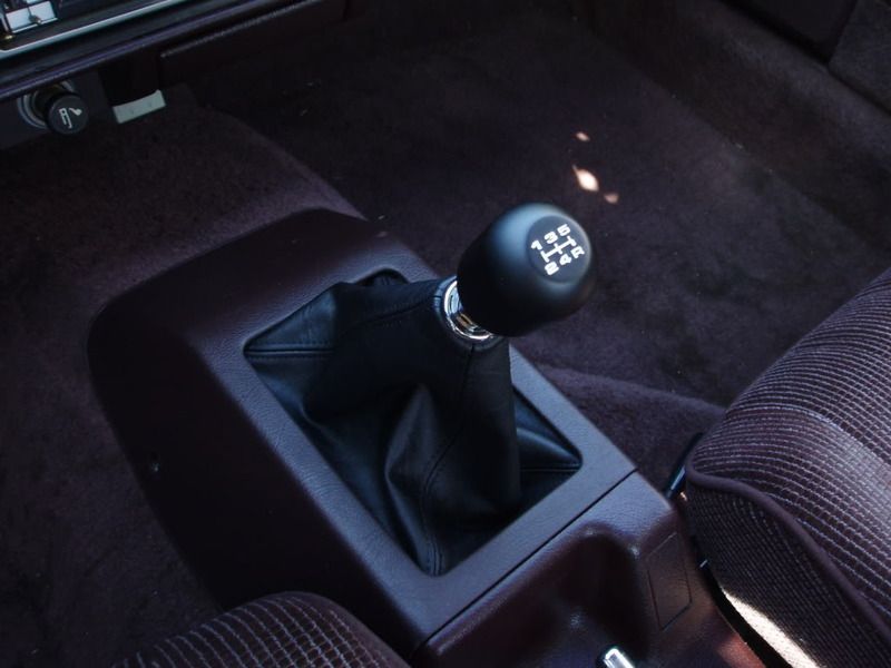

    i like it, very clean and simple, where did you pick up that knob?

    http://cgi.ebay.com/ebaymotors/88-91...#ht_5566wt_940
    I used an oem 2g accord shift boot to go with it. It's an exact fit for our console, unlike the civic ones which are a bit narrower.

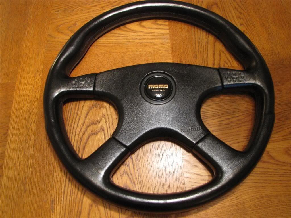

    I actually wanted one of these, but they're impossible to find:

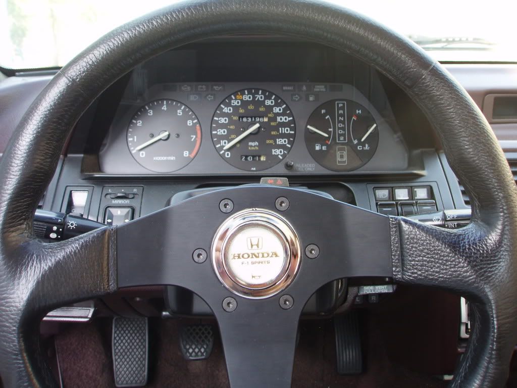

    What kind of steering wheel is that I like it!

    It's a Personal and the model is Blitz. 350mm.
    I like how the 3 and 9 o'clock spokes sort of droop, so my hands are close to the same hieght that they were on the stock wheel.
