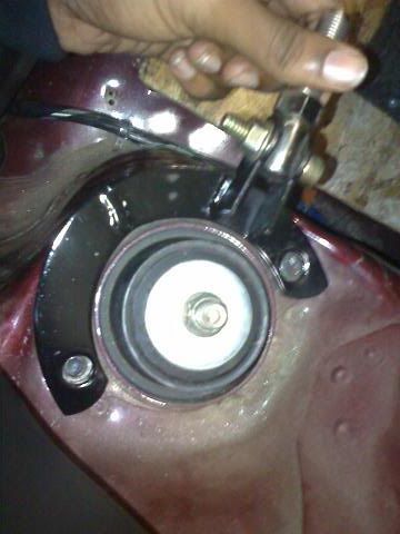

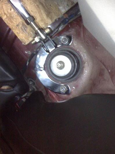

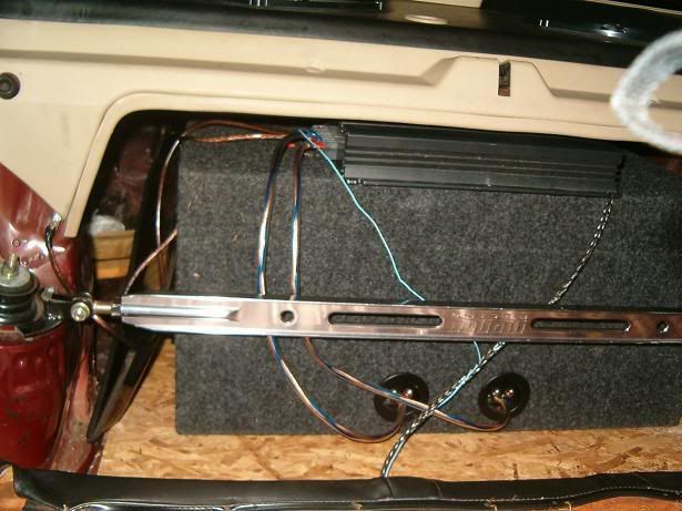

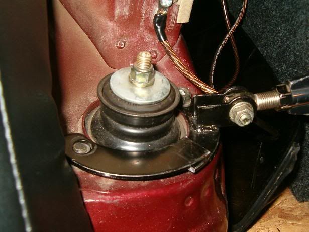

    4th gen accord bar works for the rear with some cutting and welding. Need to move the hold like a inch closer and a few degrees inwards.
    but i bolted mine up for a few days with only one hole attached and even then it made a difference.
    I was looking for this post, forgot it was yours. Good stuff.
